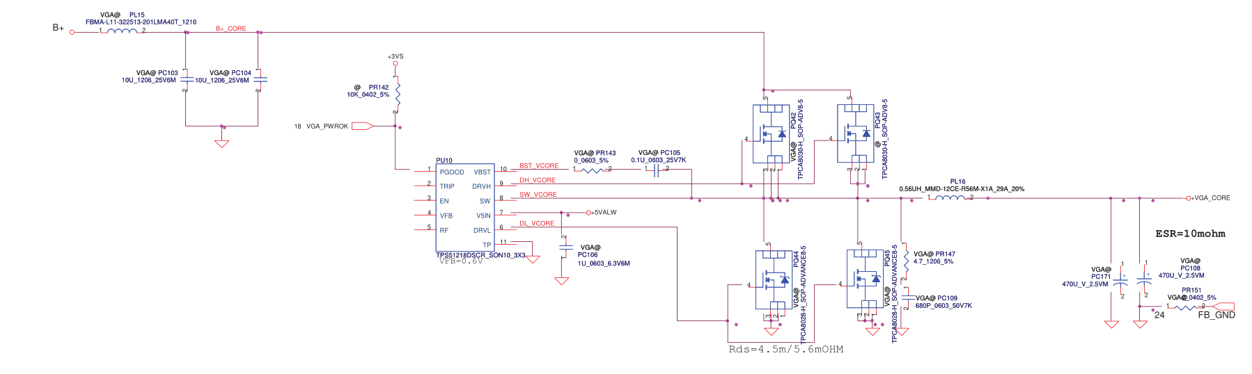

    Hello, I have an Packard Bell Easy Note TS13HR-197GE with motherboard LA-6901P that is shorted at +VGA_CORE and because of this the laptop turns on for a fracture of a second and than turns off.

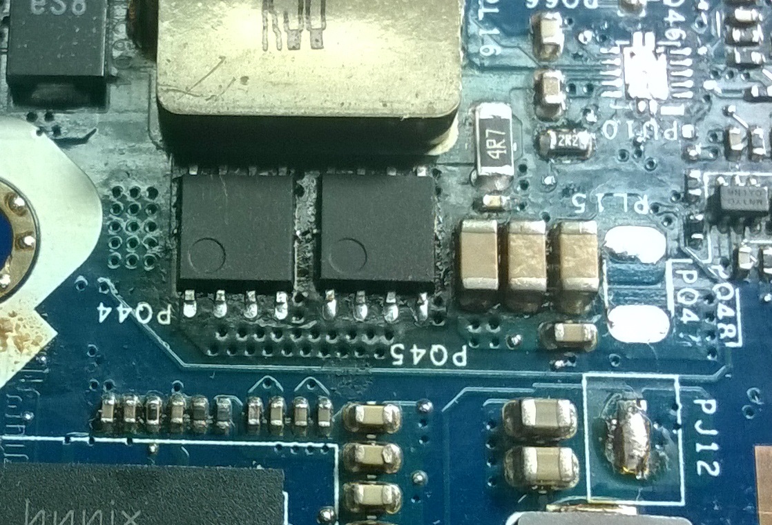

    Now, I am pretty sure that its the GPU chip that is shorted because I removed some components I suspected , such as PQ44 and PQ45 , and they check out OK, so I removed also the controller PU10. But now, all of a sudden, B+ is shorted to ground as well, and laptop adapter goes into fail safe mode where it shuts it self off.
    After removing PL15 that connects B+ to +VGA_CORE the laptop started normally and even displayed picture (intel HD graphics).
    What I am wondering is, why is B+ connected to +VGA_CORE via PQ42 and PQ43? What is the point of this? And is it possible that these transistors failure caused N13P-GL2-A1 to die?
    (The scheme is edited, most lines are erased take a look at the pdf scheme provided)

        Please post picture of PQ44/PQ45 area if there's anything looking funny.
        This circuit (with the most important parts: the controller PU10, the set of 4 switching MOSFETs, the coil PL16 and the output caps PC171/PC108) is a DC to DC converter, in the synchronous buck topology. You can read more on the internet about this but basically it converts a higher voltage line (B+ at 19V) to a lower voltage line (+VGA_CORE at ~0.9V) with a high output current capability.

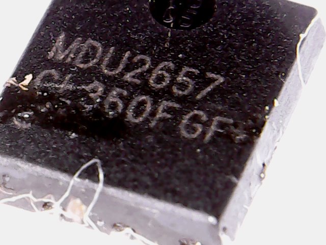

          PQ42 has blown and is the culprit of the situation. It is an MagnaChip MDU2657.
          I will have to replace it including the graphics chip. i just hope all the 2.5V caps did not die from this.
          Any one know of any common alternatives to MDU2657?

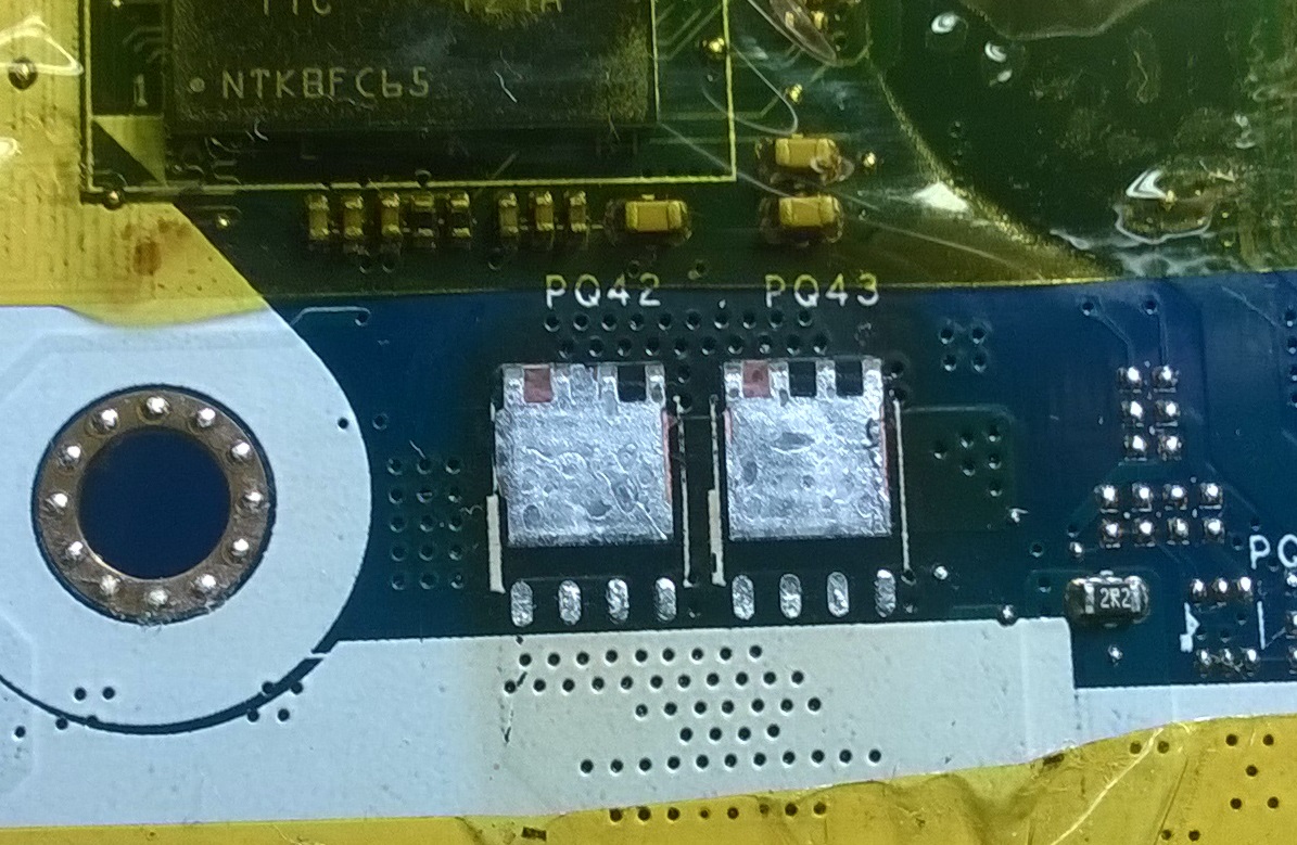

            Ok so PQ42 measures 12 ohm (between source and drain I guess) out of circuit? You should replace it with exactly the same part. If you cannot find it, find a N-channel MOSFET with very similar Vds, Id, Rdson characteristics, and replace both PQ42/PQ43 with it. I've got some 4921N which may be suitable, not sure.
            Now resistance between +VGA_CORE and ground?
            On your picture it looks like discoloration due to heat.
