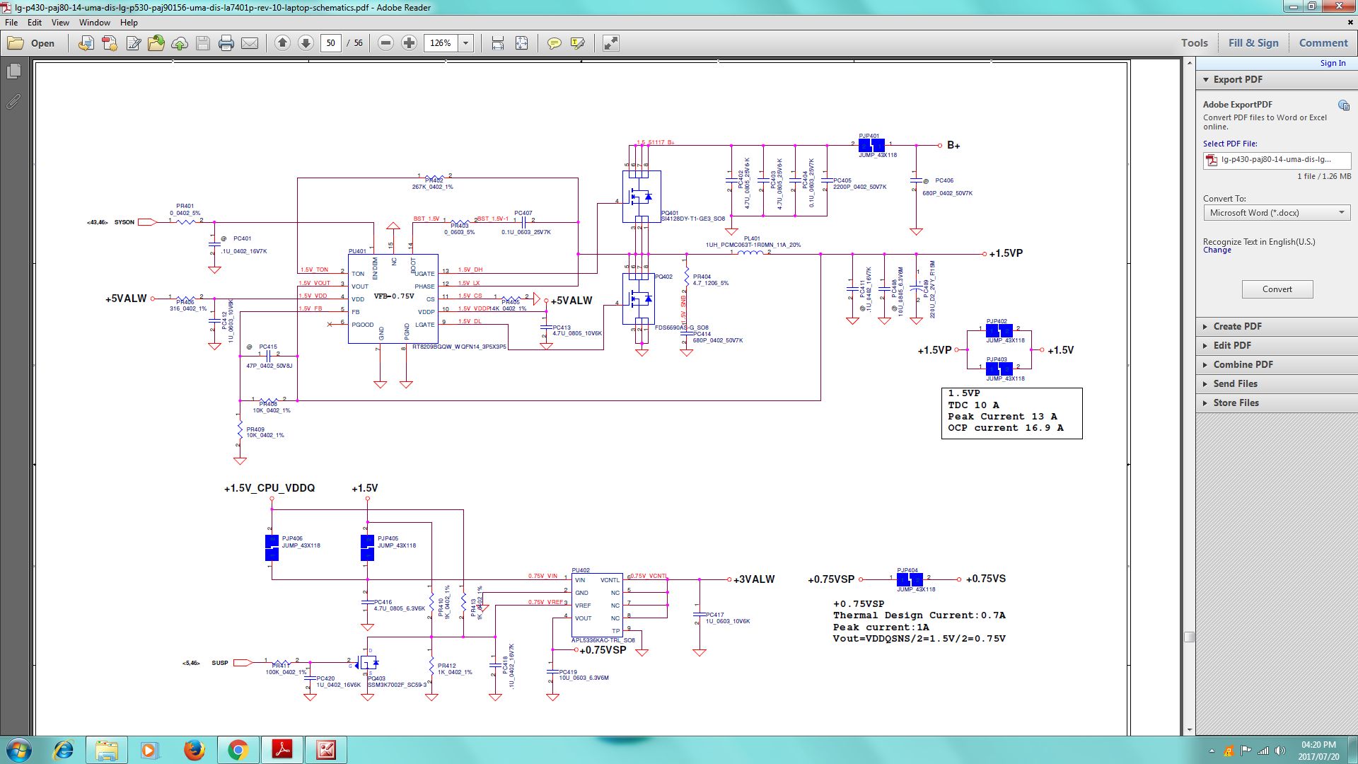

LA7401P Short to ground
  • alfasys
    • Apr 2017
    • 32
    • South Africa
    LA7401P Short to ground
    Hi there.
    I have a LG laptop that was completely off. I open and check on the board, there was 2 burnt mosfets (PQ401 and PQ402). I removed them from the board and tried to plug the laptop, the laptop switches on and goes off after a few seconds. Now I replaced both mosfets, the laptop don't switch on and PQ401 is overheating(very hot). Where can I test and how can I resolve this issue? Any help is much appreciated. I have attached the schematics and a pic of the affected area.
    Last edited by alfasys; 07-20-2017, 09:04 AM.
  • caspian
    • Oct 2015
    • 1591
    • Laptop
    Re: LA7401P Short to ground
    measure resistance to GND on all pins of PQ402.
    • alfasys
      • Apr 2017
      • 32
      • South Africa
      Re: LA7401P Short to ground
      Must I put back PQ402 on the board? because I removed both pq401 and pq402
      • caspian
        • Oct 2015
        • 1591
        • Laptop
        Re: LA7401P Short to ground
        now that you removed them, just measure resistance on the empty pads of the two transistors on the board.
        Last edited by caspian; 07-20-2017, 11:50 AM.
        • alfasys
          • Apr 2017
          • 32
          • South Africa
          Re: LA7401P Short to ground
          ok.
          pq401
          pin 1 to 3 = 391 ohm
          pin 4 = displays 1700 ohm then meter goes to 1
          pin6 to 8 = displays 1700 ohm then meter goes to 1
          pq402
          pin 1 to 3 = 008ohm
          pin 4 = 1415 ohm
          pin6 to 8 =225 ohm
          ps: I put the negative prove on the ground and the positive probe on pins to test. is that okay?
          • caspian
            • Oct 2015
            • 1591
            • Laptop
            Re: LA7401P Short to ground
            it is ok.
            now measure voltage on pin4 of pu401 before pressing the power button.
            then measure voltage on pin1 of pu401 after pressing the power button.
            • alfasys
              • Apr 2017
              • 32
              • South Africa
              Re: LA7401P Short to ground
              pin4 of pu401 = 4.38V before pressing the button and pressing the button it stays the same, 4.38V.
              • caspian
                • Oct 2015
                • 1591
                • Laptop
                Re: LA7401P Short to ground
                what about pin1 of pu401?
                • alfasys
                  • Apr 2017
                  • 32
                  • South Africa
                  Re: LA7401P Short to ground
                  Hi there
                  Pq401 Voltage:
                  pin 1 to 3 = 0.02v
                  pin 4 = 4.39 v
                  pin 5 to 8= 18.99v
                  Pq402 Voltage:
                  pin 1 to 3 = 0.0
                  pin 4 = 0v
                  pin 5 to 8 = 0.02
                  ps: both Mosfets are off the board. I am only testing the pads.
                  thank you for your assistance
                  • caspian
                    • Oct 2015
                    • 1591
                    • Laptop
                    Re: LA7401P Short to ground
                    pin1 of pu401 is important.
                    • alfasys
                      • Apr 2017
                      • 32
                      • South Africa
                      Re: LA7401P Short to ground
                      what do you suggest?
                      • alfasys
                        • Apr 2017
                        • 32
                        • South Africa
                        Re: LA7401P Short to ground
                        PU401 pin 1 = 0.1v
                        • caspian
                          • Oct 2015
                          • 1591
                          • Laptop
                          Re: LA7401P Short to ground
                          you must measure this pin less than 1 second after pressing the power button.
                          • alfasys
                            • Apr 2017
                            • 32
                            • South Africa
                            Re: LA7401P Short to ground
                            Cool, PU401, pin 1
                            before pressing the button= 0.01
                            After pressing the button = 0.03
                            what does this mean?
                            • caspian
                              • Oct 2015
                              • 1591
                              • Laptop
                              Re: LA7401P Short to ground
                              it means the laptop has also got another problem on some power rail.
                              • alfasys
                                • Apr 2017
                                • 32
                                • South Africa
                                Re: LA7401P Short to ground
                                5V alw and 3V alw are present before pressing the button, what other power rail can I check?
                                • alfasys
                                  • Apr 2017
                                  • 32
                                  • South Africa
                                  Re: LA7401P Short to ground
                                  Could you please quickly explain to me how this 1.5 circuit works (Pq401, Pq402 and the PU401 that controls the mosfet?
                                  • caspian
                                    • Oct 2015
                                    • 1591
                                    • Laptop
                                    Re: LA7401P Short to ground
                                    I think the problem is somewhere else on the board.
                                    now you have to check voltage on the following pins of KB930 after turning on:
                                    26, 65, 76, 95, 100-to-117, 121, 125.
                                    • alfasys
                                      • Apr 2017
                                      • 32
                                      • South Africa
                                      Re: LA7401P Short to ground
                                      Hi Caspian. I tried to remove the inductor, PL401 these are the measurement I got:
                                      PQ401
                                      pin 1 to 3 = 1.70v (before pressing the button) 3.56v (after pressing the button)
                                      pin 4 = 4.26v (Before and after pressing the buttonn)
                                      pin 5 to 8= 18.7v
                                      PQ402
                                      pin 1 to 3 = 0.01v (before pressing the button) 0.03v (after pressing the button)
                                      pin 4 = 0.03v (Before and after pressing the buttonn)
                                      pin 5 to 8 = 1.70v (before pressing the button) 3.56v (after pressing the button)
                                      • alfasys
                                        • Apr 2017
                                        • 32
                                        • South Africa
                                        Re: LA7401P Short to ground
                                        So I assume that there is a problem in the 1.5V power rail on the board side. what is your thought about this? Thank you for your responses
