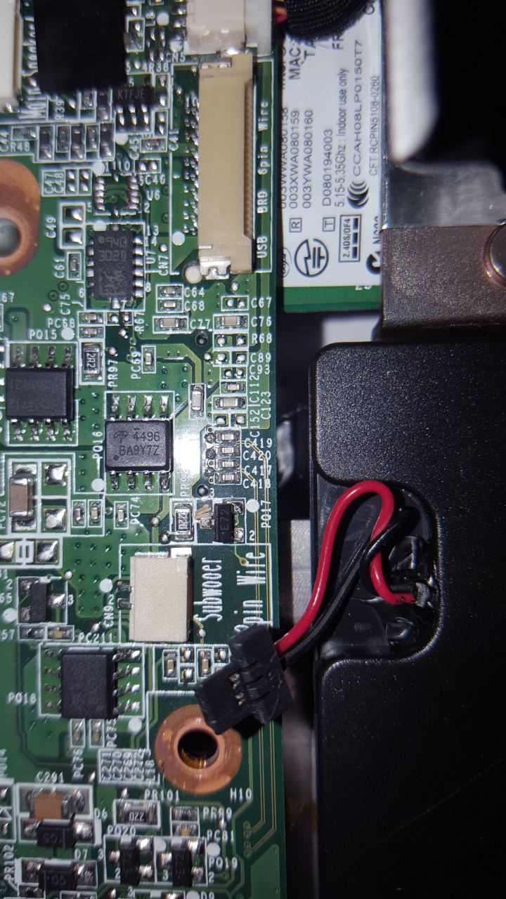

    HP DV7-3080us Bad/broken transistor marked E72 marked PQ17 on MB
    This laptop was bought as a re-furbished and whomever did the work left 2 screws inside on the MB and also cracked the top of PQ17 a SMD transistor beside the SubWoofer jack on the MB. I just wanted some help identifying this part for replacement. I may have another HP DV7 I can use for a donor board but still would like to know in case I need a new one. Thru google i found much confusion but closest found was 2n7002 E72 Mosfet Smd Sot-23 The photo is an exact match. but I am not sure it is the right part.
    MB part number DA0UP6MB6E0 REV: E
    Foxconn
    ML1-H94V-0
    E25311 Made in china 168UP60001-157E
    I tried to get a clear closeup photo for you but i don't have my microscope on this PC. I used my cell phone for this one.

    Re: HP DV7-3080us Bad/broken transistor marked E72 marked PQ17 on MB
    Schematics attached.
    It is indeed a 2N7002E.
      Thank you very much on both accounts, the schematic is a plus!!!
      • Doc38343
        • Apr 2015
        • 402
        Thank you piernov - I finally found a donor E72 on a dead ACER board. I'm glad I keep all the boards now. I came close to throwing it out since it had coke or pepsi spilled all inside.
        Anyway I am happy to report a successful repair and completed job.
        Have a great day.. everyday!!
