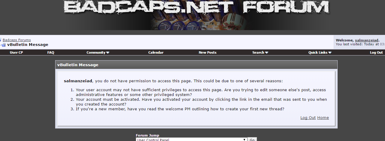

                • salmanzeiad
                  • May 2016
                  • 68
                  • world
                  Re: HP Pavilion DV7-1015eg Power issue
                  Originally posted by onlyprinzp
                  OMG why don't you open a new thread yourself and spam in mine?!
                  i`m new user>>>and can not create new post!
                  • salmanzeiad
                    • May 2016
                    • 68
                    • world
                    pic
