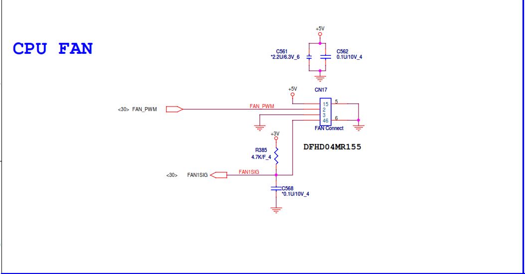

                          Re: Hp G6 Core i5 turns off after 10 seconds
                          I have tested 2 fans, both don't work, 1 is 100% sure working, picked from another mobo.
                          I have added the shematics, maybe an expert could point wich Component to check for fan voltage.
                          • nixi22
                            • May 2016
                            • 44
                            • Croatia
                            At cn17 (fan connector) check if ther is +5v at pin 1 and FAN_PWM at pin 2
                            • passete
                              Living=Sharing
                              • Jun 2015
                              • 487
                              • France

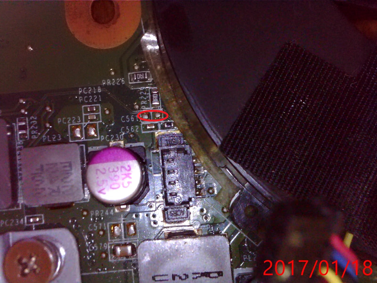

                              Pin 1 I have 5V but on PWM Pin 2 0V.
                              If i have 5 volts on Pin 1, why the fan is not spining ?
                              I also notice that on page 32 of schematics that i should have a capacitor on C561, but this placement is empty !
                              • nixi22
                                • May 2016
                                • 44
                                • Croatia
                                You need to have PWM signal for fan to spin. 5v is just power for fan internal PWM circute,in short: that pulse width of signal is going to determine how long shoud 5v be on and then takes average of that on off state, and you ending up with different voltages (speeds) on fan itself 2,2.5,3,3.7v.... (dc to dc buck converter).That pwm signal is generated by kbc and signal width (speed of fan) will be increased if cpu gets warmer thats how you control speed of fan acording to his temperature,check if kbc gets his power right maybe try to replace him if you have spare kb.Dont worry about that cap it's optional thats why there is * on schematics

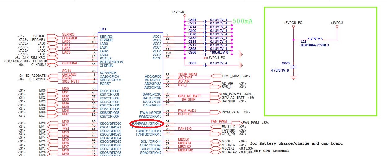

                                  If i replace the kbc, don't i need to reprogram it ?
                                  • nixi22
                                    • May 2016
                                    • 44
                                    • Croatia
                                    Any time
                                    No you no need to flash it just make sure to replace with right kbc and lets see if fan will work then
                                    • passete
                                      Living=Sharing
                                      • Jun 2015
                                      • 487
                                      • France
                                      Originally posted by nixi22
                                      Any time
                                      Maybe before replacing the Kbc, i can measure pin 26 on U14 to see if i get the PWM voltage ?
                                      Which voltage should i have ?
