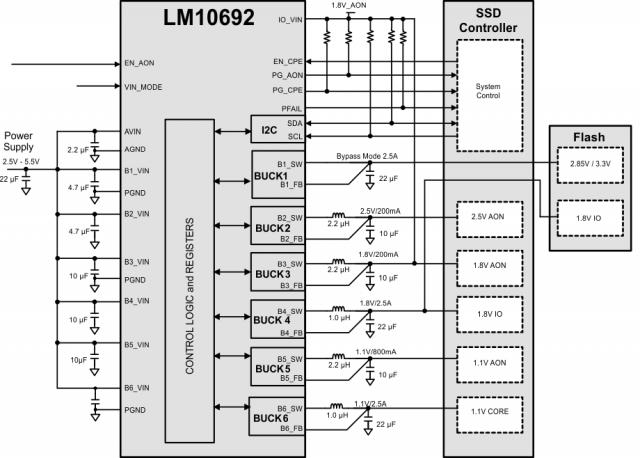

                                • cpt.charlie
                                  • Sep 2013
                                  • 270
                                  • Spain
                                  #36
                                  Re: Need help fixing a Sandisk X300 SSD drive.
                                  My sugestions are:
                                  1- check the main connector for bad solder joints
                                  2- Check the voltages of the SSD, have a look at the attached image as generic reference, maybe one of the internal power supplies have failed, do you detect any overheating component on the drive?
                                  If all voltages are OK, you may have a firmware corruption.
                                  • Spork Schivago
                                    • Mar 2012
                                    • 4734
                                    • United States of America
                                    #37
                                    Originally posted by cpt.charlie
                                    My sugestions are:
                                    THANK YOU!!!! I will get right on this. You're awesome!!!!!
                                        So I take my multimeter and start checking the voltages coming from the the PSU of my PC, but on the PCB of the SSD drive. I check where they're coming in from. The 12V reads around 12V, the 5V reads around 5V, but all three of the 3.3V read around 1.75V. When I first touch the probe, I'll see 3.3V, but then it drops in a flash down to 1.75V (roughly).
                                        Is this normal? Or could this mean there's something wrong the components that require the 3.3V? Thanks!
