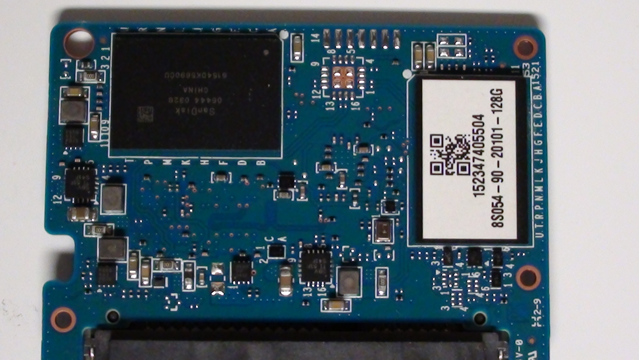

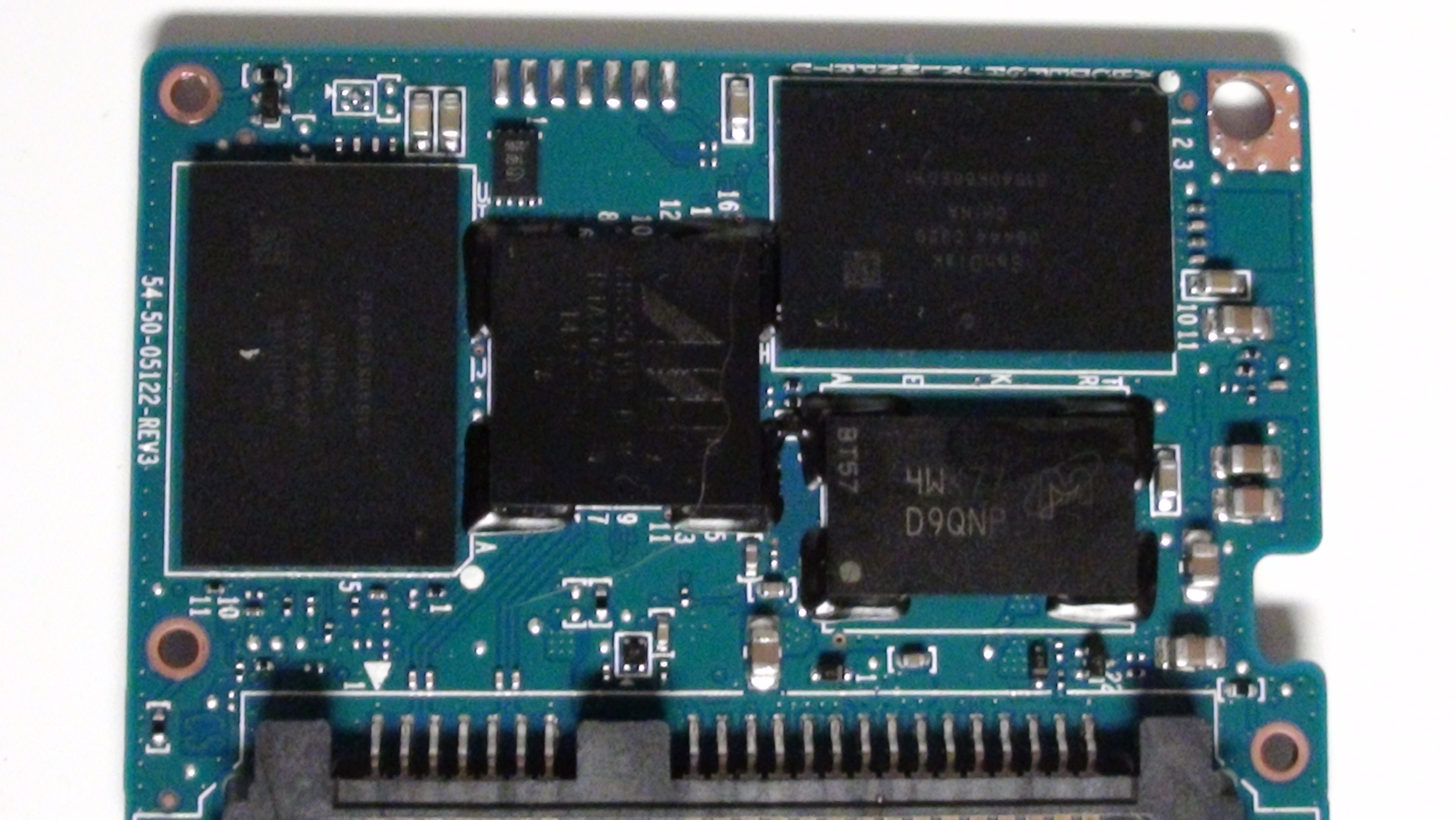

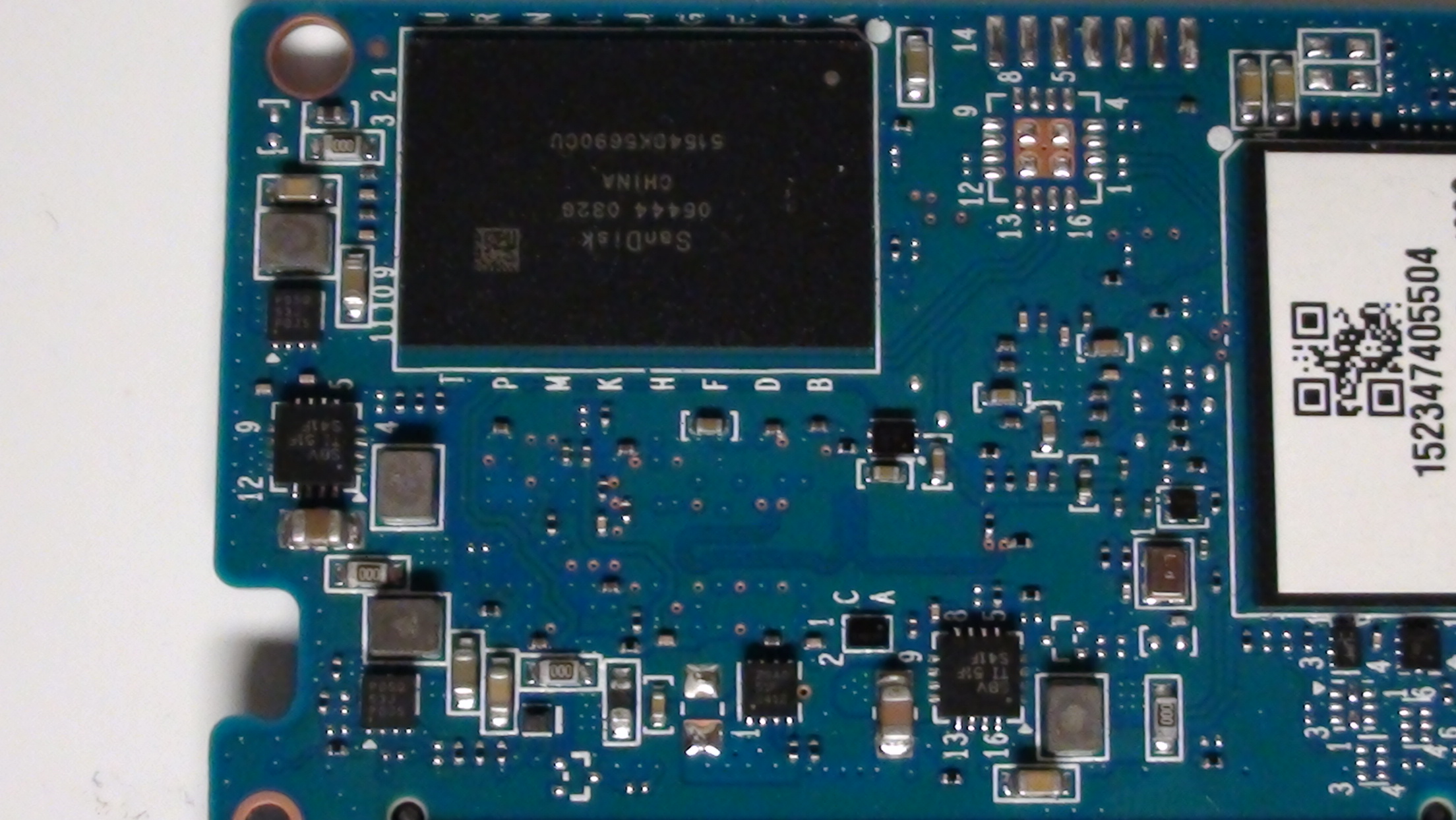

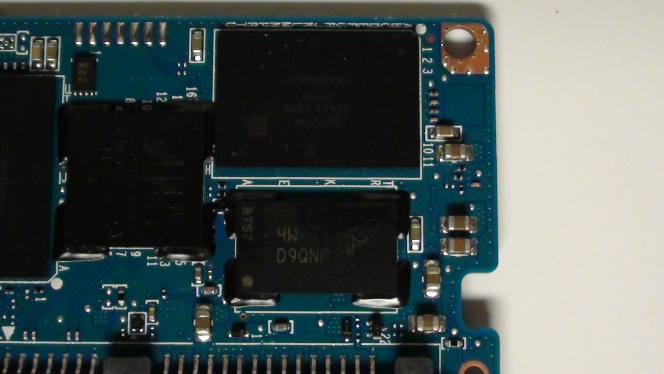

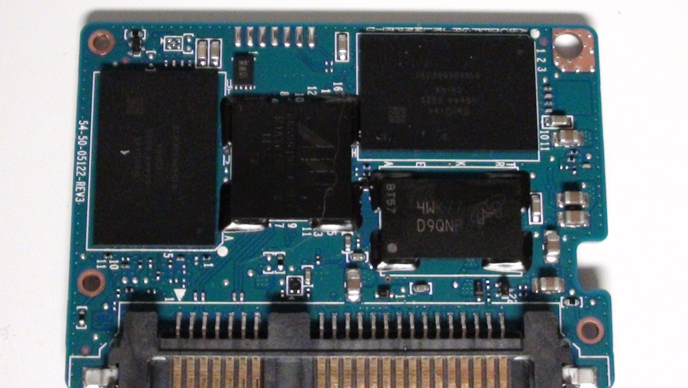

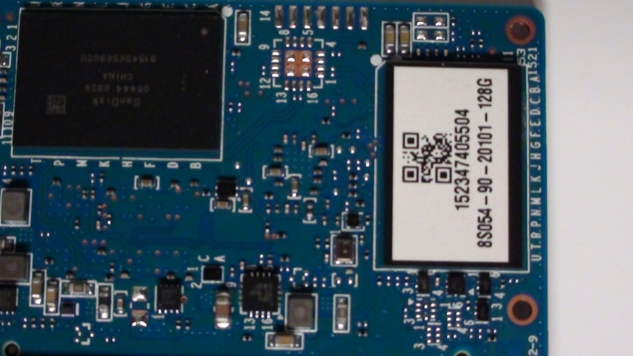

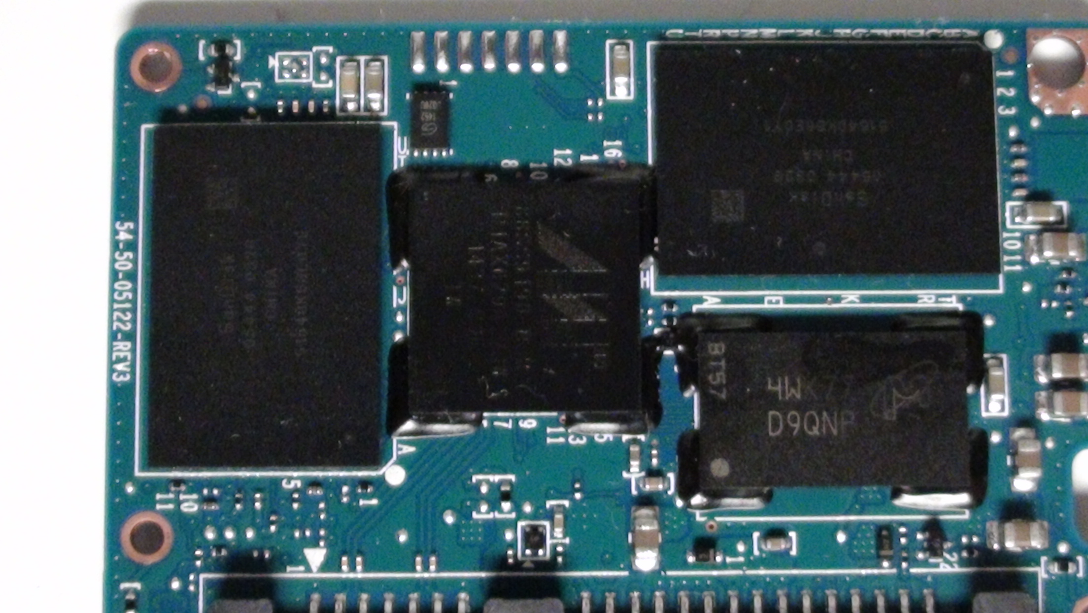

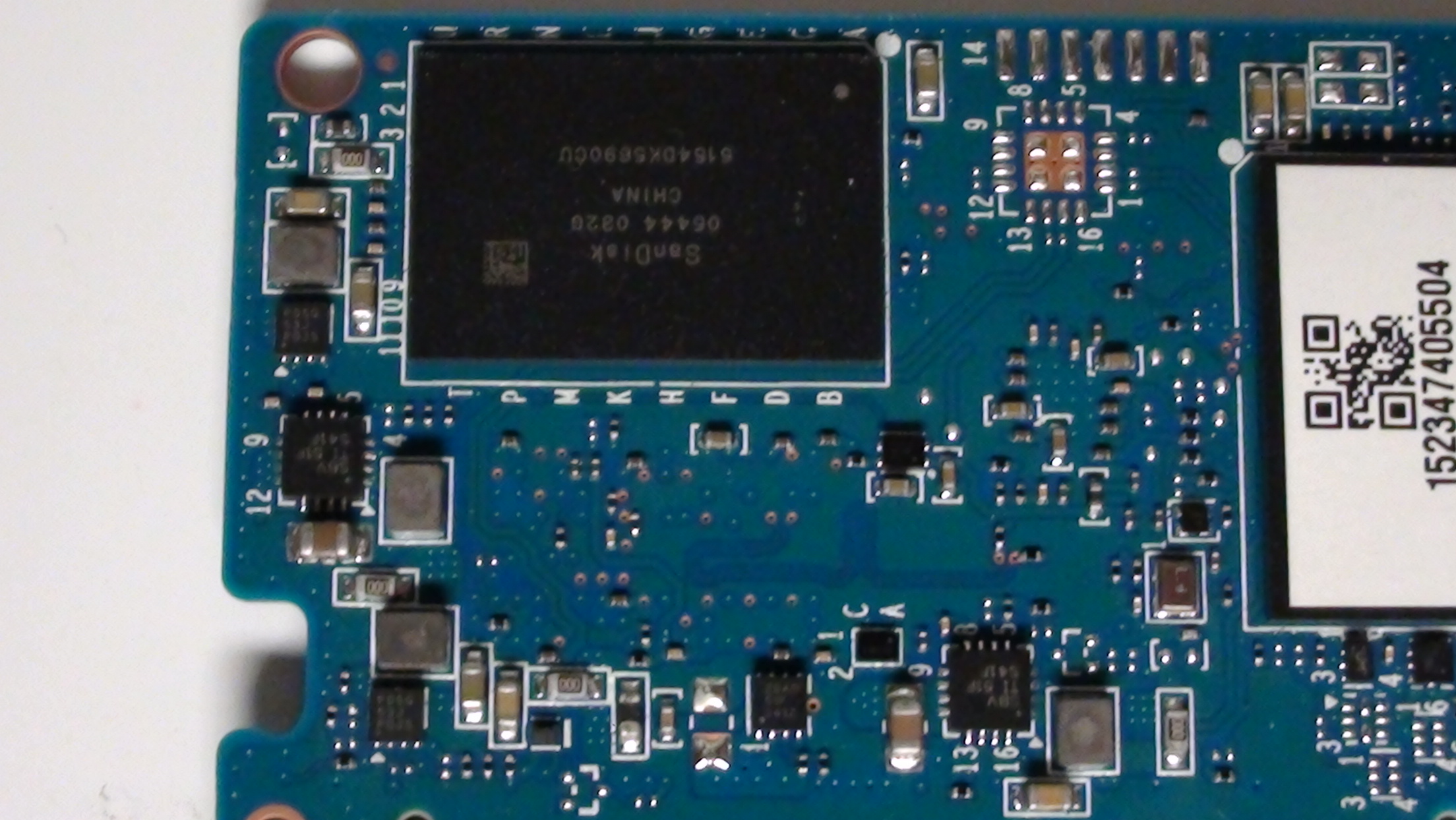

    I'm not sure if this is the best sub-forum to post this under but I couldn't really find one that fit. I didn't think it belonged under the normal computer repair forum but if it does, perhaps a moderator could move it for me?
    A friend brought me a 128GB Sandisk X300 SSD drive. He says he was using his computer, turned it on one day and the drive wasn't detected anymore.
    Sure enough, on my computer, the BIOS does not detect the drive. I believe there's a problem with the PCB. I don't have any experience with SSDs. Does anyone have any ideas what might be wrong?
    I believe I found a SMD fuse on the PCB and I put a my DMM probes acrossed it, checking for continuity. I got a reading of 0.000 Ohm.
    There's a bunch of SMD caps. I'm wondering if one of them might be bad. There's also a few SMD resistors (or what appears to be resistors) but they have the marking 000 on them. I've seen things like this before. Not really sure if they're resistors or not, but if they are, why would we ever have a resistor that reads 0 Ohm?
    I'd appreciate any advice anyone could give me. Thanks!

    Photos help as always.
    0 ohm resistors are common.

              I was thinking maybe the same. Could it be a bad solder joint or do you think the IC that holds the firmware has somehow gotten corrupt? I wonder how hard it'd be to change it out with another one or how I could flash the firmware back to the device (if I could find the firmware to flash in the first place).
              Maybe I could solder some wires somewheres and flash that way. I did that with one of those R4i clones for a 3DS once and then with a development dongle I had once. I forgot to add some code that would allow me to put the device in programming mode. I had to solder some wires and flash on to fix it.

                Maybe I'll pull that little sucker and test it. Maybe I'll just pull the SMD caps, SMD transistors, SMD diodes, etc and just test them for shits and giggles.
                All the components are really close together though. I'm afraid if I put some hot air to it, I might blow some of the even smaller stuff right off the board. There's some stuff that is soooooo small, I can't even see it without a magnifying glass. That's insane!

                  A quick Google suggests its a self encrypting drive, unless you're very lucky and find something that's failed, the data has gone I feel.
                  Forget the magnifying glass, get a microscope. I'd probe with your needle tipped probes rather than try and remove components.
                  0 ohm resistors are used due to the way boards are made with pick and place machines. They also allow for easy change in design.

                    Self-encrypting drive. Okay, thank you. I had a self-encrypting external once that a customer brought me and the PCB had died. The hard drive, when I plugged it into my machine, I couldn't access the data. Fully encrypted. But it was odd, all I had to do was purchase another PCB for that enclosure (same version and everything) and the hard drive worked. Like they didn't change the keys or anything. Kinda pointless I guess. Obviously, that wouldn't work here.
                    I will probe with the needle points, where I can, but that transistor looking thing, I don't know how to probe that without my DCA meter, which I don't have needle probes for. I have an SOT-23 adapter that allows me to hook alligator clips up to it (essentially, it makes it a really big SOT-23 package). For the caps, being SMD, can I measure them in-circuit using a DMM or ESR meter? My DDM showed OL for the one I tried measuring. I thought with caps, we always had to pull them.

                                        if you run out solution you can always try to heat up board, maybe some cracked joint wenat bad but thats kinda last solution cos you can easy destroy drive which can be recoverable by professional
                                        might wana try reading a bit on hddguru.com but without pc3000 and tons of expirience i doubt its recoverable
