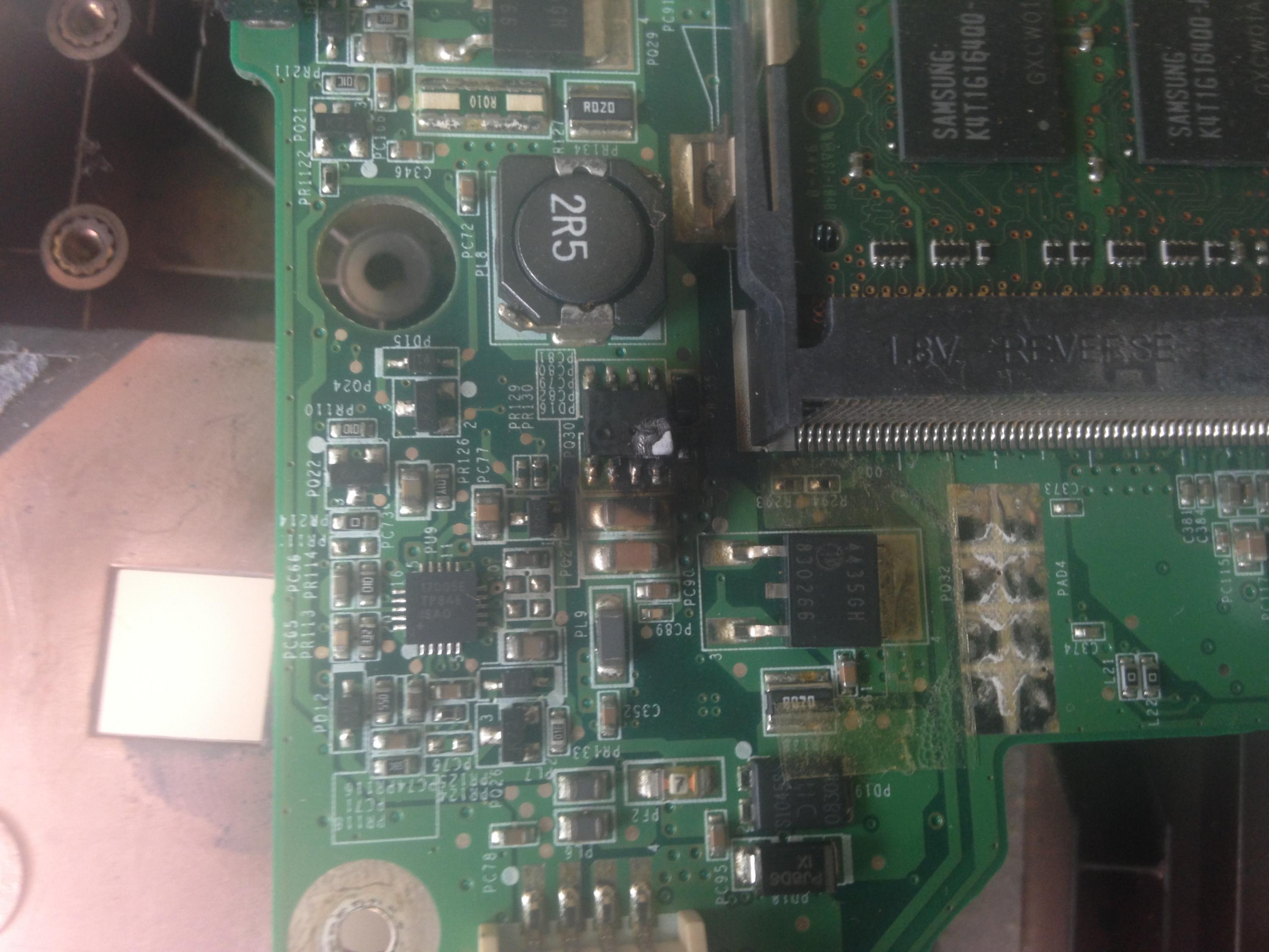

    Hi everyone i need help please i have this fujitsu siemens li 3710 no power when i checked up the board there is a burn power mosfet AO4916 but i dont have this one anybody can advise me a replacement for this i have a lot of scrapboard here but some i checked its p channel and 4916 is nchannel.please help me thanks in advance.I have attached the img

          you say the mosfet is AO4916 (30V Dual N-Channel MOSFET with Schottky Diode).
          But according to schematics its AO4932 (30V Asymmetric Dual N-Channel MOSFET) and they are not the same in specs. The picture you posted is blurry, so if you provide a new pic with the part number clear then its easier to know the part number. Did you get the part number from schematics?? which?

            thanks for the response i did not get the part number becuase due to burn half of the fets i only get the number its AO4916 and part number starts BD then cannot read next

              Your best chances then is with either AO4932 or AO4912, they are pin-pin compatible and available on ebay.
              http://www.ebay.com/itm/10PCS-AO4912...IAAOSwl9BWIEsl
              http://www.ebay.com/itm/10pcs-New-AO...UAAOSwcu5UT6P4
              If you read on chip AO4916 then go for that

                remove FET then check the pads. in single channel, pins 1 2 and 3 - shorted, pin 4 separate pins 5 6 7 and 8 shorted.
                if not like this then its dual channel
                hope this helps

                        Hope you yourself checked the schematics before you wrote your answers, Its dual mosfet regardless if its asymmetric or symmetric.

                          Its a dual mosfet, you must place the new one with right orientation otherwise you fry something else, so be aware of the orientation and pin compatibility when replacing.

                            thanks for the help problem you are right tibd it is dual channel mosfet I follow advise of fddizon and follow your advise I change with AO4932 mosfet now laptop fired up. thank very much for the help
