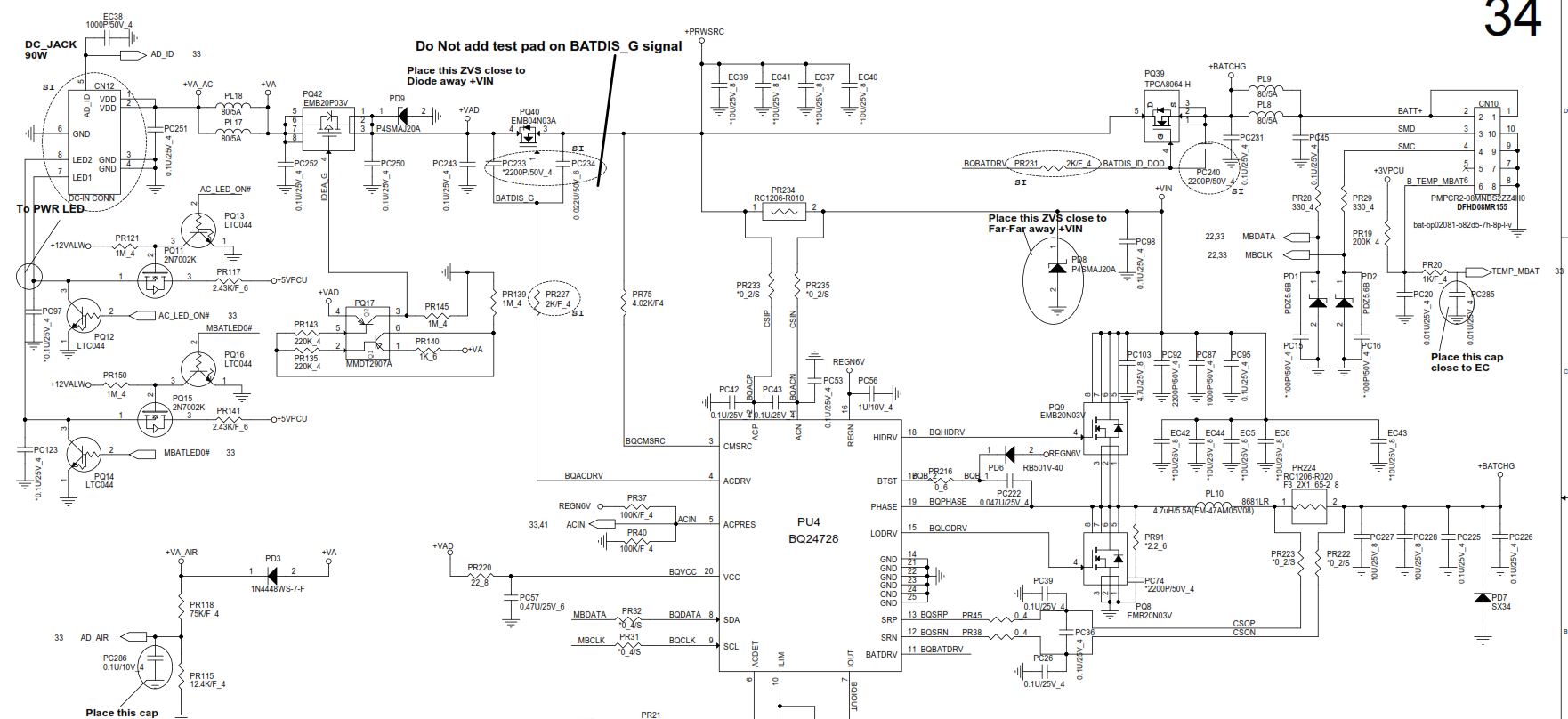

    This laptop is not turning on, only signs of life is the led on the power jack that blinks 3 times when i press power.
    Not also charging, i have 3.3V on Bios and power switch.
    I have tried 2 Dumps, but no change.
    Laptop Model : HP 17-E140NF
    Motherboard : DA0R75MB6C1 REV C
    Can anyone post boardview and/or schematics ?

          • passete
            Living=Sharing
            • Jun 2015
            • 487
            • France
            Re: Hp 17-E140NF No Power No charging
            Could this problem be related with PU4 (BQ24728) shown on page 34 ?
            I don't know which voltages need to be correct (Pin), that's why normaly with boardview is easier.

                      • katfish
                        • Jul 2016
                        • 76
                        any physical dmg on the original jack?
                        jack blinks are a different problem than cap/num lock blinks.
                        Just for giggles, check R460 and R456. Maybe also check R459, C738 and C742. All on page 33 of the schematic. Look for physical damage and then check the values. I had a similar case where AD_ID took 20v and fried the EC (ITE). Along the way, it fried a couple components on the AD_ID line. Board wouldn't power on, gave blinks on the jack. Was the 15 inch model ...

                          • passete
                            Living=Sharing
                            • Jun 2015
                            • 487
                            • France
                            Nothing wrong with above, owner always used with the original charger.
                            Originally posted by jasko_jacker
                            Have you check the bolton FCH ?
                            try to heat it up to 150 degrees and immediately turn on the machine
                            This is an 16 months Old Laptop, until now i never see a cracked solder on PCH or other Bga.
                            I'm conviced that it's a faulty IC or A Short.
                            Thanks guys, you are always welcome with ideas.
