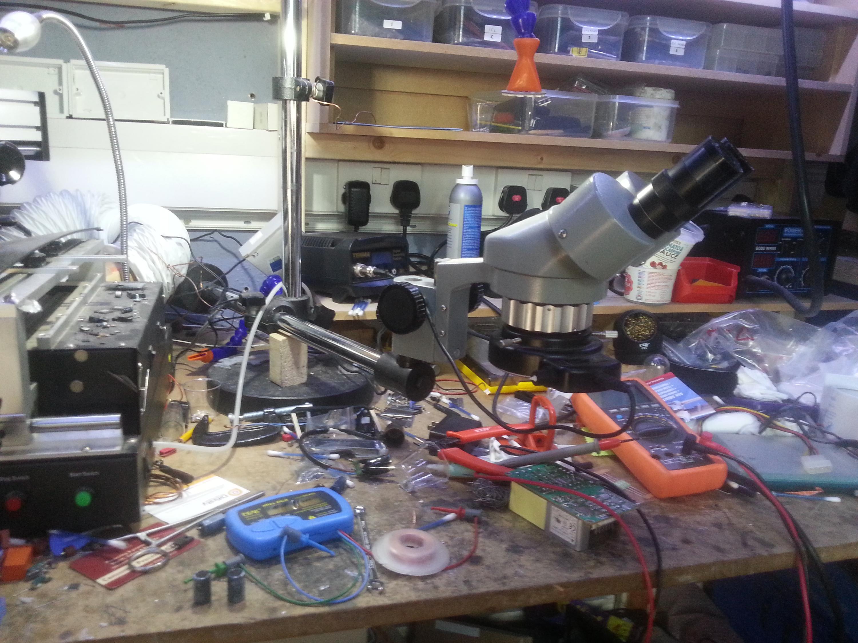

                  Re: Using a different battery to test a Samsung N900V
                  It's Samsung's adaptive fast charging nothing to do with USB3. The S6 has it but only a regular micro USB socket. Something in the phone tells the charger to give more juice. It should still charge without the extra current just not as fast.
                  I have used a micro usb to female USB adapter with an unsoldered USB connector plugged into that. You can then check the continuity without the risk of shorting anything. You only need to test the 5v and ground.
                  Excuse the mess !
                  I went with a "proper" stereo microscope as I felt it best, the optics, stand, working over the piece rather than looking up at a screen. The screen near my workbench can show schematics rather than the work piece. It looks cool too
                  It has certainly helped me immensely when repairing SMD stuff. I can comfortably measure the pins on any device and can do repairs that weren't practical to do. I'm pretty sure a USB microscope would do the job, any aid in seeing the work greatly increases the ease and speed of work.

                      How much did your "proper" stereo microscope cost you? Also, is that a BGA rework station off to the left there that I see? If so, which make and model do you have?
                      There's always a chance it's not the actual port but something on the charging port board / module as well. I'll test the continuity for the gnd and 5VDC wires. I'll take a micro-USB cable and just cut it so I have access to the wires. Then I'll plug that in and figure out what wire is what and what pin is what.
                        It was second hand off ebay, I won it for about £120 but the seller was cool and let me have it for £100 when I turned up. Seeing up close is good, add in 3D and its awesome. Something a USB microscope doesn't do.
                        It is and it says Scotle on it, not sure if it's genuine or not but it has quality heating plates.
