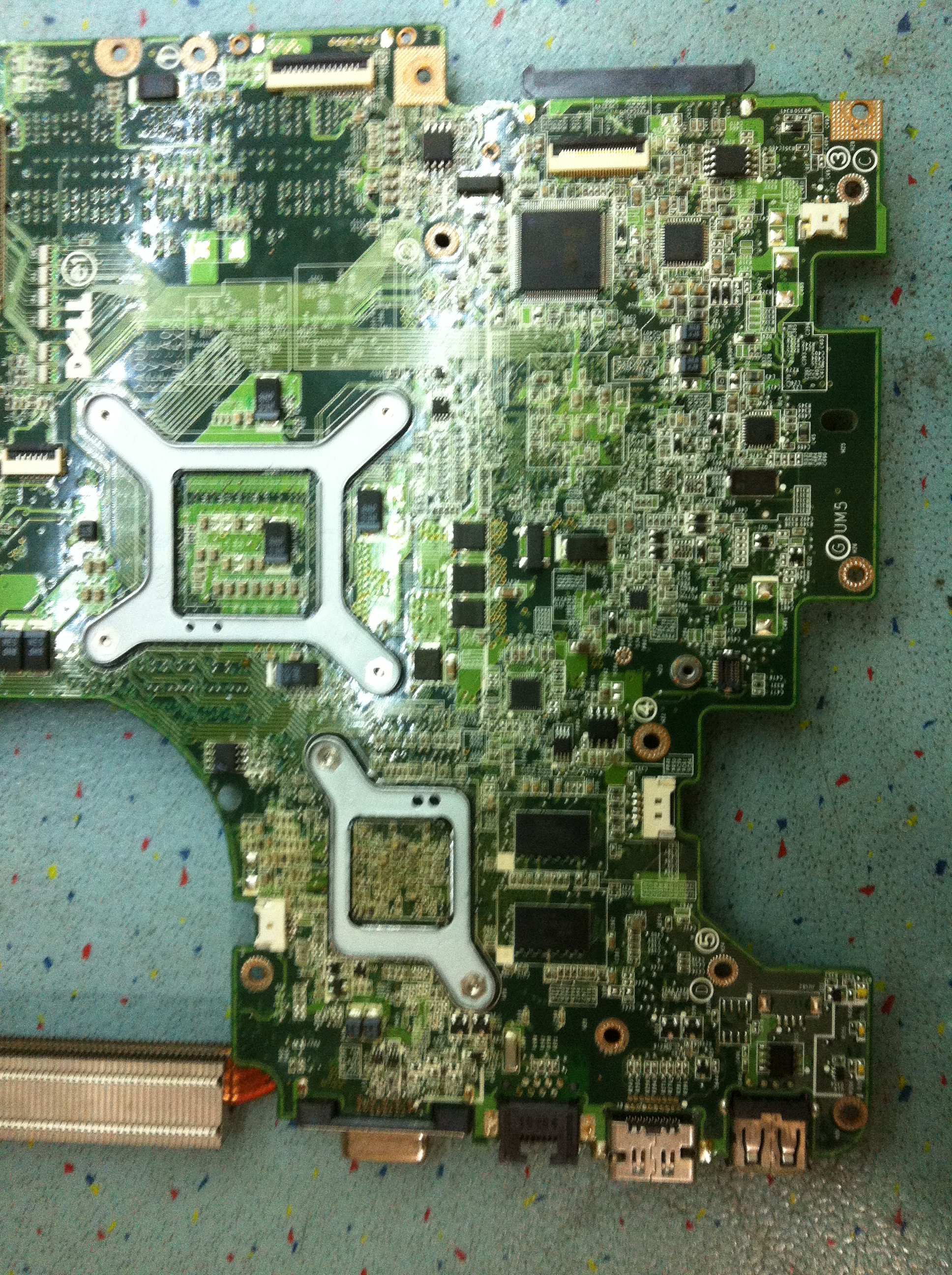

dell inspiro 1764 uma
  • asliyucegsm
    • Jun 2011
    • 347
    • Turkiye
    my friends
    DA0UM3MB8E0
    REV.E
    REV.A00
    PWB.5X2FJ
    İ5 processor

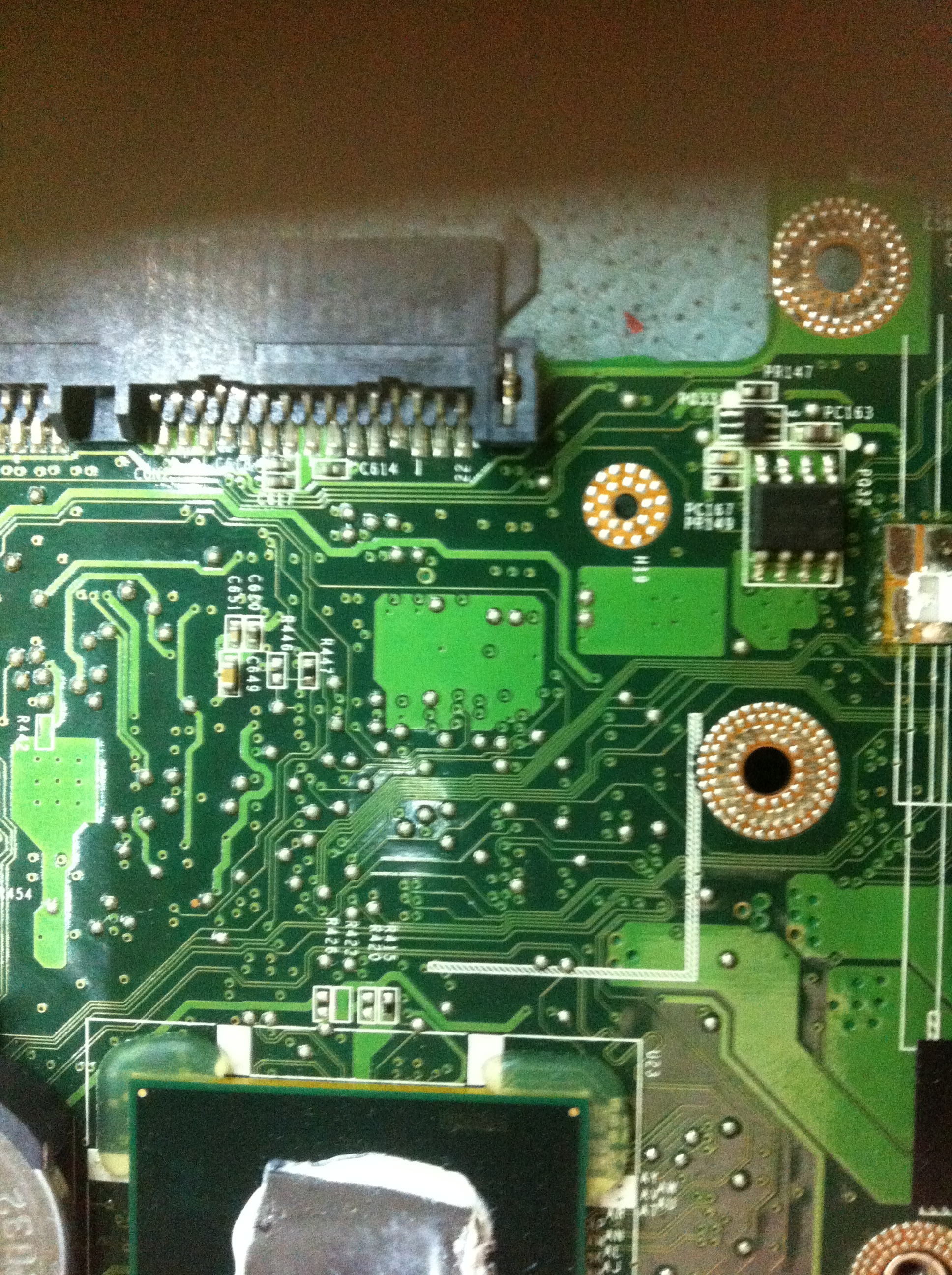

    How do I do that my friends help me
    uma help

    take picture of that area of motherboard

      Re: dell inspiro 1764 uma

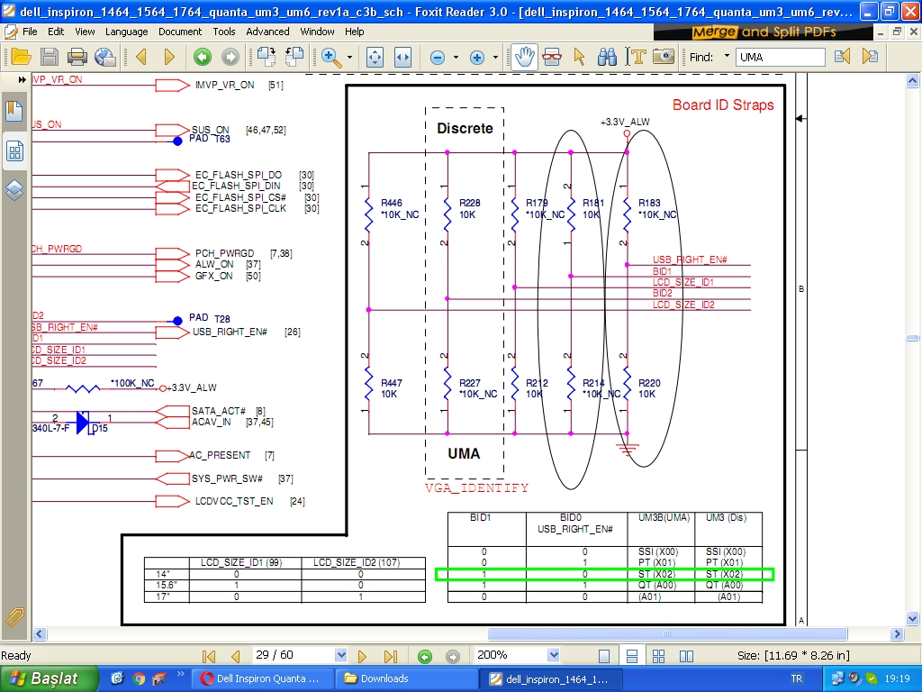

      its very simple , you just need to move the resistor frmo the discrete side for the UMA SIDE , also you must remove the gpu power coils as well . if you want to totally disable gpus
      disabling gpus is ververy very easy reading schematic , lately i've doing it a lot , for does who do not want to pay for chip replacement !!
        I never tried it, so in this case need to remove R228 and to put it on R227 ?
        Right ??????
          My friends need to cancel what resistors
          To remove the video card must
            can you send me pic where is restor r227 and r228 i try but cant find
              As far as i know, this mb cant be converted to UMA.Can anybody prove me wrong??
                re228 r227
