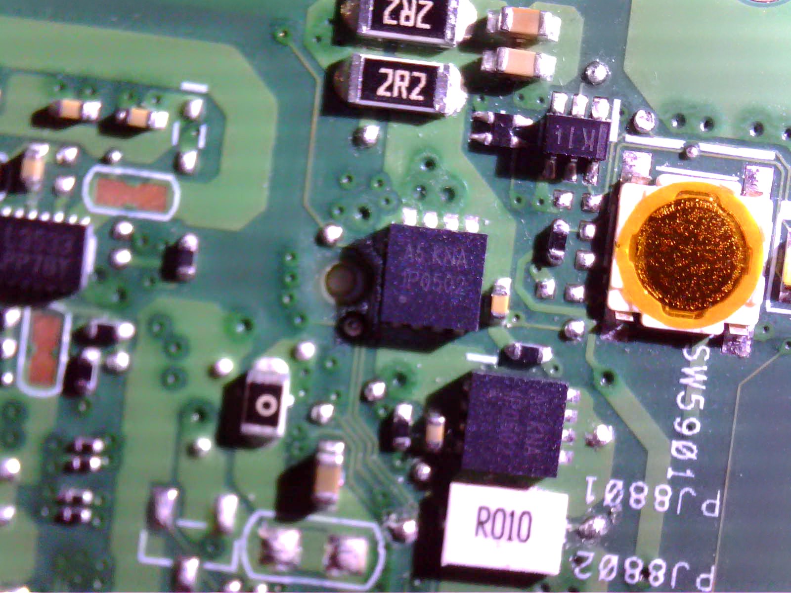

    A5KNA compatible IC
    Which IC can be replaced for this A5KNA ?
    I have here one A5KNB and A5VNE, can i use this one ?
    Thank you

    Re: A5KNA compatible IC
    This is from a Asus S301LA mobo, i've found this after some search :
    http://www.ebay.fr/itm/5Piece-new-NI...AAAOSwIgNXuBDZ
    Is this the right IC ?
      marking significant "A5" P0903BEA. Everything else - the date, lot, etc.
        So, can use this A5KNB and A5VNE from a asus scrap board ?
        NEVERMIND: i just replaced by 2 A5VNE and the problem is Solved !
