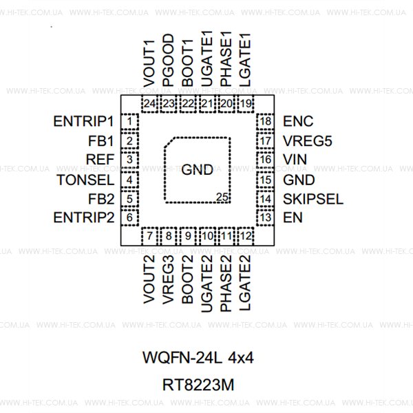

          I just found pins 20 & 21 on PU3 are shorted together.
          I guess that confirms this is where the fault lies?

              Re: Quanta R22 (HP G6-1001sa) no power
              its RT8223

                    For the upper MOSFETs, The voltage on the gate swings between PHASE1/2 (OFF state) and BOOT1/2 (ON state). So in the off state the UGATE1 is set to the PHASE1 voltage to turn the MOSFET off.
                    If just that one pair of pins are reading as shorted, that would be weird. But, if the other 3 corresponding pairs for the other 3 MOSFETs read as shorted, then that would make perfect sense since both outputs are off. Whatever way the IC changes those voltages internally, it should be consistent.
                    The best way to check a regulator IC like this:
                    1) Check all the output voltages. You're not getting the buck controller (switching) outputs, but are you getting the LDO outputs? (pins 8,17) Just make note of these voltages (or lack thereof) for now.
                    2) If any outputs are missing (the 2 switching outputs or the 2 LDO outputs), then check those lines for shorts to ground. If shorts are found then investigate. It looks like you checked this for the switching outputs already, but did you check the LDO outputs?
                    3) Check the supply voltage and enable signals. You already mentioned it's getting the 19V supply, but is it actually being told to turn on? (pins 1,6,13,18 should be high) Compare what it's being told to output and what it's actually outputting. If it's not receiving all the enable signals, then start checking those specific signals.
                    4) On an IC this small, just check all the remaining pin voltages to make sure you get what you expect. If everything is just what it should be (other than the missing output voltages), then you probably have a bad IC and/or MOSFETs. Since you've already replace those, hopefully you'll find the problem before you get all the way to the end of this step.
