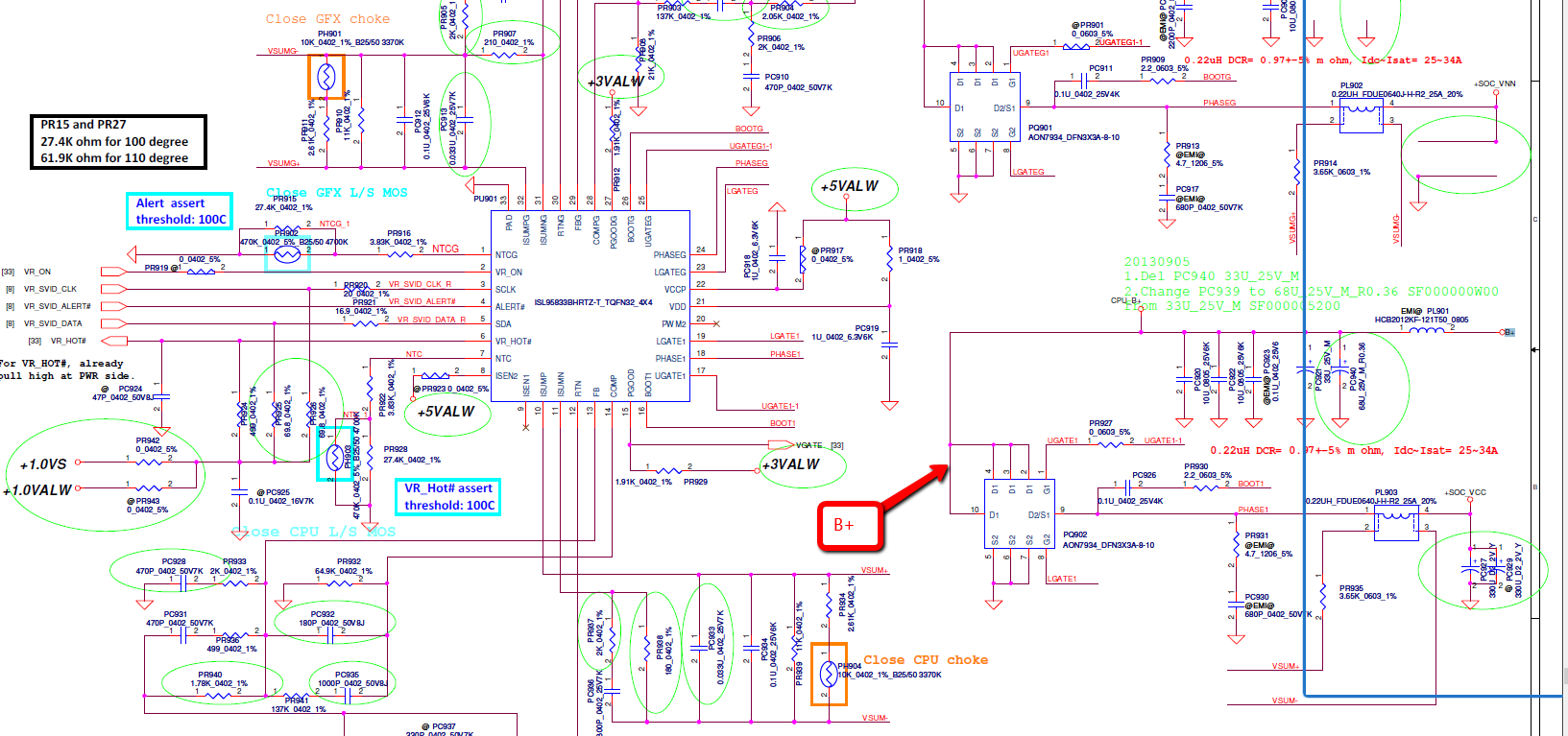

    hello, i have this Lenovo B50-30 (ZIWB0/B1/E0 LA-102P) that have water damage.
    I clean mobo and laptop turn on but HDD wont spin, and DVD wont open.
    I check voltages on HDD and it have only 3.3V and 0.5V.
    What do you think this could be?

      check the +5_vs supply on the 14,15,16 pin of the hdd connector (SATA HDD1 Conn.). if it is 0v, check R129 resistor.

        Hey i found that U11 was burned, i remove it and look the pads are burned.
        Is it possible to bypass this MOSFET?

                      hey i manage to replace the MOSFET. I have 5V and 3.3V on output now. But now my laptop wont show display I do not think this issue is related to this MOSFET.
                      Will try to flash new bios, and also i found that battery (3V battery not laptop battery) holder is broken.
                      Can this be problem and reason why laptop wont start? Because it do not have this 3V from battery?
                      Also non LED indicator wont blink, only turn on LED on pwr button

                            hey i managed to fix this (it was bad RAM slot)
                            All is working now exept laptop wont charge battery. When i plug in charger (laptop is turned off) and start it it wont charge battery. But when i start laptop without battery and then plug battery (when laptop is ON) it will start charging

                              Hello, i find that PU602 getting really hot. i found that on pin 8 (IN) get 19V. is this normal.
                              Pin 8 is maked on schematics as "B+_1.0V"
                              Also i found that only pin 3 (ILMT) is shorted to GND but i this it should be shorted to GND.
                              Alse i found boardview of this board, so i attached it.
