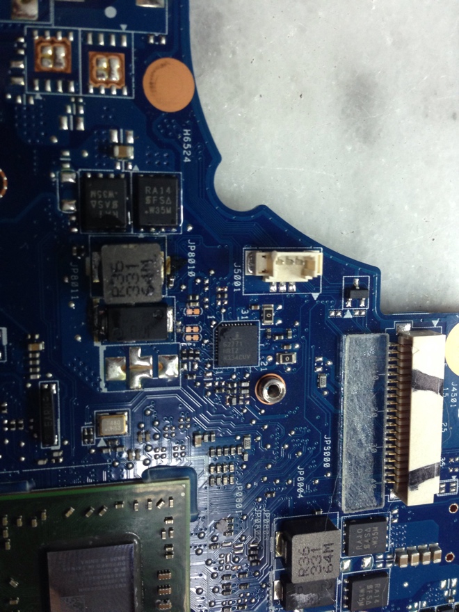

    I m working with this satellite c50d-a-133.
    First problem is not charge , i checked fist 19v is ok , on fuse battery have 3v ok, 3.3v , 5v ok.
    So i flashed bios and OK charge power up but no display ..................
    now no display , no fan activity vo voltage on fan pins , cpu no voltage on coil and THIS COIL JP8010 OR JP8011 IS SHORTED WITH ground.
    i don t have schematic , any experience or advice pls .
    PT10AN DSC MB
    Rev 2.1

    Re: C50D no voltage on COIL
    anybody have this schematic.
    the mosfet near to coil (on the picture) pin 5678 have 19v , pin 1234 0v i think maybe this is the problem but i don t have schematic to identify the model of mosfet?
        If don t have voltage on cpu coil and no fan activity is IC problem or maybe any mosfet burned ?
          PT10AN DSC MB
          Rev 2.1
          it seems the amd cpu is shortes,i checked on a workin MB and yhe inpedance to
          ground is aprox 20ohms,in my expirience this lind of chips tend to overheat and short
          to
          ground
