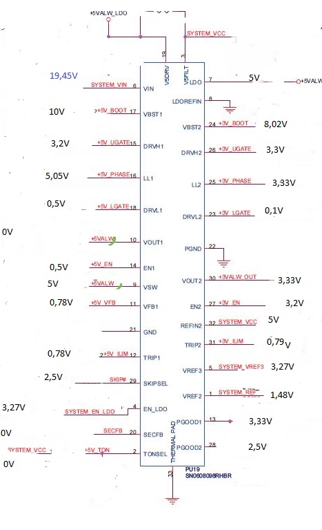

    New measurements on PU19< With PL6 still unsoldered
    Picture 1 with the standard values and picture 2 with the values after pressing on/off switch. Led from switch turns off after 3 seconds,but the voltage stays 30 seconds

          pu19 pin 6 , what do you got ? and also pq70 pin 8
