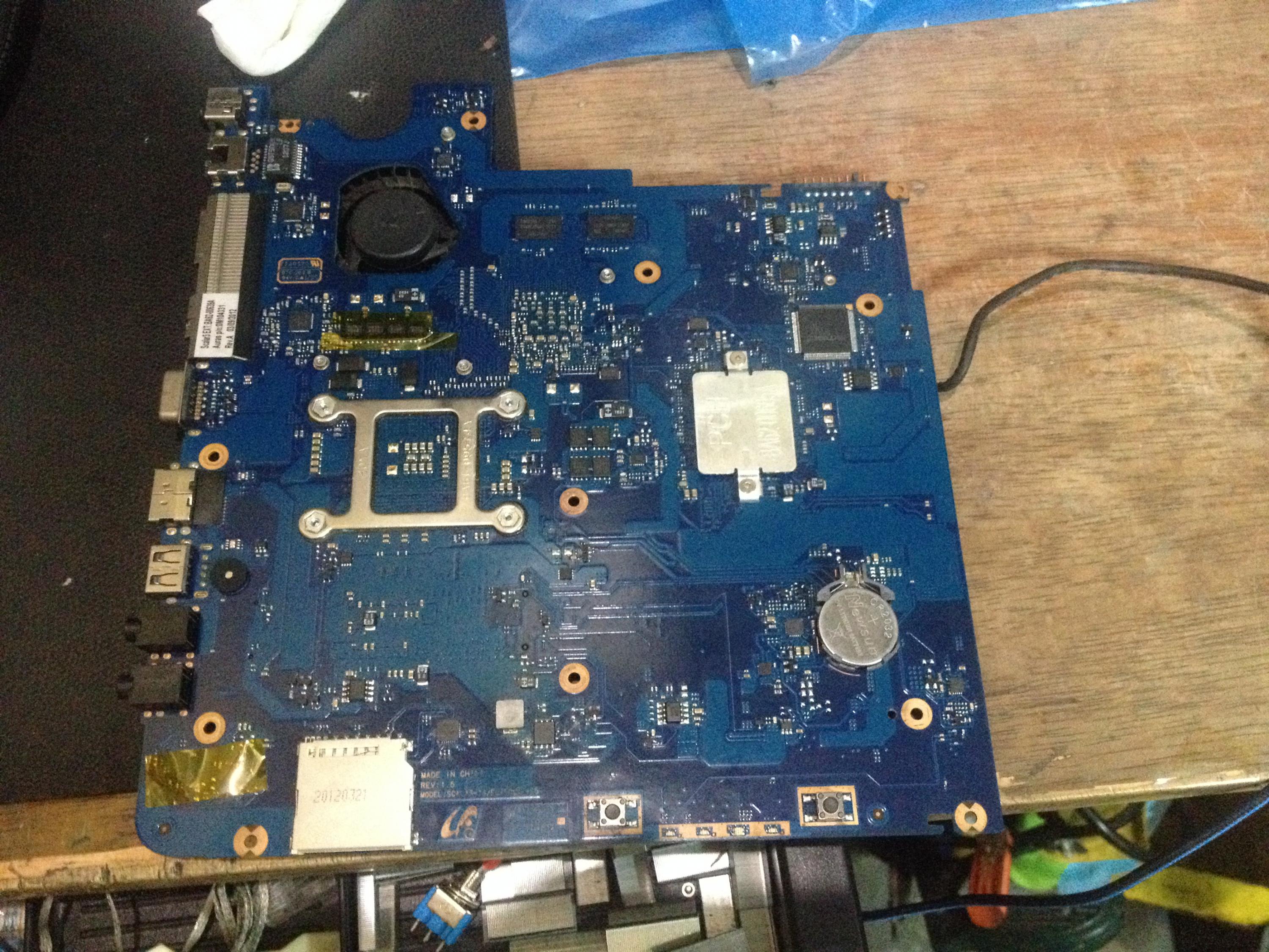

    i got samsung mobo with no power.

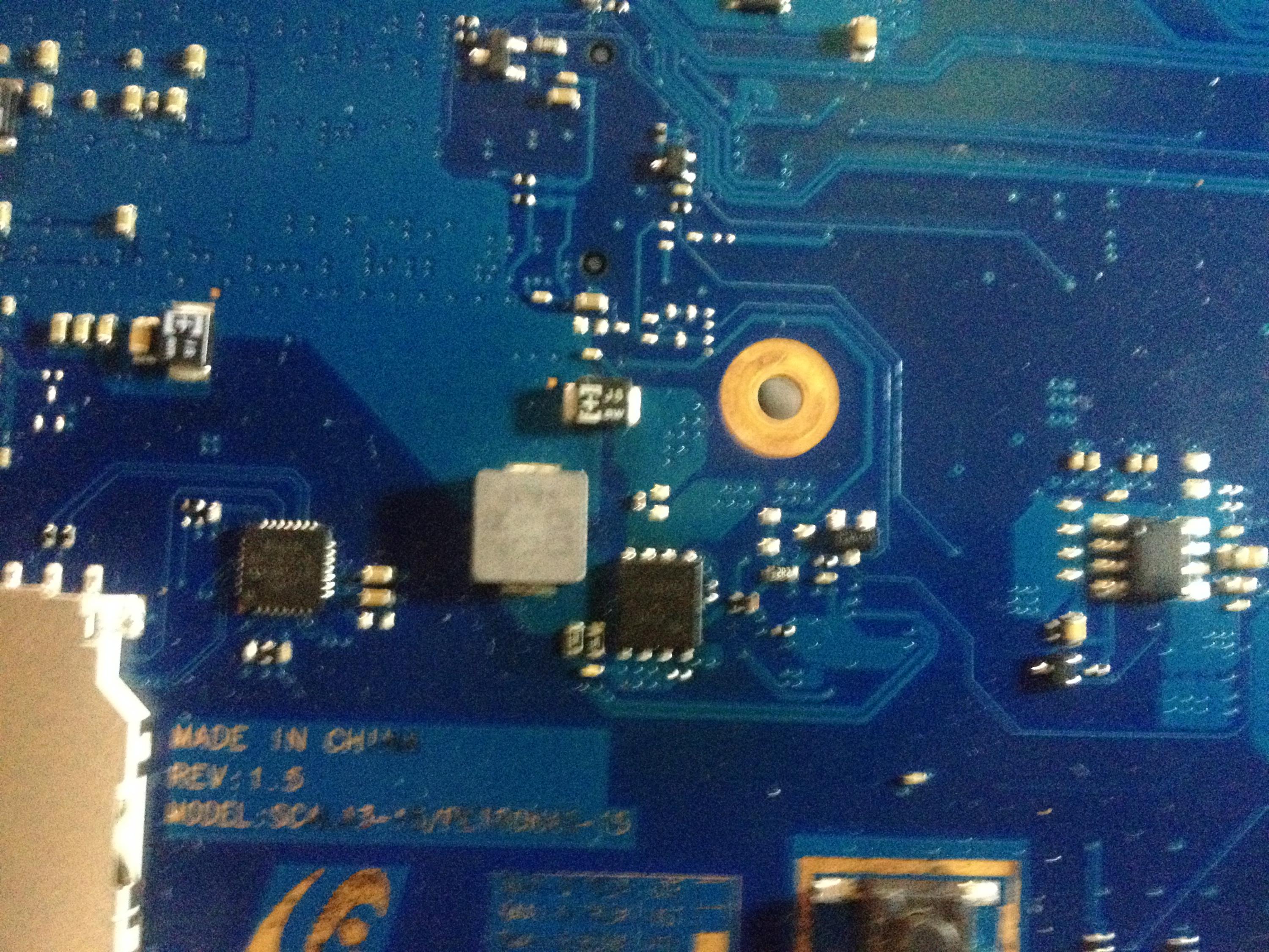

    i found faulty caps and mosfets

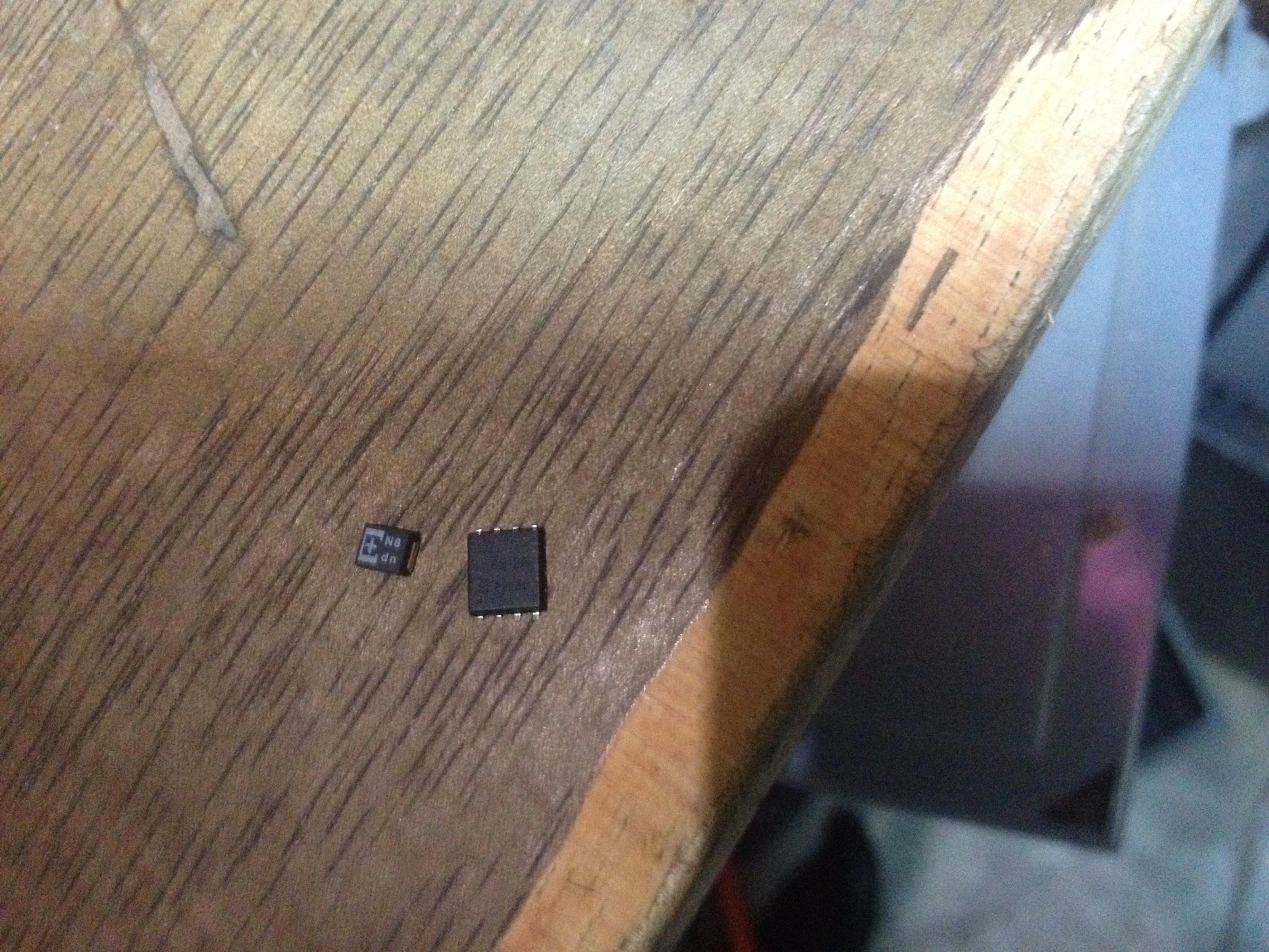

    caps (N8 dn) replaced with (J8 ew)
    mosfets (AO6912A) replaced with AO691
    after that a got lit on mobo indicator. i guess that got it working
    when i turn it on. it burns the caps and mosfets again.
    i just wanna ask if i got the right parts replaced.
    for the caps i put (J8 ew) and
    mosfets ao6912 with out (A) code.

    http://tehnodoc.com/files/schemes-fo...a-ba41-02098a/

      marking H or A at the end usually means same characteristic but higher current

        Check the feedback resistors from the mosfets to the ic controller
