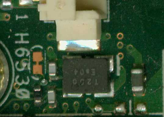

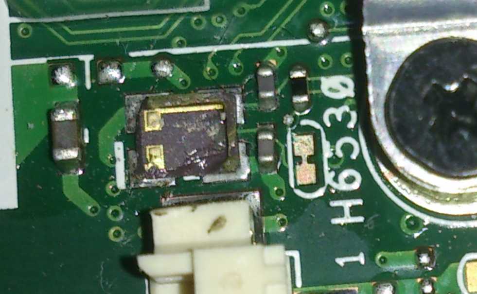

    I need help, i can't understand what kind of component this can be.
    Thank you, Pit-one

    Re: Asus k56cm broken component
    Looks like a quartz crystal.
    Code:
          C
     ===     _-_ .-.  |    |
     GND    |___| | |R  | SoC  |
       crystal -  | |1M |    |
     ===    C
     GND
      Ok, this is the quartz Crystal that i found in a photo of another same motherboard.
      What can be it frequency?
      Whit what can i replace it?
      I would need the electrical schematics please.
      Thank you, Pit-one.
        "T200" would suggest 20MHz.
          25 mhz if its near pch or lan
            Could it be T250?
            The following photo shows the voltage test points:
            http://eximage.ru/image.php?di=KXEQ
            Page 8 of the following schematic shows a 25MHz crystal:
              Thank you for the help.
              I'll try to replace it whit another quartz crystal at 25 mhz.
