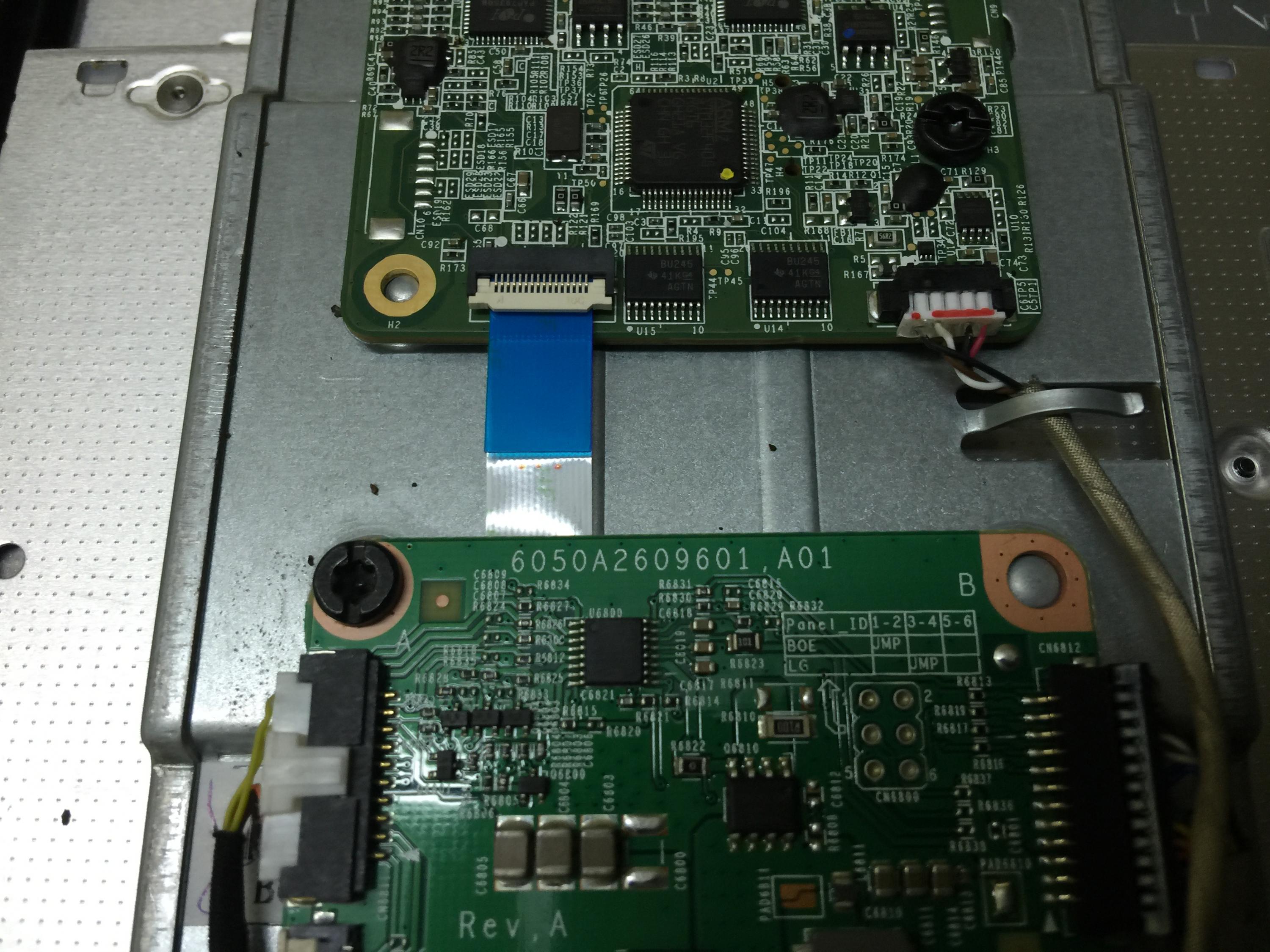

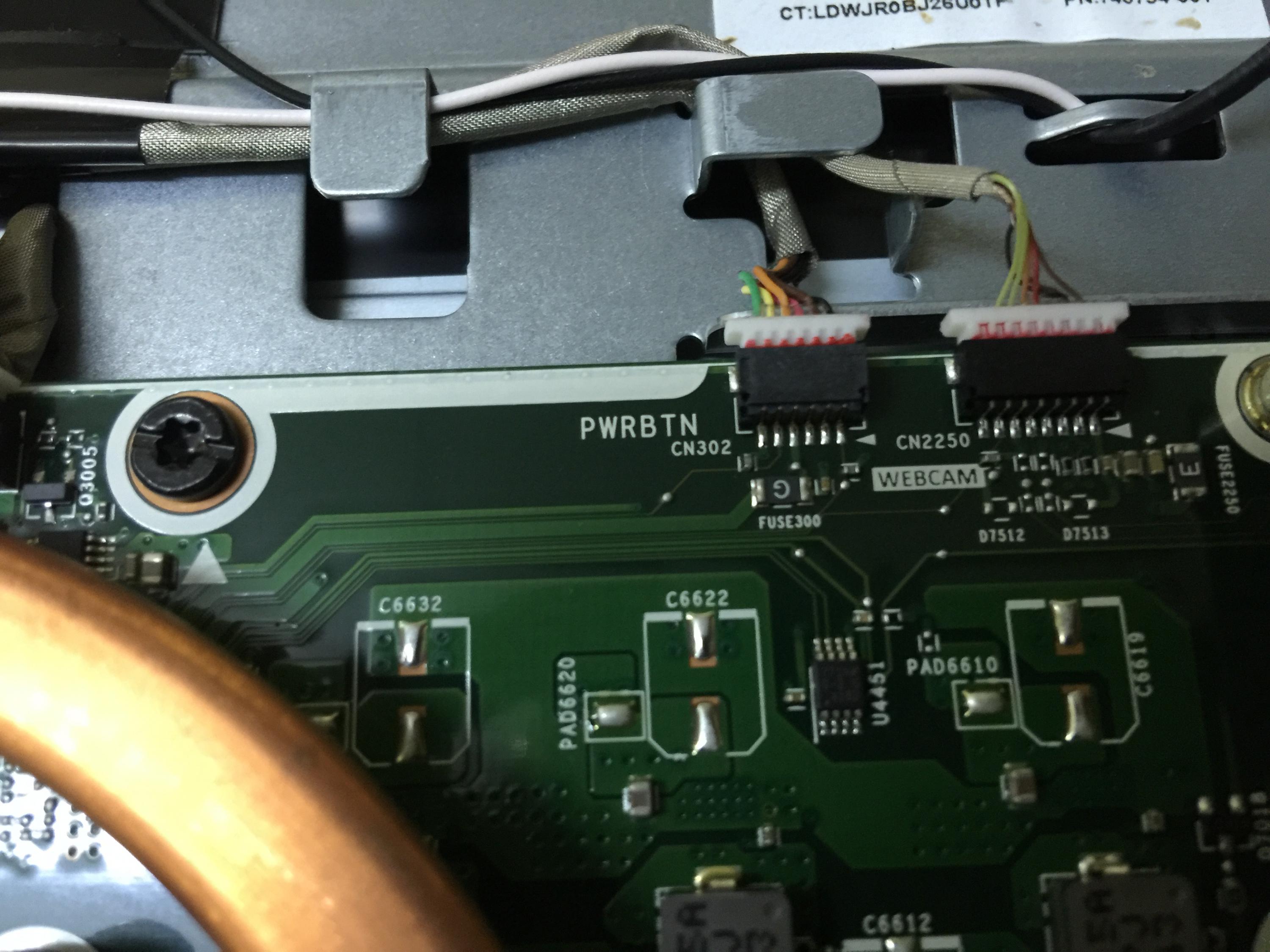

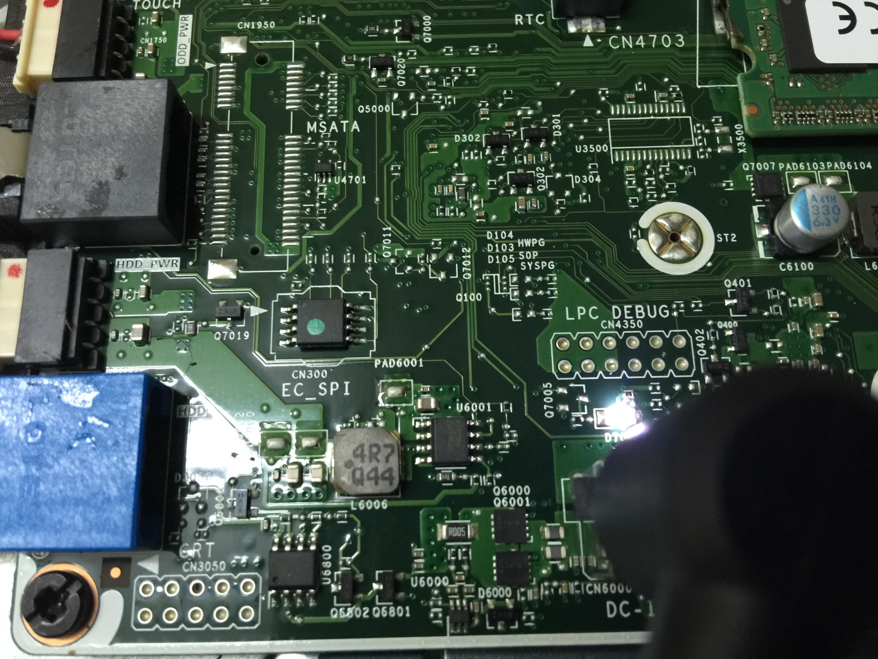

                  Re: HP Pavilion 23 All In One- No power up
                  Here are some pictures. Will try and get more sections up asap.

                      Here is an update. Power switch goes from 3.3v to 0 upon pressing power switch. U6001 which is a step down dc converter has input voltage but no output voltage. I assume this is supposed to be a 19v to 5v converter.

                          The step down converter is RT8299a. Sorry for not mentioning that.

                            Motherboard number is 6050A2585901-A01 if anyone can help. EC SP1 has 3.3v on 2 pins. Cant find 5v always on voltage.

                              I think the buck controller for 3.3v/5v using 24QFN from richtek. so, try to find 24QFN 4x4 with marking 20 or EQ.
                              I've found on hp 27" AIO (touchscreen, intel hasswell ) using RT8223m/p. with motherboard number Quanta NZ8. just my opinion...

                                  Your mobo is inventec not quanta, so it different.but in my experience, almost them has using 24QFN (richtek or TPS) for 3.3v/5v. Try start find it on your mobo.

                                    Have looked this motherboard over for the regulator and have not found it. The richtek regulator that I previously mentioned is the only one I see. Looks like it is tied to the 12v line. Need help on this.

                                        Appreciate your help meritosari. The SIO is an ITE IT8518E. Cant believe nobody has seen this machine. I have seen problems on 2 of them that I have done things on. It starts with not wanting to turn on to not turning on at all.
