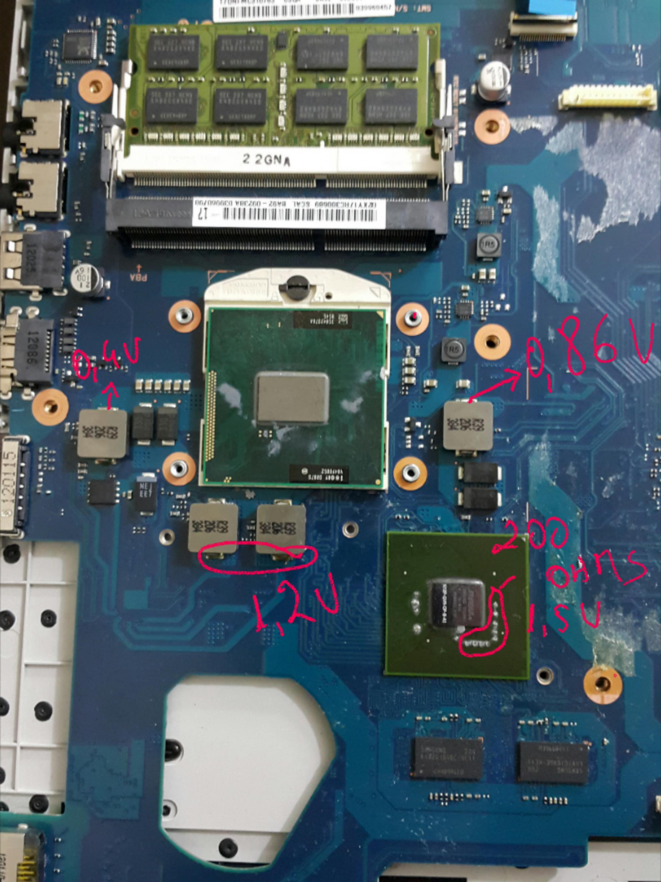

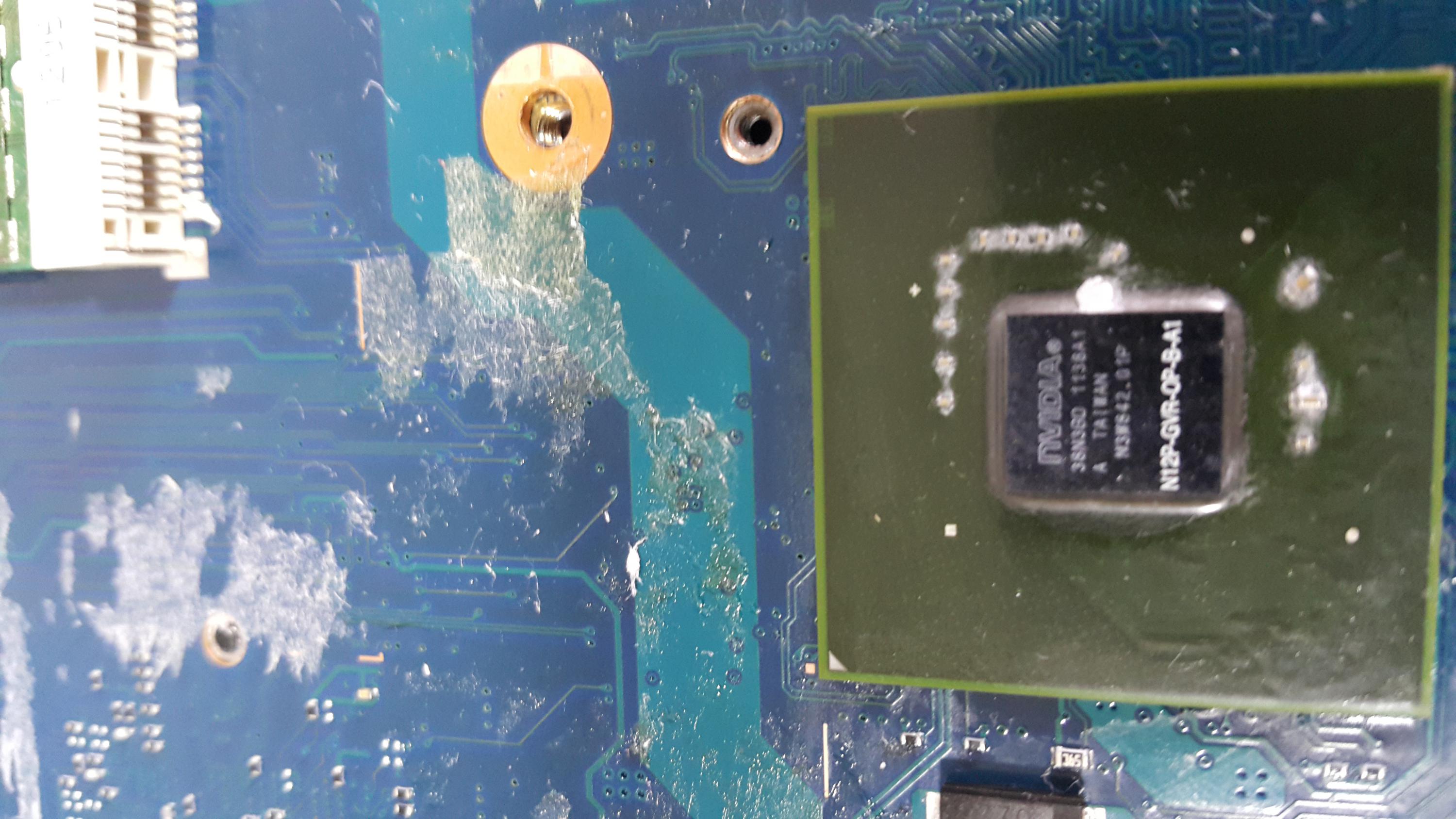

    I m working with this samsung turn on but no display .
    I flashed some bios but the same, REBALLED nvidia chip but no video again .
    Does anybody have the exact bios dump ?
    Any suggestion ?

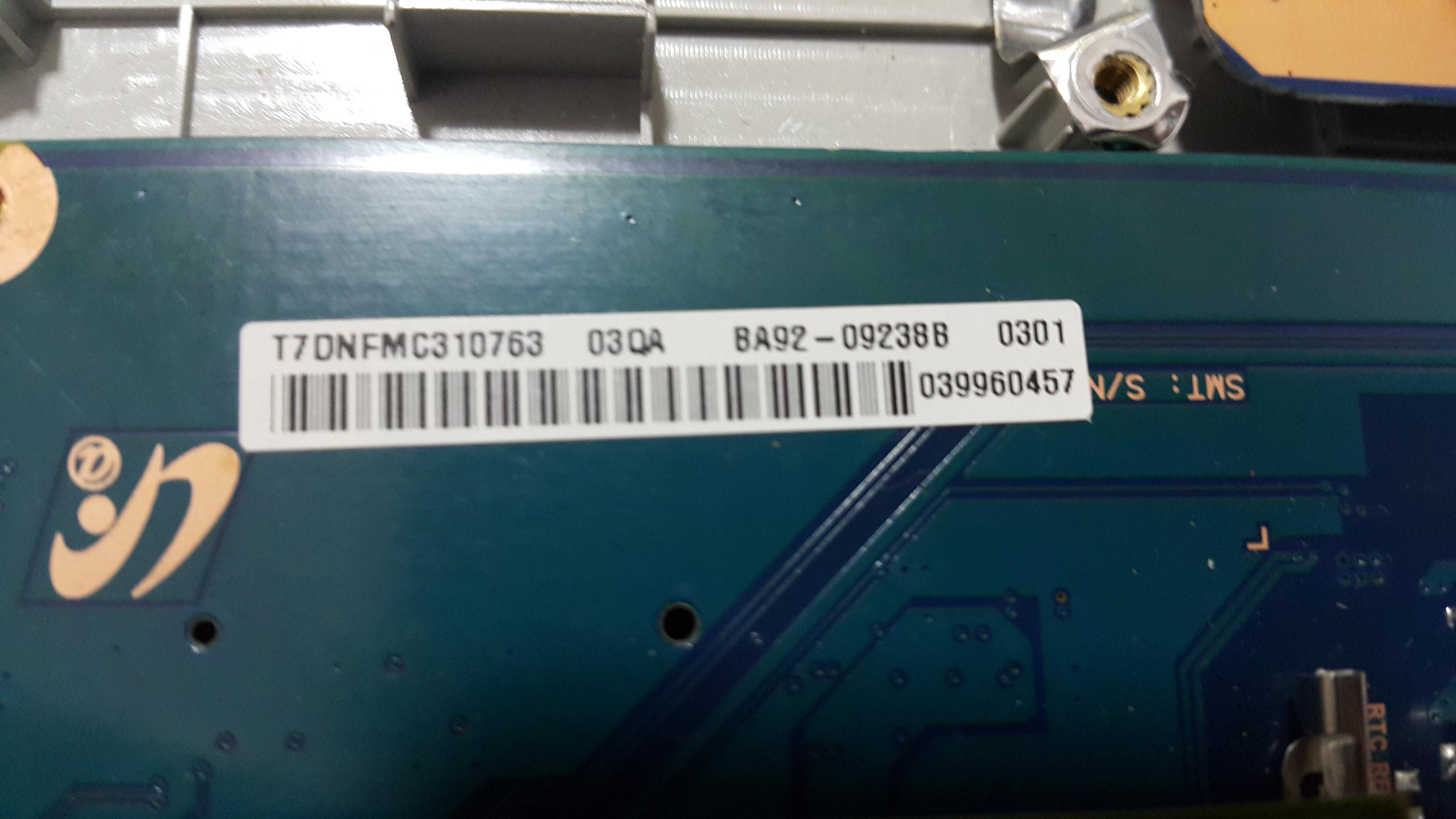

            Re: np300e7a-s06it No display
            Thanks for reply but my chip is 4mb ?
            My model of matherboard is BA41-01751A
            I try it 8m but not function?

                Thanks ala_borbe a tried it to flash but no change no screen , what is this dump LTN156..
                to flash screen ? i never see it, how can i use this dump and where is the chip for that dump (ltn156at19)?
                Also i tried another cpu no change.
                i attach pictures with current are present on coils.
                Please take a look .

                      today i removed power of Nvidia chip and can anybody modify my dump for discrete vga
                          i think this is not bios problem. maybe some signal did not available somewhere. is EC_pwr_good is oke?
                          • HarryPK
                            • Mar 2014
                            • 210
                            • barabai
                            check signal HWPG_1.5v or something like thats.
