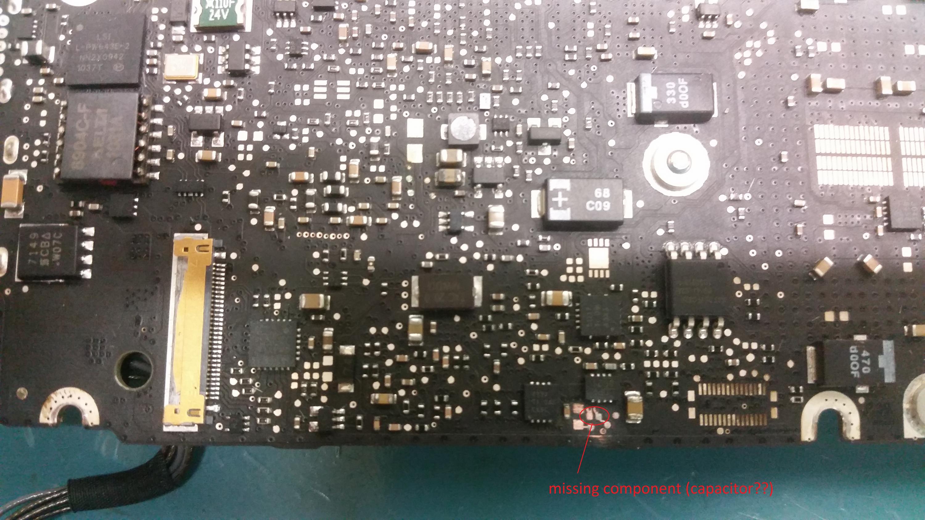

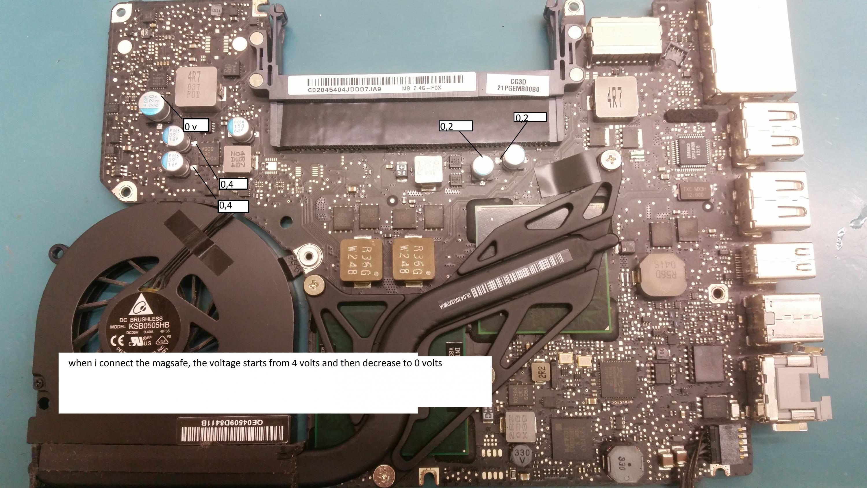

    Hi
    i have a macbook pro but it won't power on, only green light on magsafe.
    There was a small spot with water and i clean it, and a component in that spot is removed.
    See pictures for some measurements...

        Re: macbook pro A1278 - green light on magsafe - no power
        well right near the socket for the hdd cable there are 2 pins (smc_on_off ) if you merge the 3.42 g3hot pin with gnd chek if it does turn on
        • opethfan
          • Feb 2015
          • 81
          • Italia
          done, but still doesn't turn on
          • opethfan
            • Feb 2015
            • 81
            • Italia
            on smc on off there are 6.3 volts
              The component that is missing on your board is R6995. It's part of a voltage divider for the 3GHot supply. Missing that one might very well not enable the power rail for the SMC. (see https://www.badcaps.net/forum/showthread.php?t=42038 for schematic/boardview)
                i saw that R6995 is a 160 k resistor, can i put a similar like 150 k?
                • Th3_uN1Qu3
                  Believe in
                  • Jul 2010
                  • 6031
                  • Romania
                  That is a voltage divider so it may need accurate values. You can use 150k and 10k in series to get 160k.

                  • dellxps15
                    • Feb 2014
                    • 1598
                    • italy
                    1/16w
                    mf-lf
                    348k
                    1%
                    r6995
                    402
                    the bigger one near 0402 is :
                    R5001
                    OMIT
                    0
                    MF-LF
                    603
                    5%
                    1/10W
