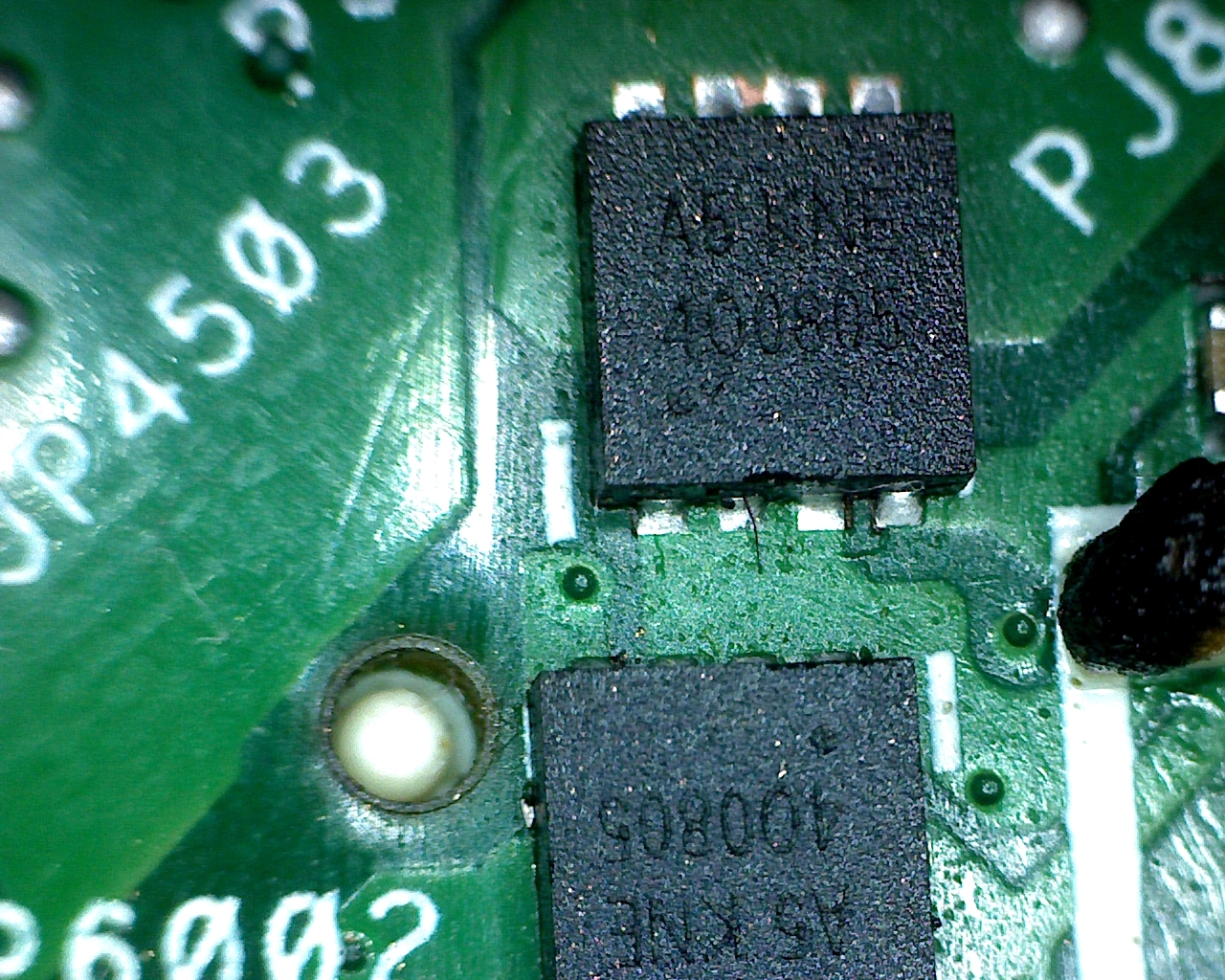

hi guys,
asus X55VD need schematic or compatible mosfet for A5kNE

AON7408 or FDMC8884

thanks for reply i have tried fdmc8884 but no succes

Reemplace by P0903BEA. There should be an N-Channel MOSFETs, such as P0903BEA.
Here is a schematics :
Mosfet P0903bea_r1.pdf

thank you for reply i will try this
