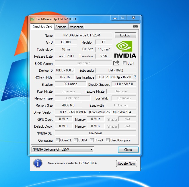

    Hi everyone!
    I have a problem with this graphics card..
    The original issue is: white picture on lcd. Changed the video IC, everything seems ok, but now I cant use this card, only the Intel HD grapics. Tried with new window, first Intel driver than the Nvidia, but in the device manager the GT525 appears with yellow exclamation mark. Furmark doesnt see this card.. I replaced the IC again, but nothing changed. Power is OK, PCH also, its a new one. Anybody have idea?

    Re: Dell N5110 Nvidia issue
    Try to flash bios
      Im over it. with elnec programmer, and winflash too, several content..
        try this one
        if its bios problem, this one will solve it
          Thank you ala_borbe!
          Unfortunatelly its not bios issue
          I just tried this file but nothing changed.
            Did you checked U4901 ( 5 Pin Small chip ) G5285T11U. It should show the power on pin 3 ( 3.3V ). If you are not find it you can jumper to Pin3 to Pin 4 ( This is not permanent solution but you can use it for long)
