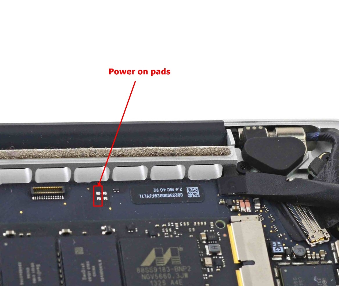

    hi.. i have a mac air 1502 .
    its not powering on.
    i don't have another keyboard to check the power switch is there any way to power it on by shorting circuit.

    Re: macbook air 1502 not on
    does anyone have a schematic diagram.
    i managed to power it on but no display. the processor is getting little warm, with a core volt of 0.98v . fan not working.
      To start it you short the 2 pins on the picture.
      Regards
      Robert
