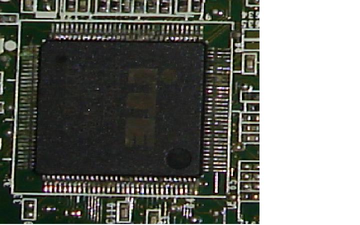

            Re: HP Touchscreen 610 no boot after power surge
            what about kbc did you replace it ?
            from the image it look some water was reached it
              no way with this
                  Ok, i think that i was able to extract the rom file, but if i compare the saved file from the bios and the hp rom file, they don't match at all.
                  @looofy, no liquid on mobo, but the pc was stored on humid garage for a year.

                              #34
                              lift up that KBC.
                              clean the contacts and resolder it back.
                              100% sure that some contacts are gone. in that case you have to rewire all of them.
                              done a hp 15 series last week. same problem Liquid and no power. had to solder 5 wires to remake the trace

                                #35
                                Originally posted by dj_ricoh
                                lift up that KBC.
                                Agree that some legs don't look good!
                                this is a all in one desktop pc, and to put liquid inside you need to dive into the liquid, and this is not a easy task
                                I will try first the bios fix, if not work I will replace this chip.

                                    #37
                                    humidity for long time = direct liquid
                                    just start from the KBC
