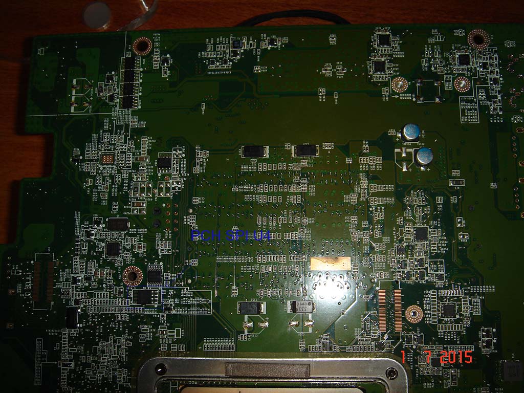

    Hello to all,
    I've bought this HP 610 series that don't boot after a storm power surge (what the previous owner said).
    I have 3 PSU's, they are tested on others HP laptops, they all work.
    The symptoms are:
    When I press the ON switch, the power led turns ON, but fan don't spin and GPU, CPU stay Cold, there is no really power running I thing.
    I have made some measures, I have 3.3V, 5V and 19V on some points.
    I didn't find any schematic for free, only pay ones, I'm not engineer and have basic electric knowledge.
    Motherboard reference :
    HP ZN9
    DA0ZN9MB6H0 Rev.H
    I can post High resolutions pictures if asked.
    Any help will be appreciated

    You can check if voltage s present on the bios chip, if so you can flash the bios with programmer.

                There are at least two spi roms, U4 for PCH and U6,U7 for KBC. You need to check and flash all of them.
                Post high resolution pictures of both sides of the board.

                      @atsio, here some pictures, if you need more detailed photos (from a specific zone), let me know I will use my usb microscope.
                      I still didn't located the Bios chip

                          Re: HP Touchscreen 610 no boot after power surge
                            Originally posted by atsio
                            And PCH spi
                            I don't understand your picture, there is not a chip near what you wrote.
                              Sorry reduced original resolution and the blue arrow with the blue box around U4 doesn't show (left and down of PCH SPI logo I wrote on picture)

                                I have found 2 winbond chips, make some measures on both chips on standby and after pressing the ON switch, values stay the same.
