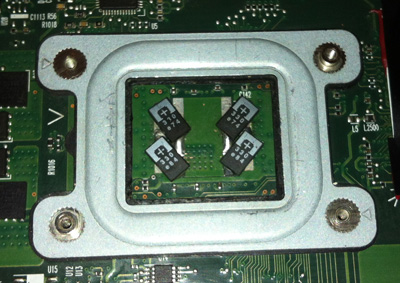

      i don t have nectokin ,but it s ok to using 4x SMD Tantalum Capacitors 330uf
      • Ramee
        • Jul 2014
        • 218
        • Israel
        Re: satellite A300 not charge
        like this

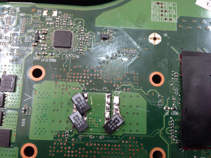

          to remove tokin with knife is terrible . anyway removed it (TOKIN 0E907)and replaced with
          3x330 which i removed from a scrap bord measured it OK.
          The same problem not charge , flashed bios , changed CPU , removed graphic card , i found the voltage battery 3v is low changed it , after i checked the bios voltage and i found that not have 3,3v.
          What do you think ??????????????????????????????

            remove tokin with knife???
            u dont have hot air?

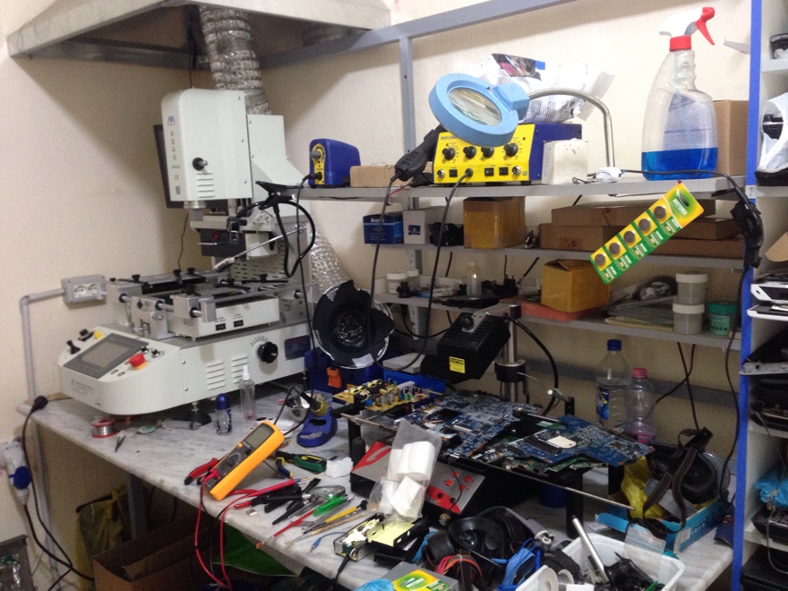

              HAKO fx888 with knife i though the hotair can damage the socket of cpu .
              EQUIPMENTS:
              Jovy re7500
              Zhuomao zm-r6200
              Hakko fx888
              Chinese Bakku 603D
              Honton 1212
              etc......

                    nice workplace but no workspace.
                    • gcomputers
                      • Apr 2013
                      • 509
                      • Albania
                      You are right no workspace i have much work , i don t have time for fixing it.
