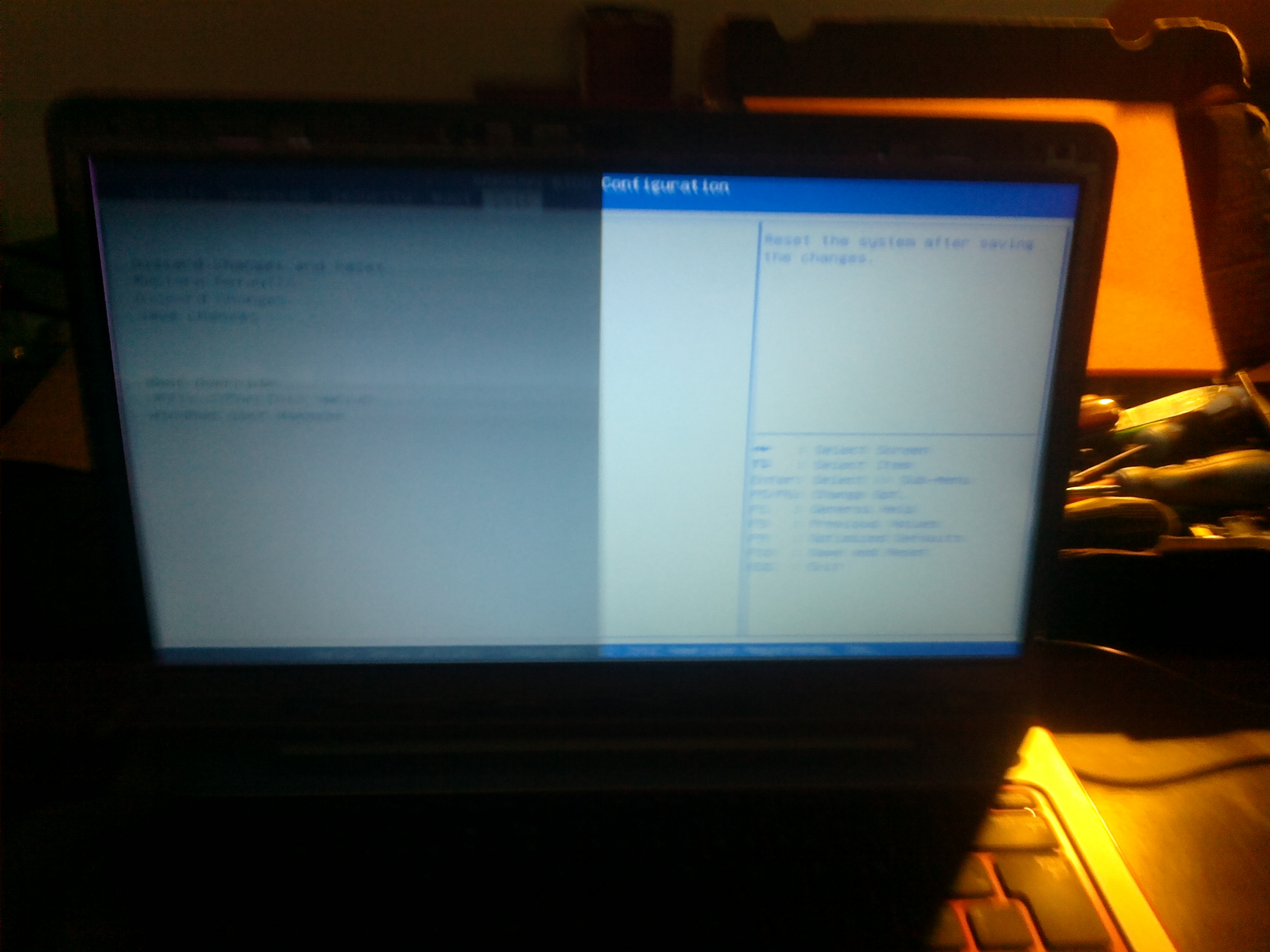

    i have ultrabook Samsung 535u3c. On this ultrabook is half of the screen OK, but left side of screen shoving bad colors and completly blured image.
    The left side of the LCD is visibly slower, when I restart and go to Bios, burned desktop si still visible on the left.
    My question: Is this problem caused by faulty LCD screen, or only faulty LVDS cable?? I measured LVDS and 2 pins are not connected.

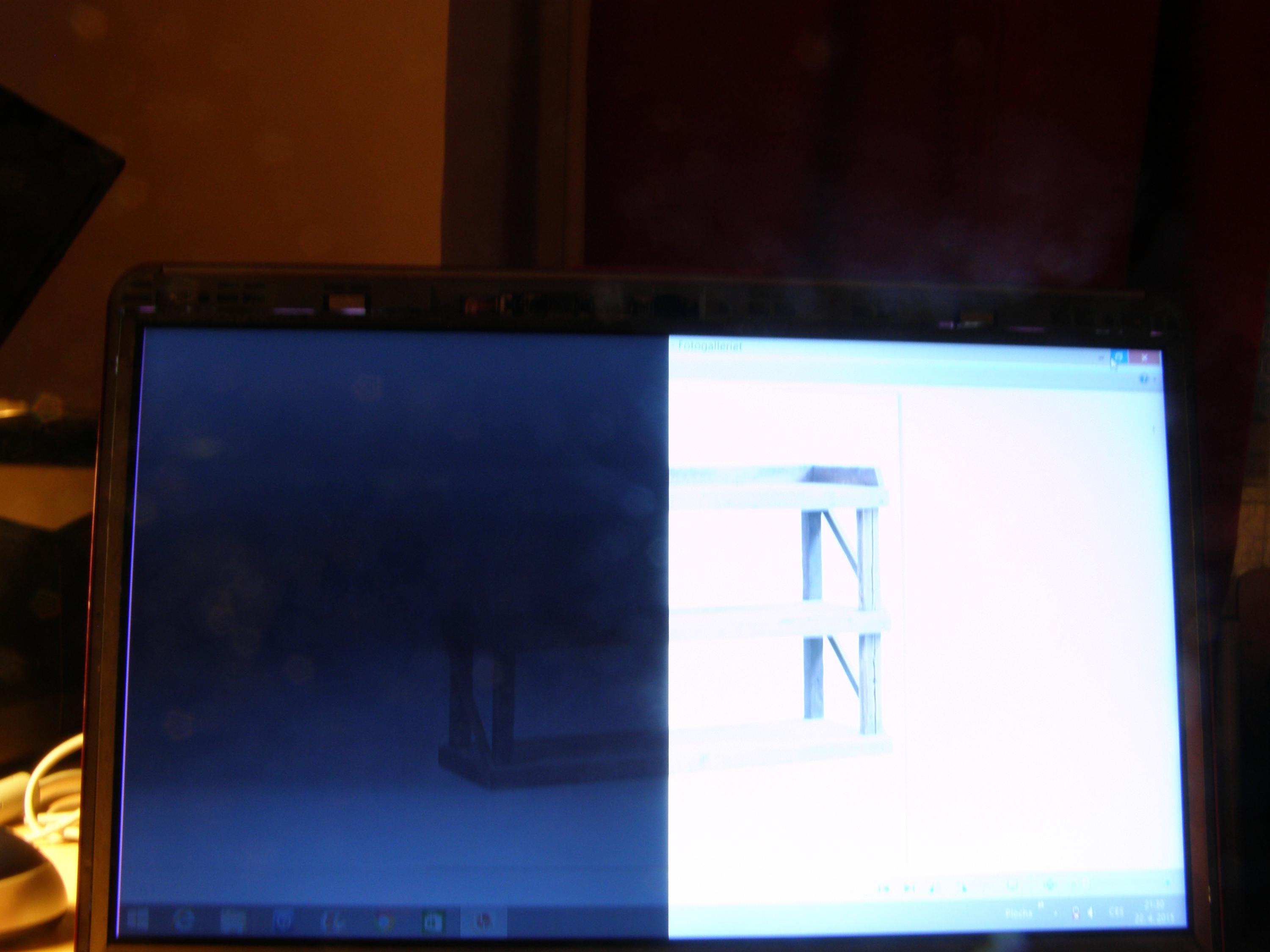

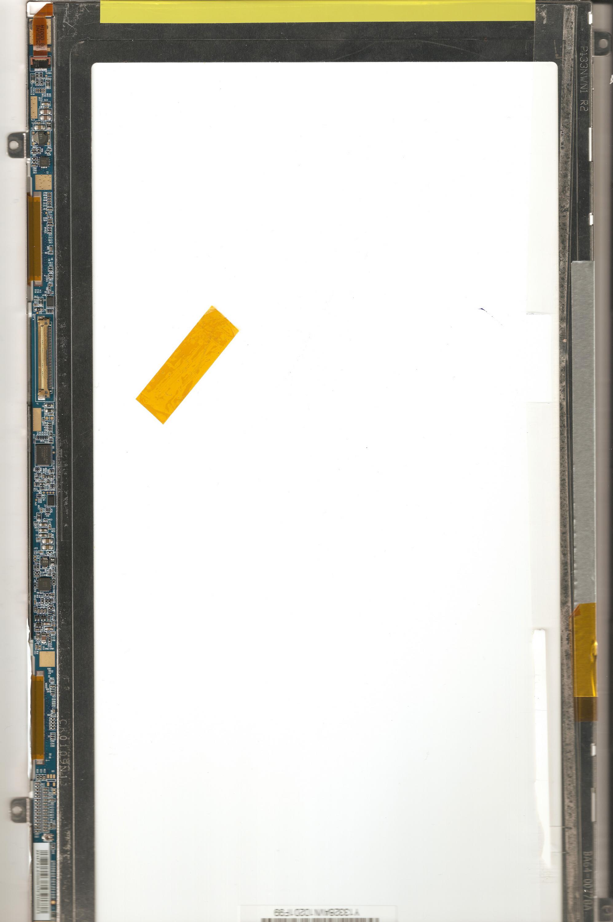

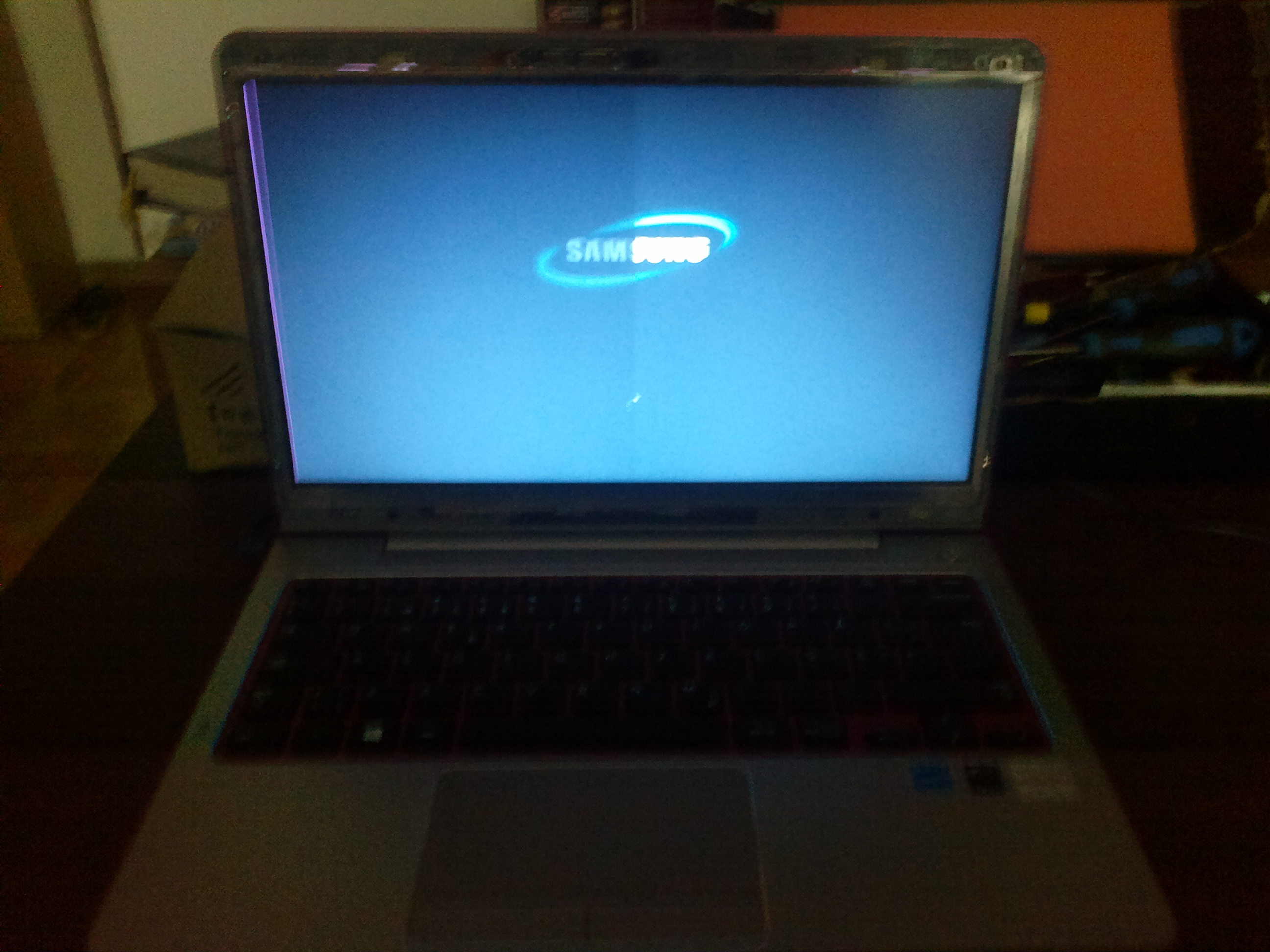

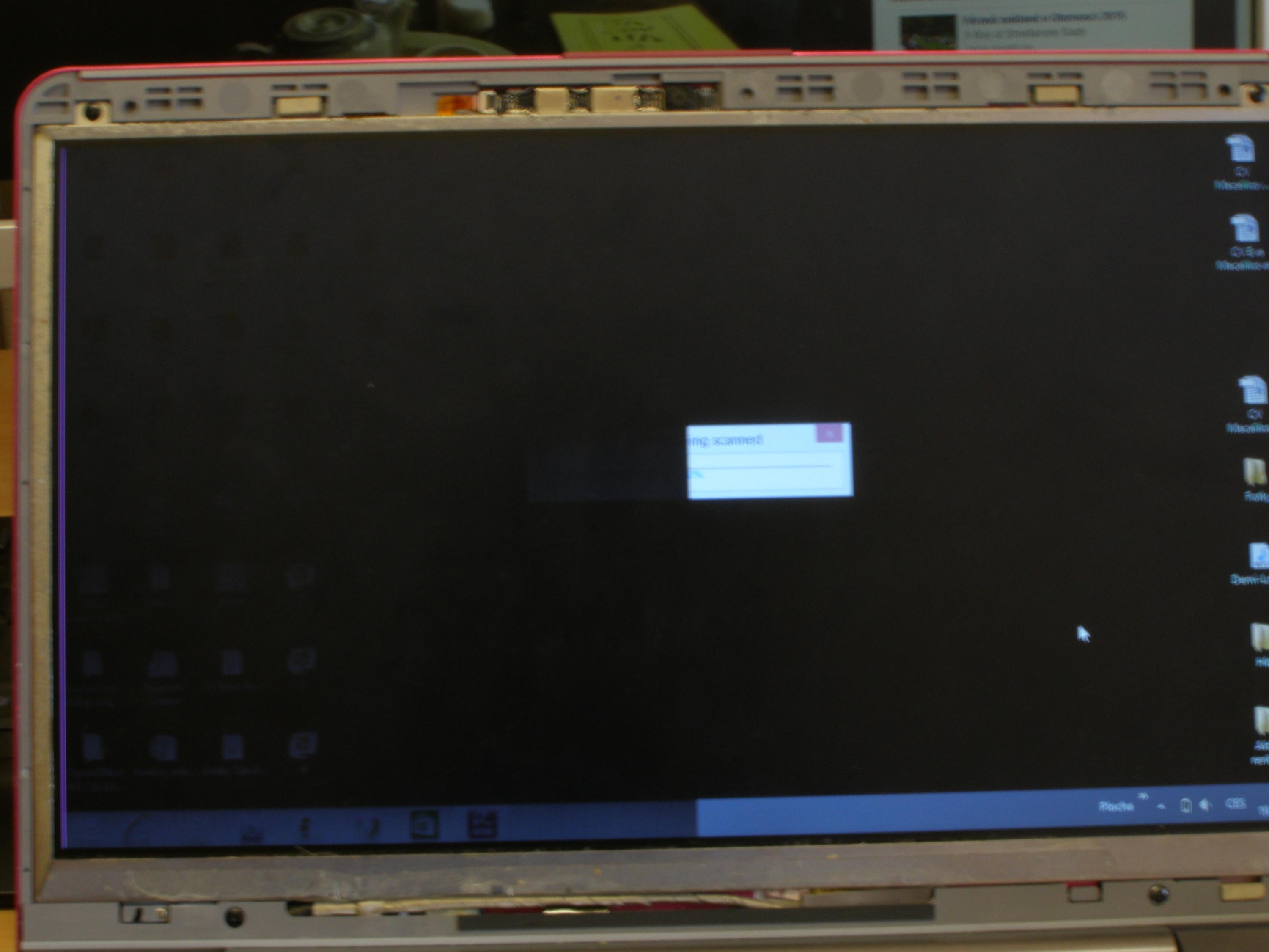

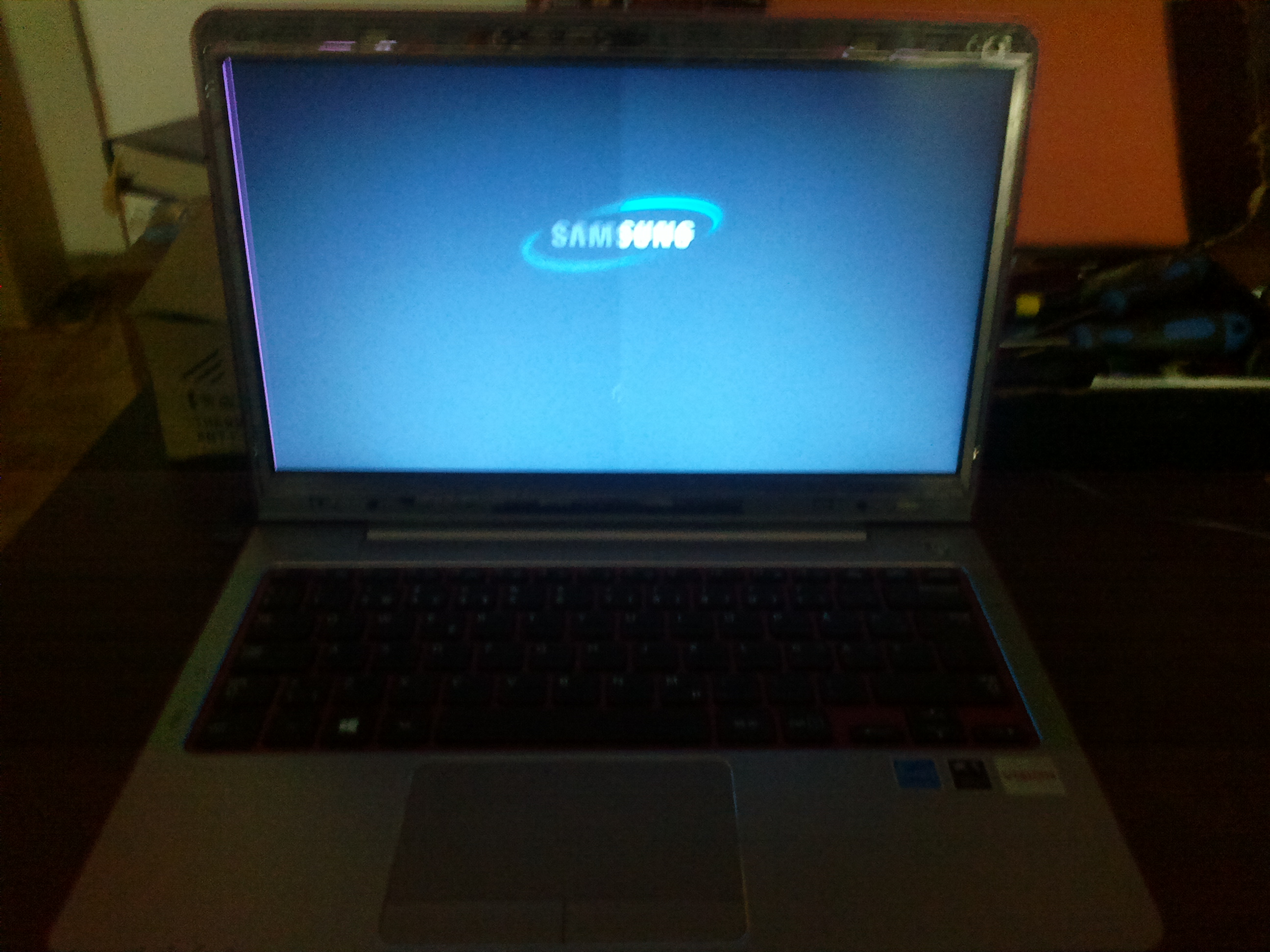

    Here is another photos of LCD.
    Can someone help me please?

      The vertical line to the left of the screen is making me think bad LCD but not 100% sure... Sure someone else will chime in too

            Bad LCD. LVDS cable cannot cause this fault as the LVDS signals address the screen as a whole.
