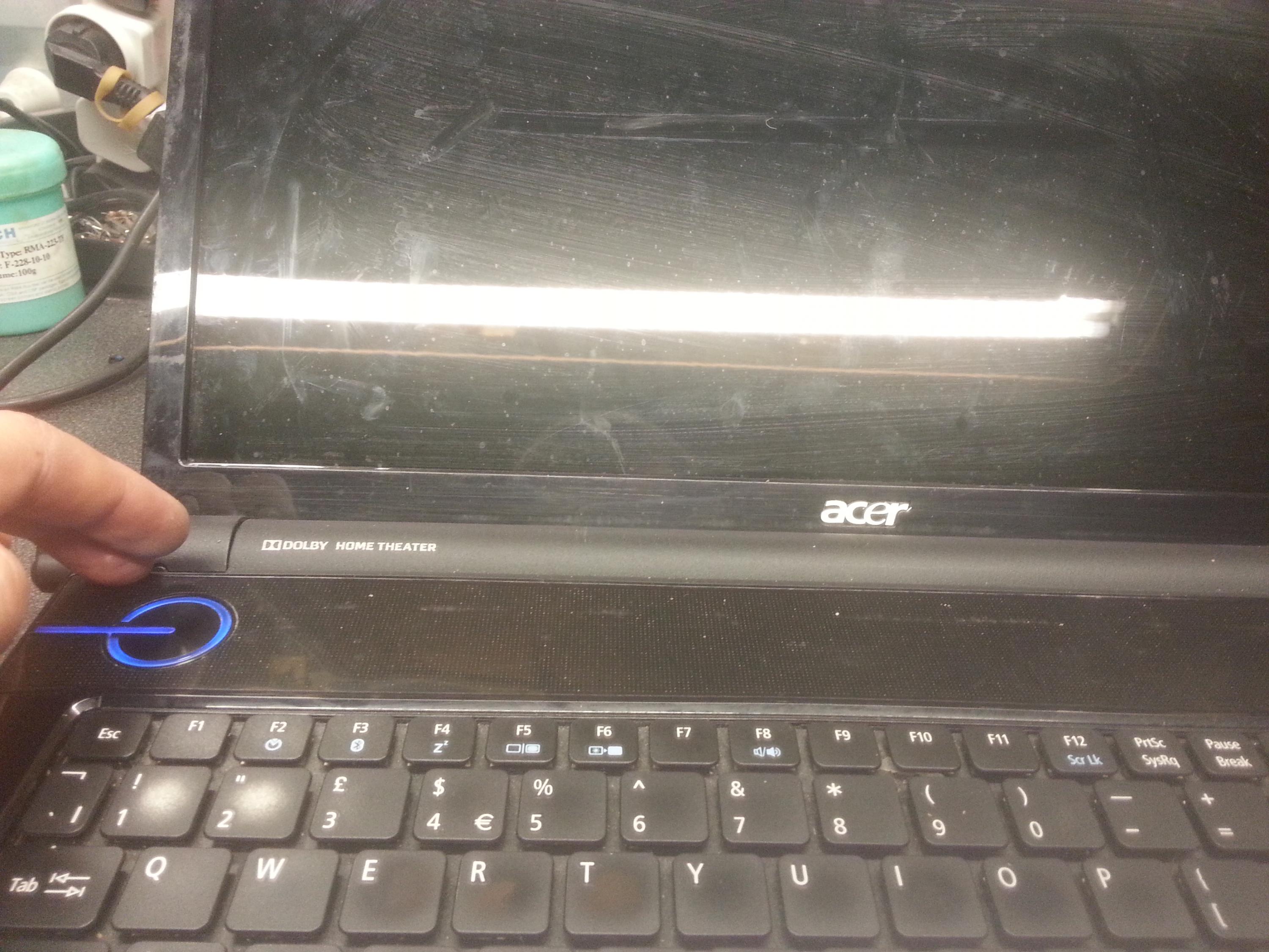

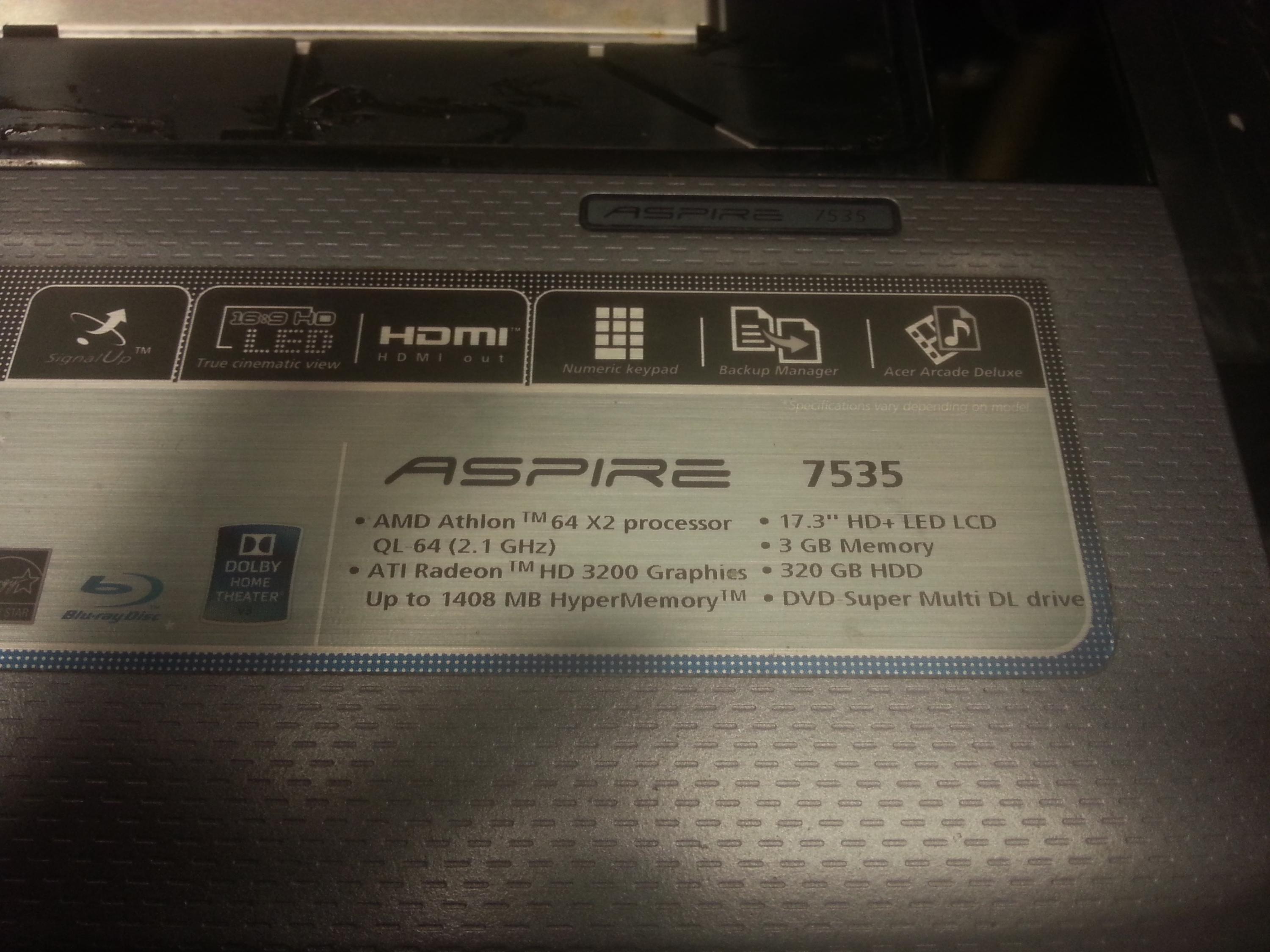

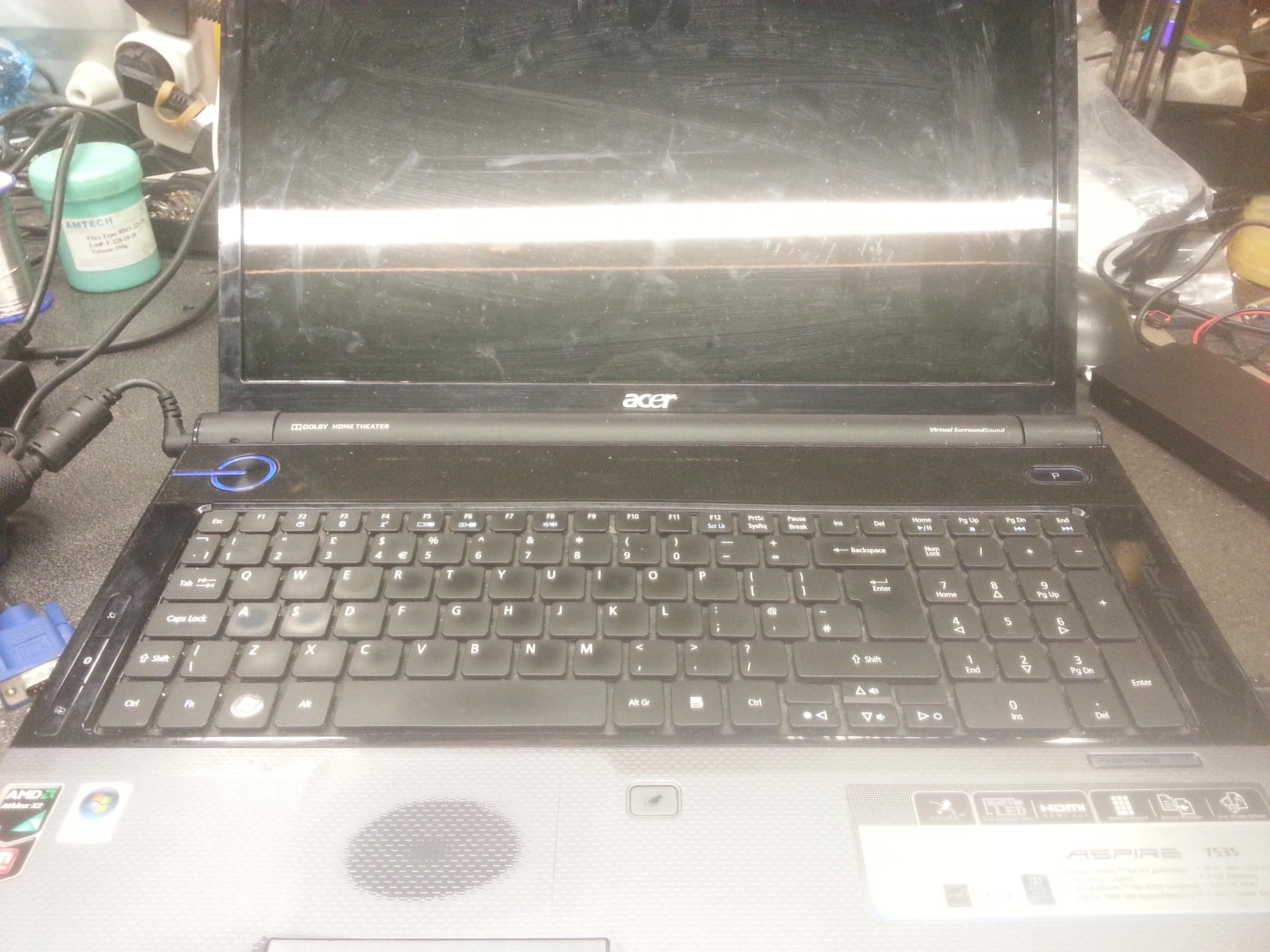

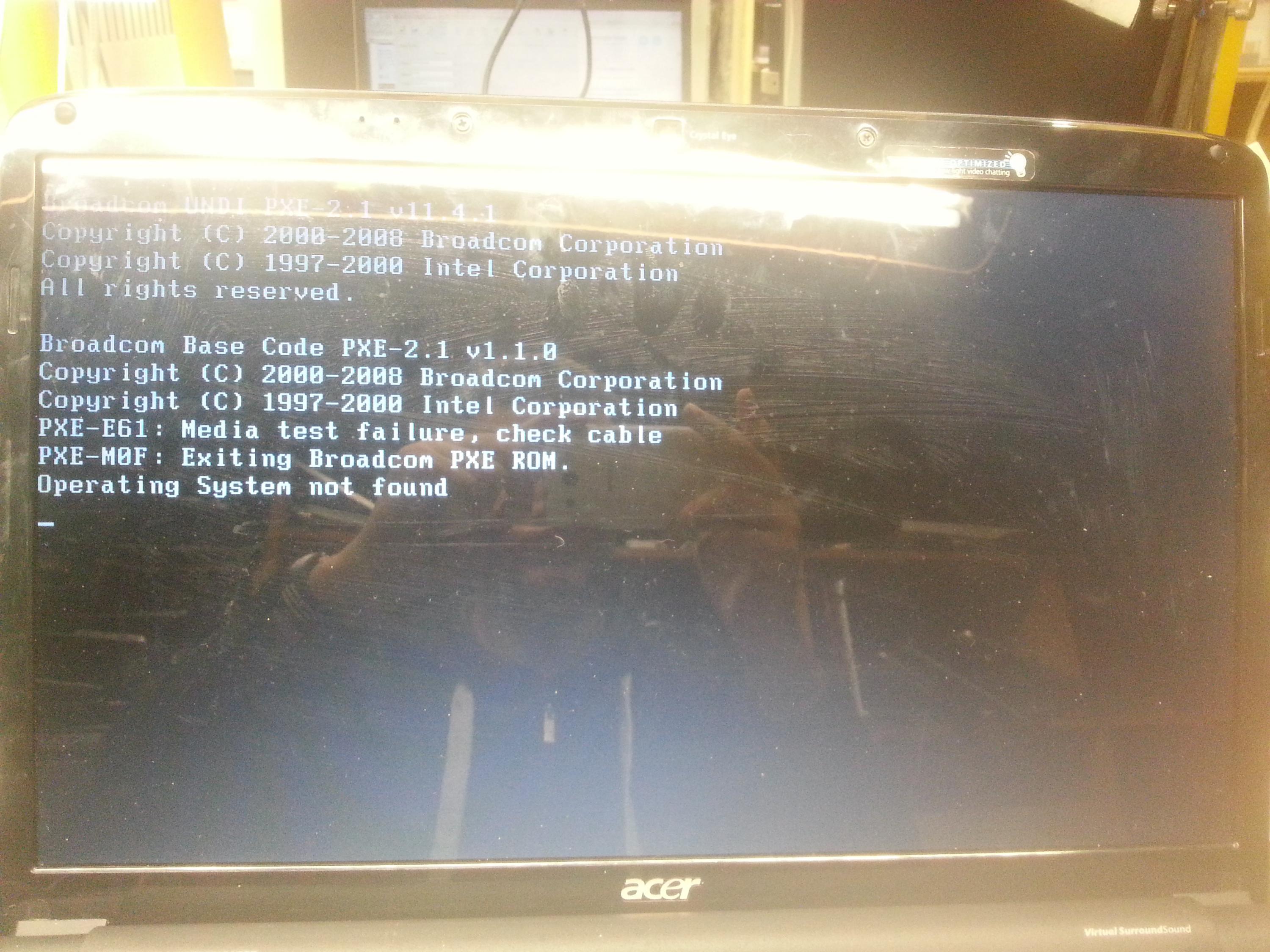

                              Re: acer aspire 7520 black screen
                              Aspire 7535 no display.
                              Bios battery was flat

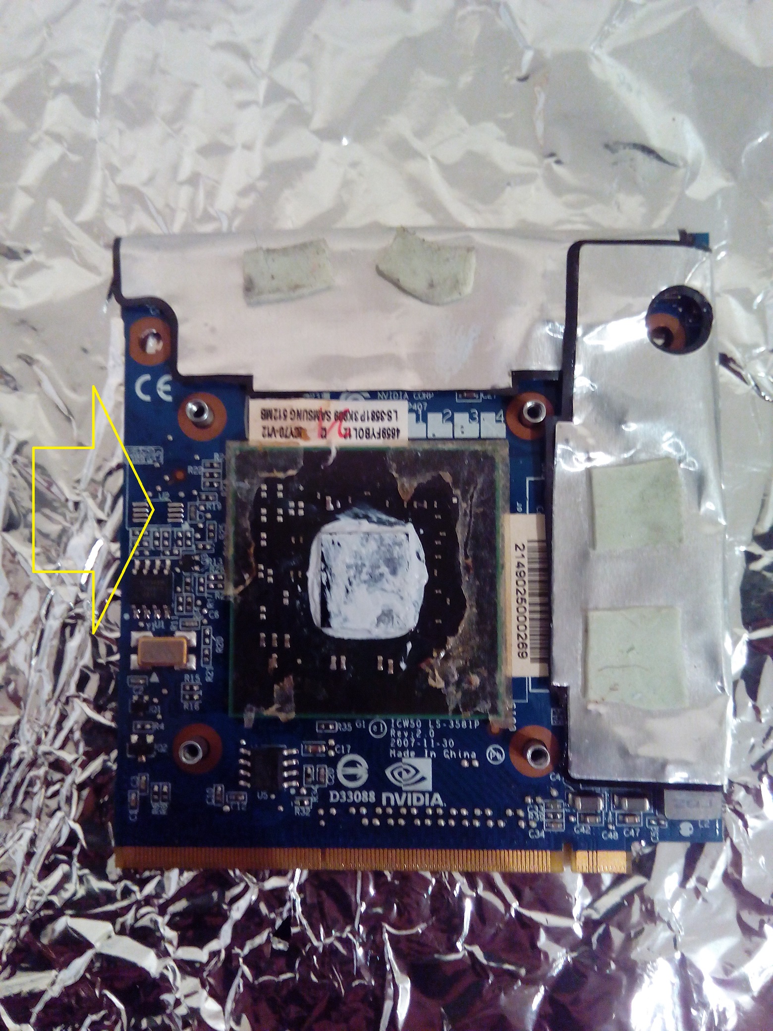

                                      hi friend sorry for tardive response i receive the computer and i took some picture
                                      but i find something strange on gpu and it s a nvidia the strange thing is there is one smd left on gpu check the picture please and all advice are welkom is it maybe the reason tha t i have black screen ....
