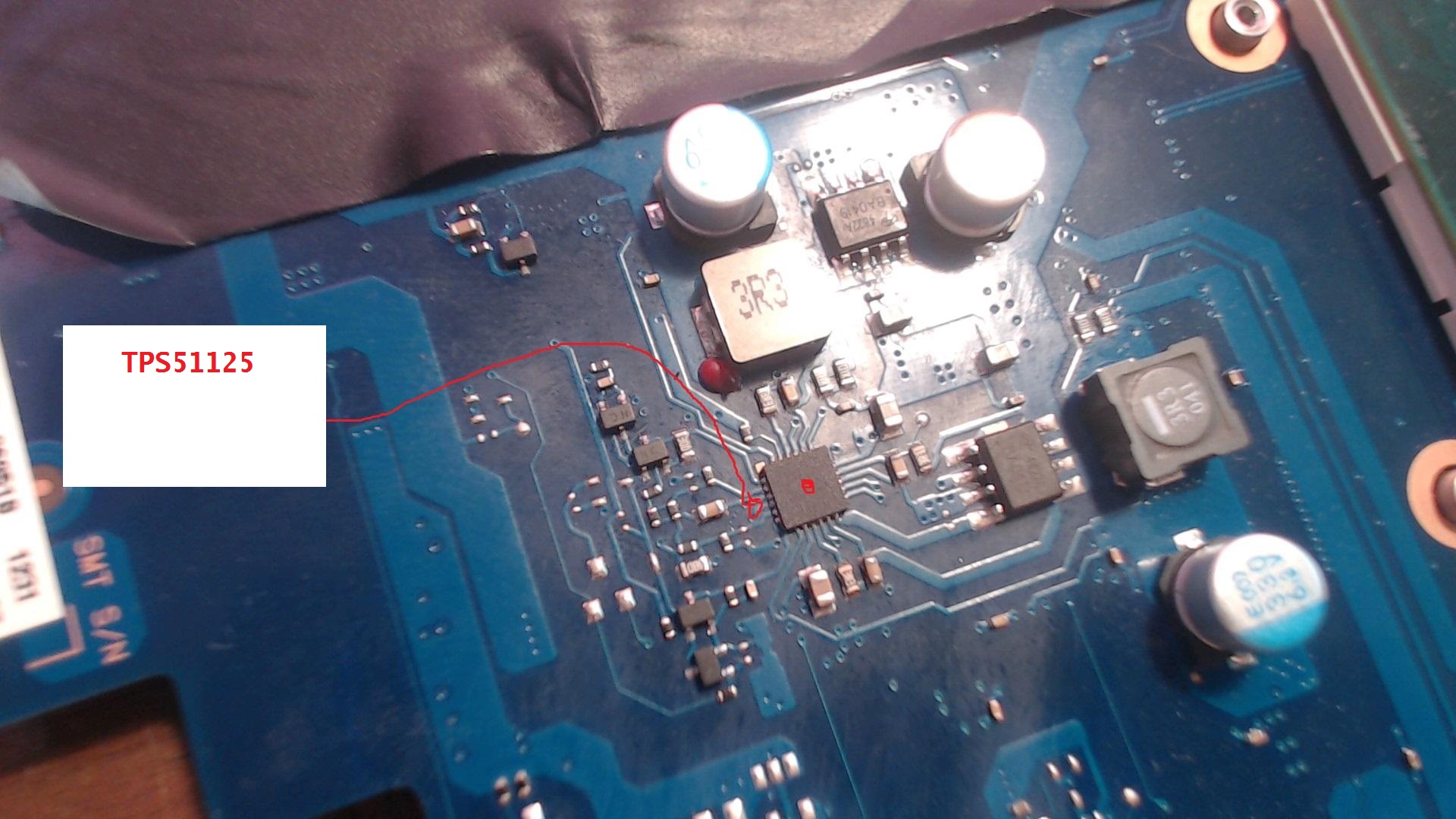

    HI Guys i have been working on a samsung NP-RV410L that doesnt power up, so using power supply i found something that gets very hot, TPS51125,that chip controls 5 and 3 v always, so i change that chip for the same printed number and it keep getting hot, what can it be.
    tps51125
    VIN-17.94v
    EN- 1.29v
    VREG5-5v
    VREG3-0.83v
    ref-2v
    TONSEL-0.82v
    SKIPSEL-2v

    Re: samsung NP-RV410L that doesnt power up
    Vreg3 its 3.3v alw
    You got short there
      HI, i already measure, pin VREG3, to ground and nothing beeps,on the multimeter, how to know where to measure ???

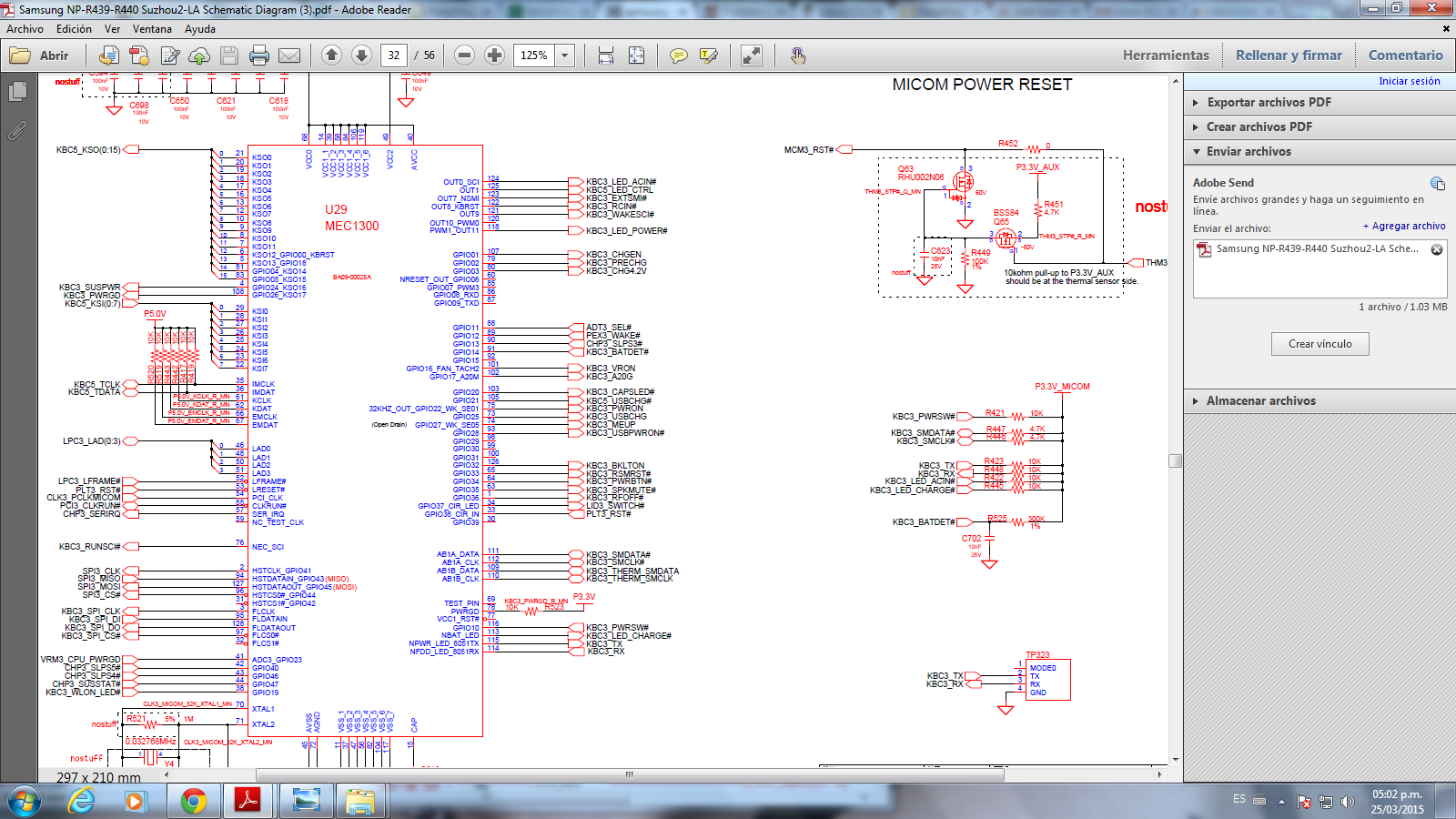

        Check KBC.
          this is is KBC pins, which pins should i measure.
            also check the BIOS. it gets 3.3v from VREG3.

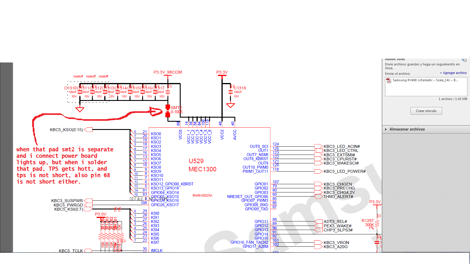

              HI guys well i think i found something, that probably someone can tell me if smsc is short, when i power up motherboard if you see the smt2 is a small solder look at that pic please, when is joing into one motherboard doesnt power up, but when i separate that small solder, motherboard lights up, i measure that pin 68, and is good nothing short, i cant find those capasitors , because this board doesnt have anything print in it. i forgot one thing when i power up board with that solder joing, TPS gets hot, is like smsc send a voltage to enable and make TPS hot, TPS is not short.
              so you guys think something wrong with SMSC.
                check mosfets & capacitors close to TPS51125. more than likely one is shorted on VREG3
