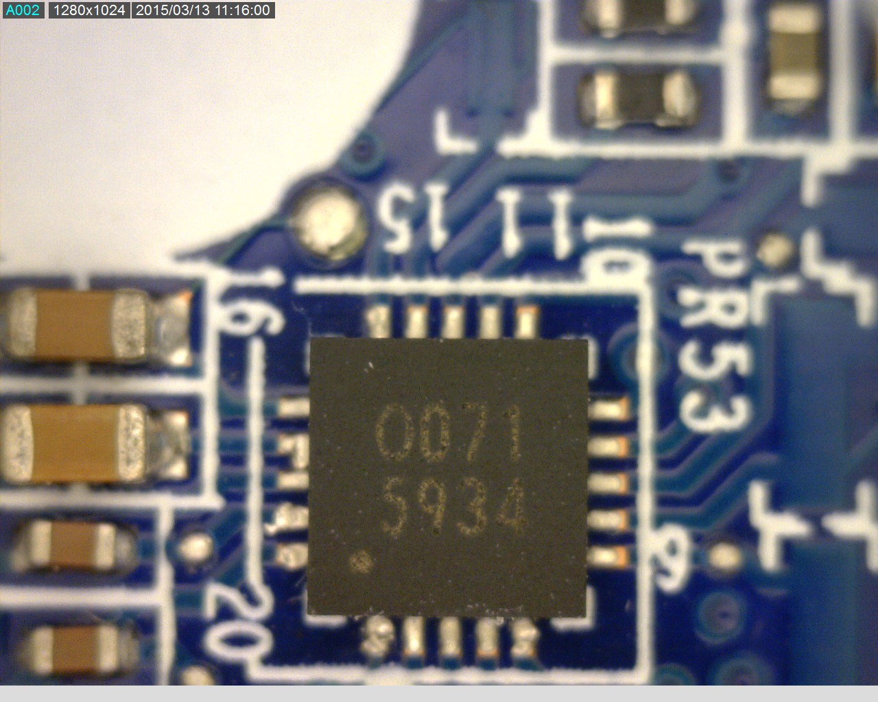

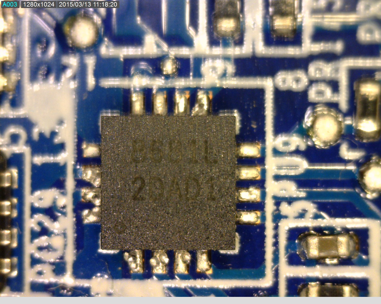

    I need help finding these parts I have included images of the chips.

    Mainboard code Nr. or??
    Its maybee a MCP73871 Battery Charge Management controller
    you need a Schematic

      Re: Need help finding parts
      I found a schematic and it had the following numbers.
      Picture one PU3
      (RT8223)
      Picture two PU2
      (P2806)
      Picture three PU9
      (OZ8681)

        just had a nose on ebay, they are all there, just type ic rt8223 etc
          [QUOTE=electrobe;540110]I found a schematic and it had the following numbers.
          Picture one PU3
          (RT8223) or TPS 51123.
