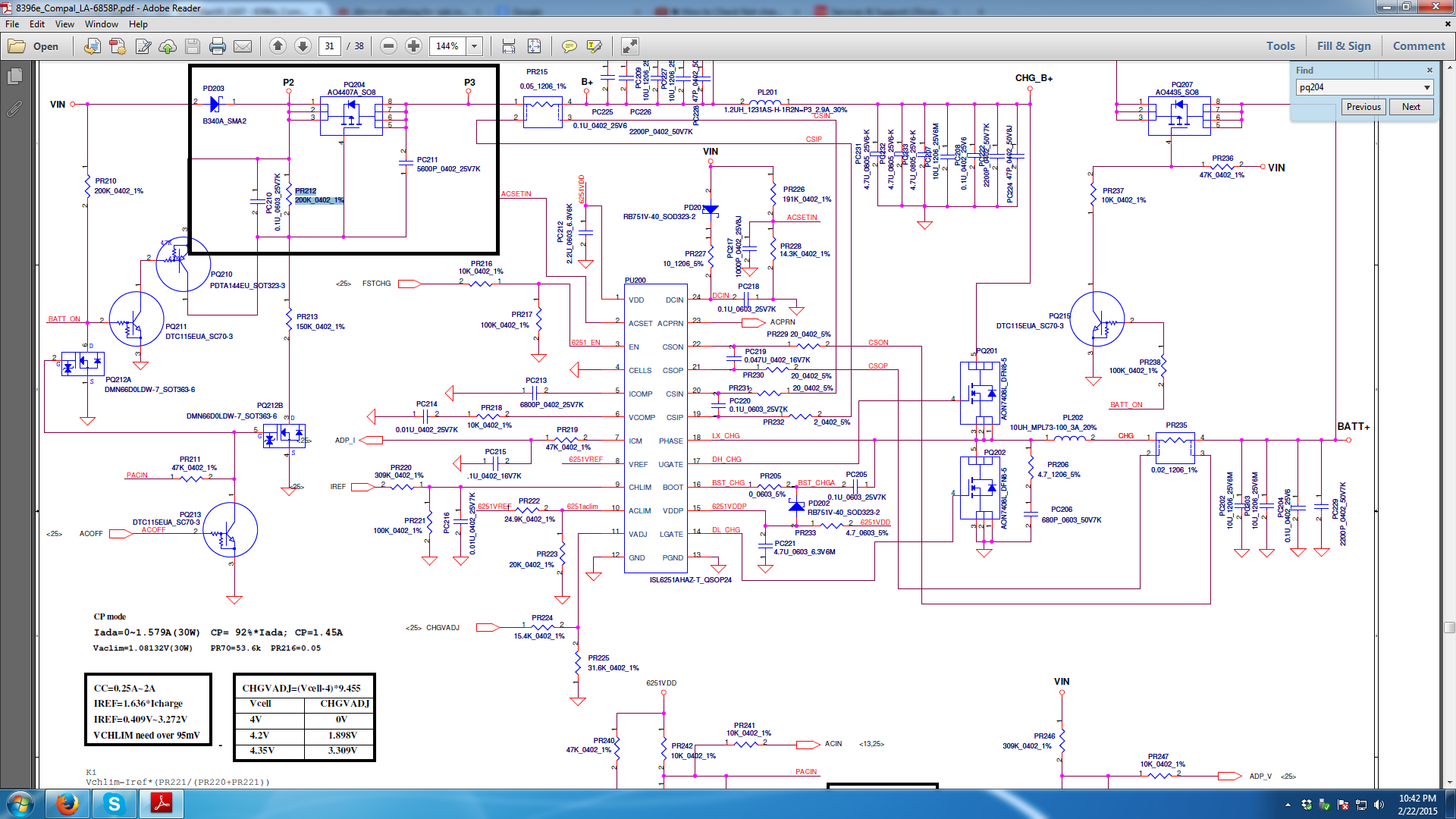

    hye i have problem with this netbook toshiba nb520
    already measure bios ic but no voltage
    3v and 5 v also not coming.
    what i do fisrt update bios
    then check page 31 and found PQ204 pin 1,2,3,4 got 19v but no volt on 6,7,8
    i do inject 19v on pin 678 and i see the adjustable PSU im using got current 0.0125A before inject only 0.0008. so can i try jumper the pin 19v ? still not working
    i didnt see PR212 where i suspect is culprit
    then i also check 3v and 5 v on Q18,Q19,Q20 no present see page 28
    no volt on Q18,Q19 & Q20

      DCIN detector on page 28 point PJ332 no 3v PJ352 no 5V

        already check PU200 ISL6521 i have checked pin 24 which DCIN i got no voltage, then i try measure PD201.
        both side should be 19v but only one side 19v other right side i got 00.25. are this culprit coz i check in resistor mode no reading at all

          Yes finally i solved the problem. the resistor is culprit. admin please closed my case.
