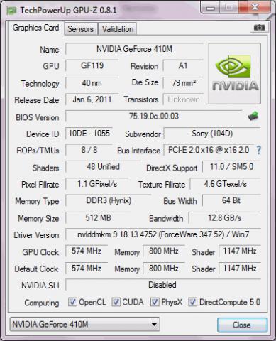

      Re: Sony VPCEH35EN: No Video in LCD but VGA Works
      can anyone guide me to check the lvds port and voltage level.
      GPUZ Screenshot is in external monitor (VGA)
