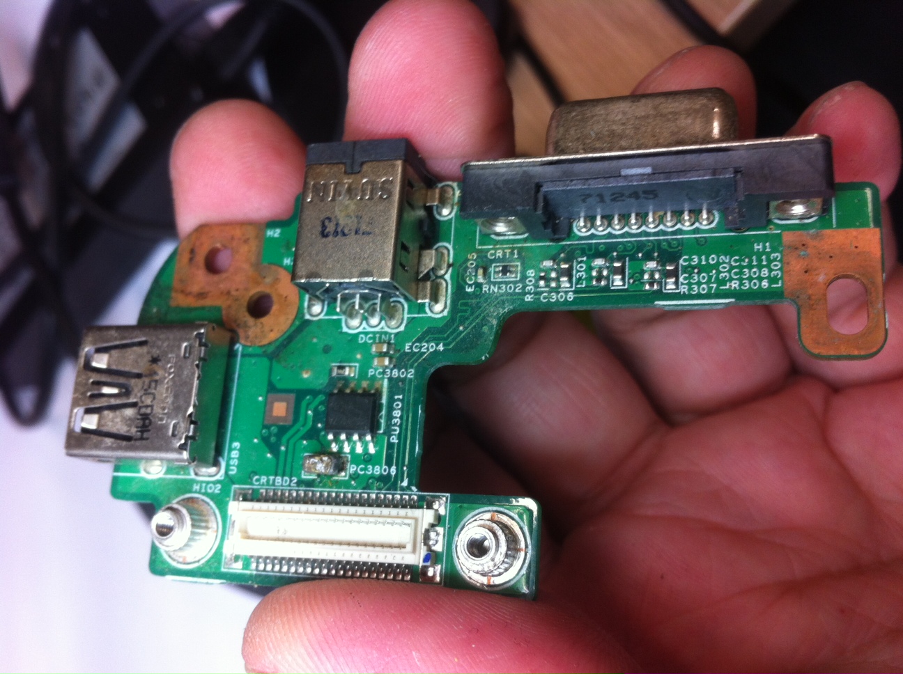

    Dell inspiron N5110 is not power up, i found that the capacitor PC3806 has burnout, do you know the specs of this capacitor?
    I have download the schematic but is not the same because i can't find this capacitor. Can you help?

    could not find it either...you could put 10u 25v as it is found on many similar dell laptop`s...even without capacitor should work...just take it off to remove the short...
