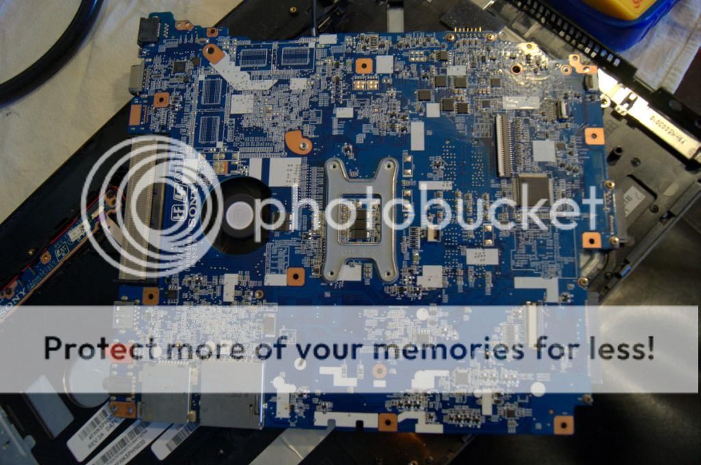

    Hi have sony vaio e series .When attach power adapter fan start and power light on the bottom .And thats all, power switch no lights and when pressed button nothing happens ,the motherboard is mbx269 any suggestion is appreciate .Im not expert but can read voltage and if anyone can point me where to start thx

    If you have ALWON voltage 3/5 with just adapter plugged in with out press power button ..the i would start with reflashing bios ...you will need a programmer and pull the SPI 8 PIN CHIP to do so back up original file then reflash it with mine...if it start i will rebuild the ME REGION for you is a must. plug adapter in a probe around all them big square coils only two of them will have power with just adapter in ...if not start with ALWON voltage two main mosfets h-l and buck controller.

      Hi thx for replay I was change bios chip from another motherboard same one mbx269 and still same,I check the power on bios chip and reading is very low like no power at all .Can u point me where to start to check voltage and which mofset you mentioned in previous post thx

        trace that 3.3v on that bios
