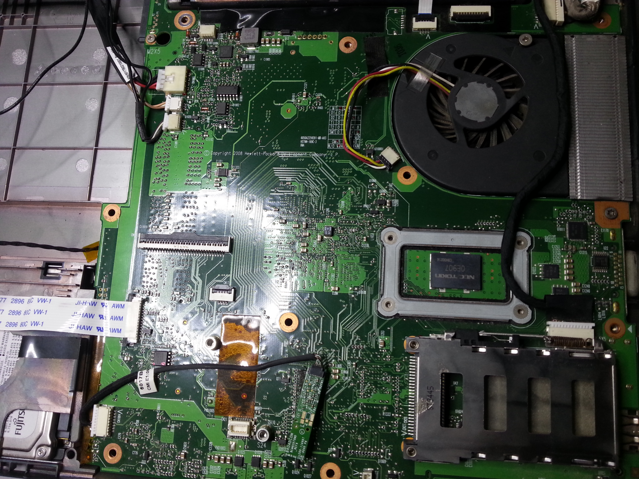

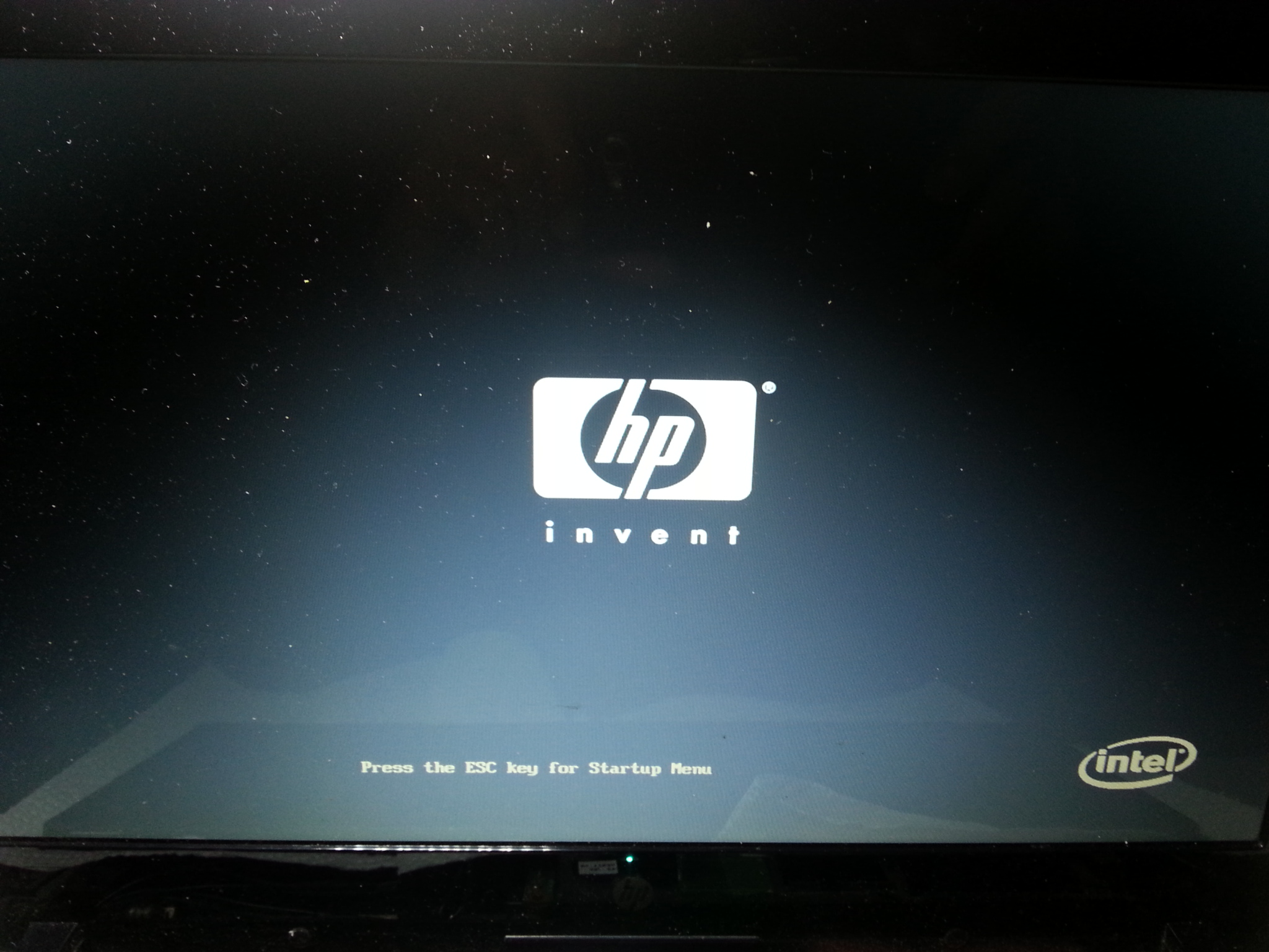

    Hip Probook 4310s caps lock blinking 5 times.
    I got hp probook 4310s here, when I power it up, it boot but won't continue, just stuck on Hp logo.
    Caps lock flashing 5 times every two seconds then stop flashing after four attempts.
    1.Replaced cpu with a known good one.
    2.Memory
    3.Hard drive but no luck.
    Tried to power it up with cpu, memory and HDD only but still the same and I can't go to bios settings.
    Anyone had experienced this kind of problem?

    Re: Hip Probook 4310s caps lock blinking 5 times.
    first there is a nec tokin.... second could be southbridge.
    change that nec tokin with 4 tantalum, then if still the same, reball southbridge.
        well if it hang on post , i dont believ would b a nec problem , altough on battery it should run and past logo . i believe more on a corrupted bios , reflasdh bios or even replace the entire rom and insert a new bios on it . it should work fine then
            I already changed the tokin and the rom chip no change.
            I checked the smd cap in the middle of the cpu socket it was shorted so I desoldered it, after that i checked the pad for short and it was shorted, so I followed the rail and I ended up to cpu socket.
            The cpu socket was shorted 41 ohms; this rail is connected to smd cap in the middle.
            Reflow/reball is still beyond my knowledge.
            Thank guys for your help
              It will show shorted with CPU when in socket, check without CPU ,
                  With cpu on, tokin is shorted and the mosfet, without cpu 220uf cap in the middle shorted all the to the socket.
                  I don't have machine to do reflow/reball.
                  Have you fixed one like this before?
                    yes tokin is fine .press the souh bridge bga with hand (thumb) & start the board.
