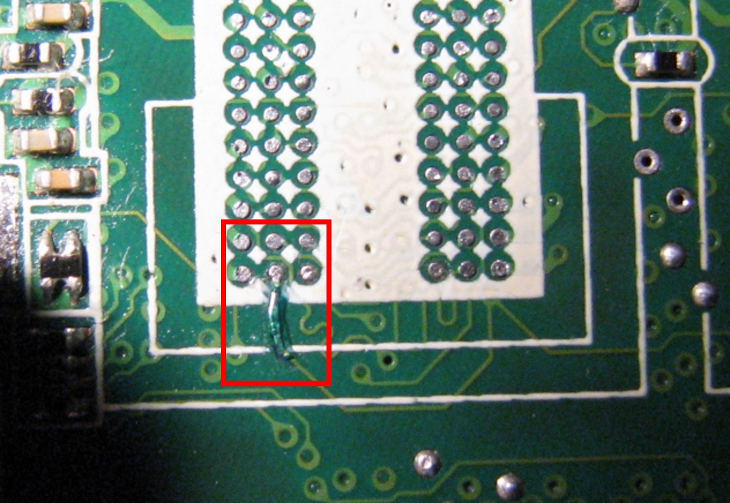

    I had to rebuild a 0.25 mm route and his pad after it has been ripped from the automatic desolder machine due to a bad profile temp
    I have used a high thermal epoxy and a route kit.

    Re: Route and Pad repair
    looks like a good work
      thanks
      It 'a few years that I perform these repairs, especially on industrial boards. To achieve this, I had to try various techniques. The main problem, if the track is detached and is not reusable, is to prepare the epoxy (letting it rest on the hot) so that the viscosity is optimal to hold the track. It is not possible to let the epoxy hardens at room temperature but should be placed in an oven at 70 degrees for a few hours.
      I was also able to reconstruct damaged boards with more layers.
