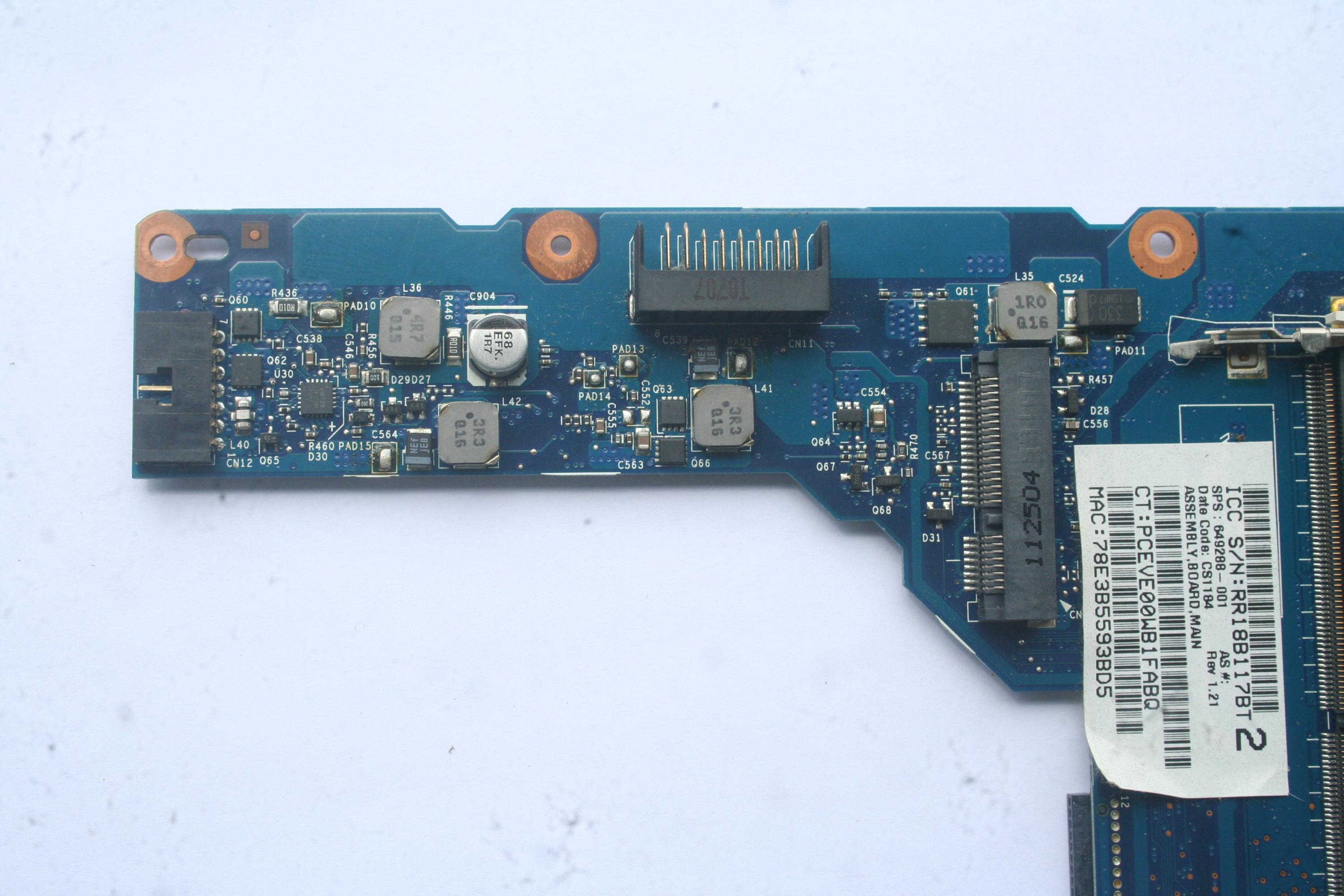

                    Here is a picture of the mboard. The numbers are 6050A2412801.
                    The schematics suggested above do not seem to apply. Searching for 6050A2412801 on this site suggest the mboard may be Invatec Rocky AMD rather than Quantum. Niether has the power connector labled as CN12 as on the board. I am puzzled !!

                      Your link doesn't work. Please upload photos to the forum along with your post, it makes it easier.

                            Re: HP Pavillion G6
                            Great but unfortunately I don't think that sticker is what we need...
                            The numbers required should be silkscreened on the board (the fine white lettering) somewhere. If you can't find anything obvious, try uploading a photo of the whole board, both sides. It may even be under the sticker itself.
                            I could be wrong, but Q60 in the top left of the board looks like it may have a hole blown in it. It could well be just the manufacturer mark too, but it seems a little 'off'. Can you inspect it more carefully and check?

                              Re: HP Pavillion G6
                              The silkscreen numbers are :-
                              6050A2412801.
                              MB-A02
                              2011-04-29
                              HSTNN-I94C
                              The schematics suggested above do not seem to apply. Searching for 6050A2412801 on this site suggest the mboard may be Invatec Rocky AMD rather than Quantum. Neither has the power connector labled as CN12 as on the board. I am puzzled !!

                                  Sadly no joy those schematics do not reflect the board I have. But thanks everyone for trying.
