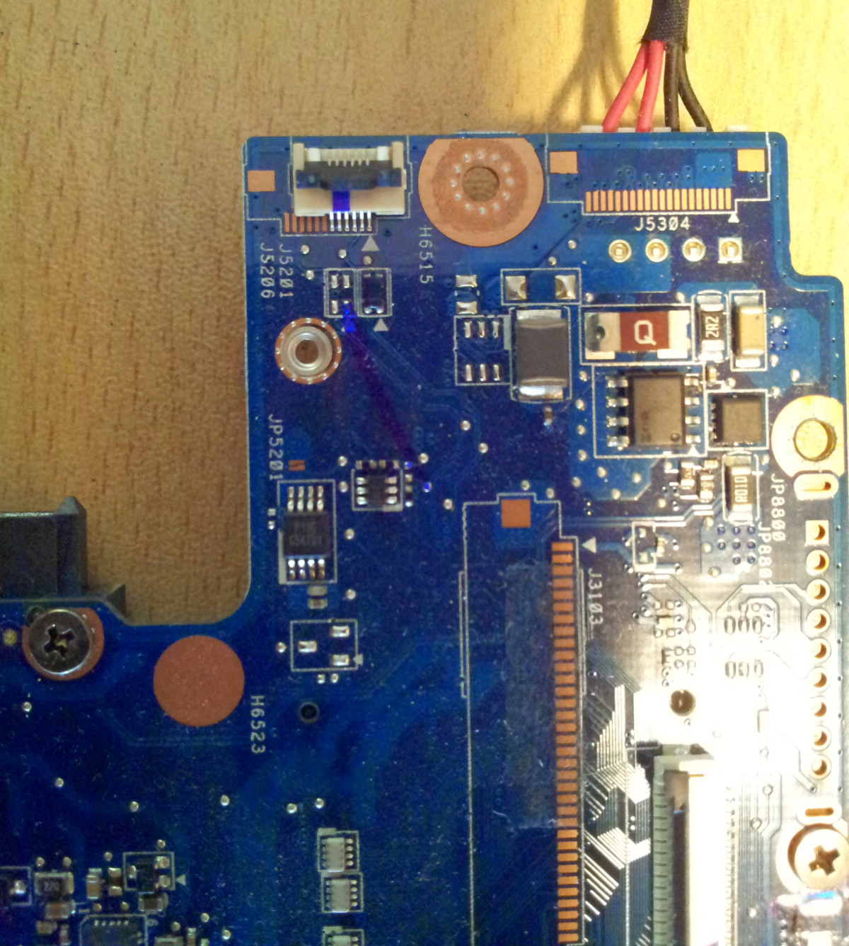

C850-1LC - No power - shematic
  • yaman
    • Nov 2014
    • 16
    • France
    I browsed the shematics on the forum for C850 laptop motherboard, but I really have problem to read them as numbers are different from the ones on the picture.
    After using a faulty charger, the laptop does not power up.
    The pins 1 and 2 for the battery are only showing 1V, i don't think it's charging anything.
    I ve also changed a mofset but that didn't fixed anything, I don't know where I should put my multimeter for the next steps. Any help appreciated.

    Re: C850-1LC - No power - shematic
    look at this maybe it's helpful
    https://www.badcaps.net/forum/showthread.php?t=41206
      Maybe these will help?
        Thanks a lot mabrouk, that was it, the mofset swapped and now it works !
