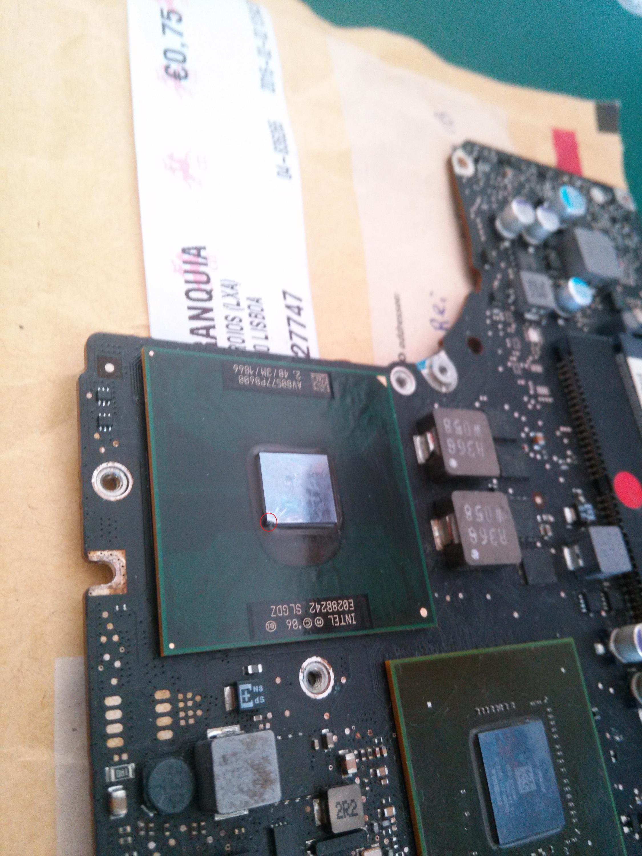

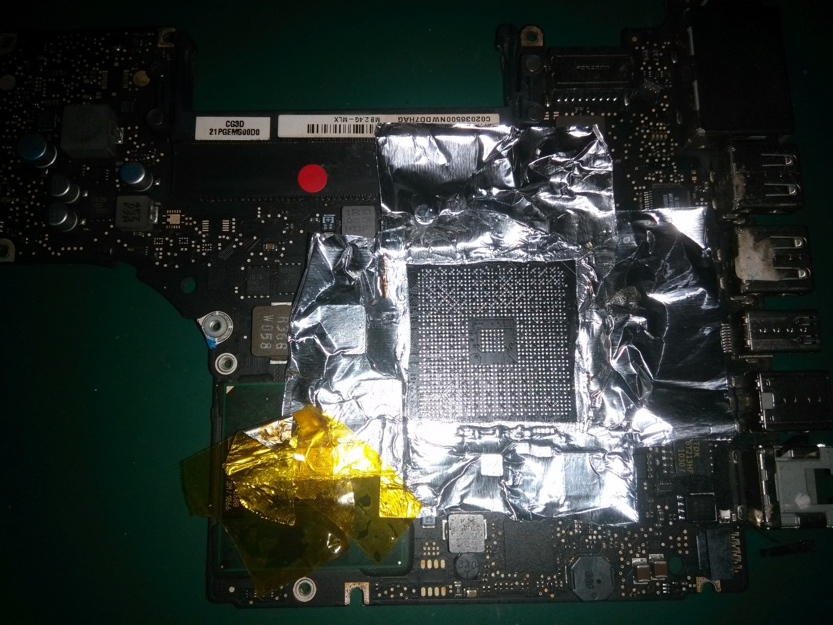

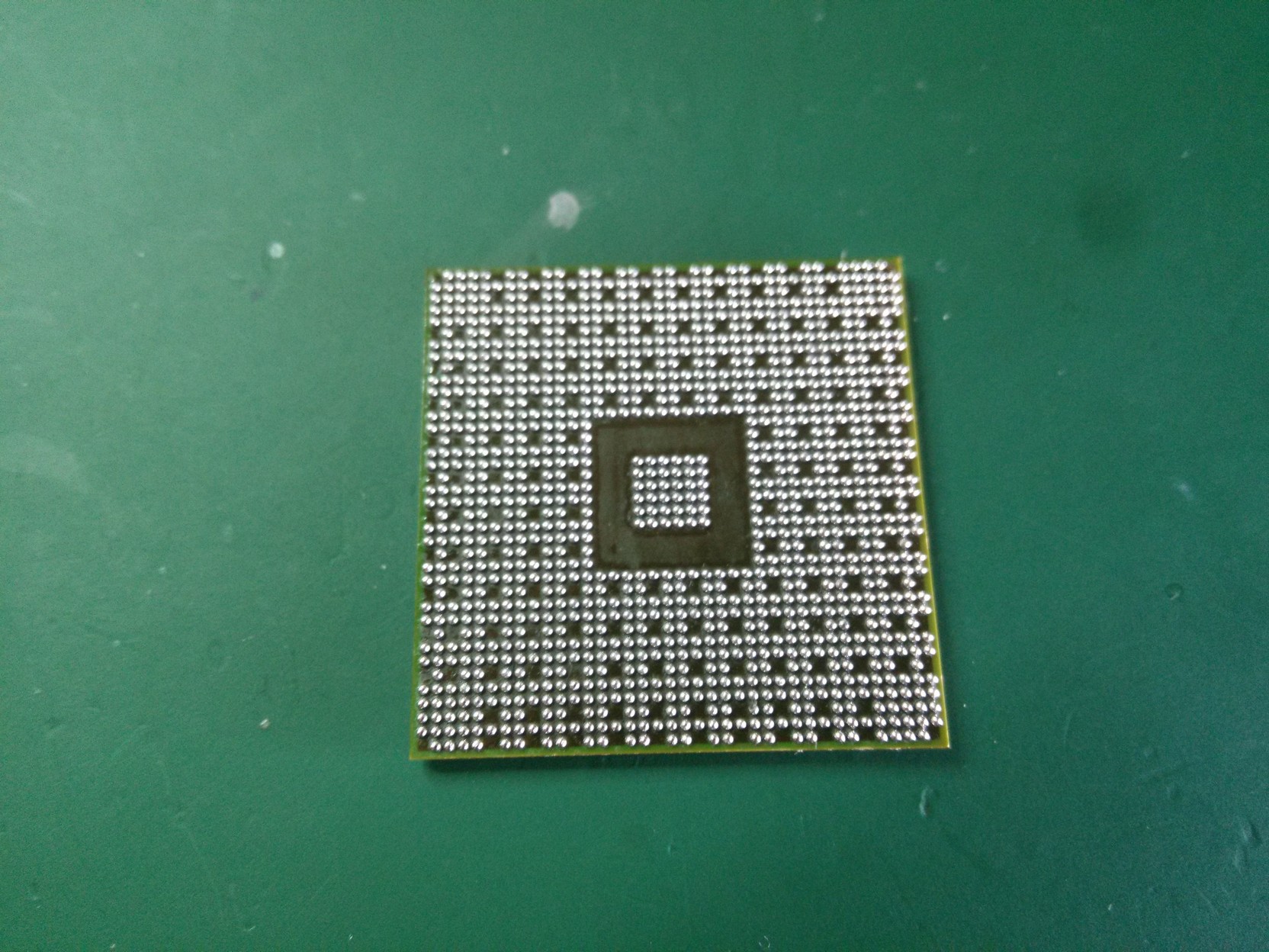

            Hello!
            Some time without update, I got the new BGA chip, bought a new one so I can sell this equipment with confidence.
            Just to remember, the laptop had the same symptom when I first got it and reflow solved issue. Then problem came back, reballed and went ok.
            1 week later or so , same problem, turns on and no image nor chime.
            Lifted old Nvidia chip. no probem.
            Placed new one, also no problem.
            Assembled it , and when I press power button, fan turns just a little and seems to brake right after, and laptop doesnt turn on.

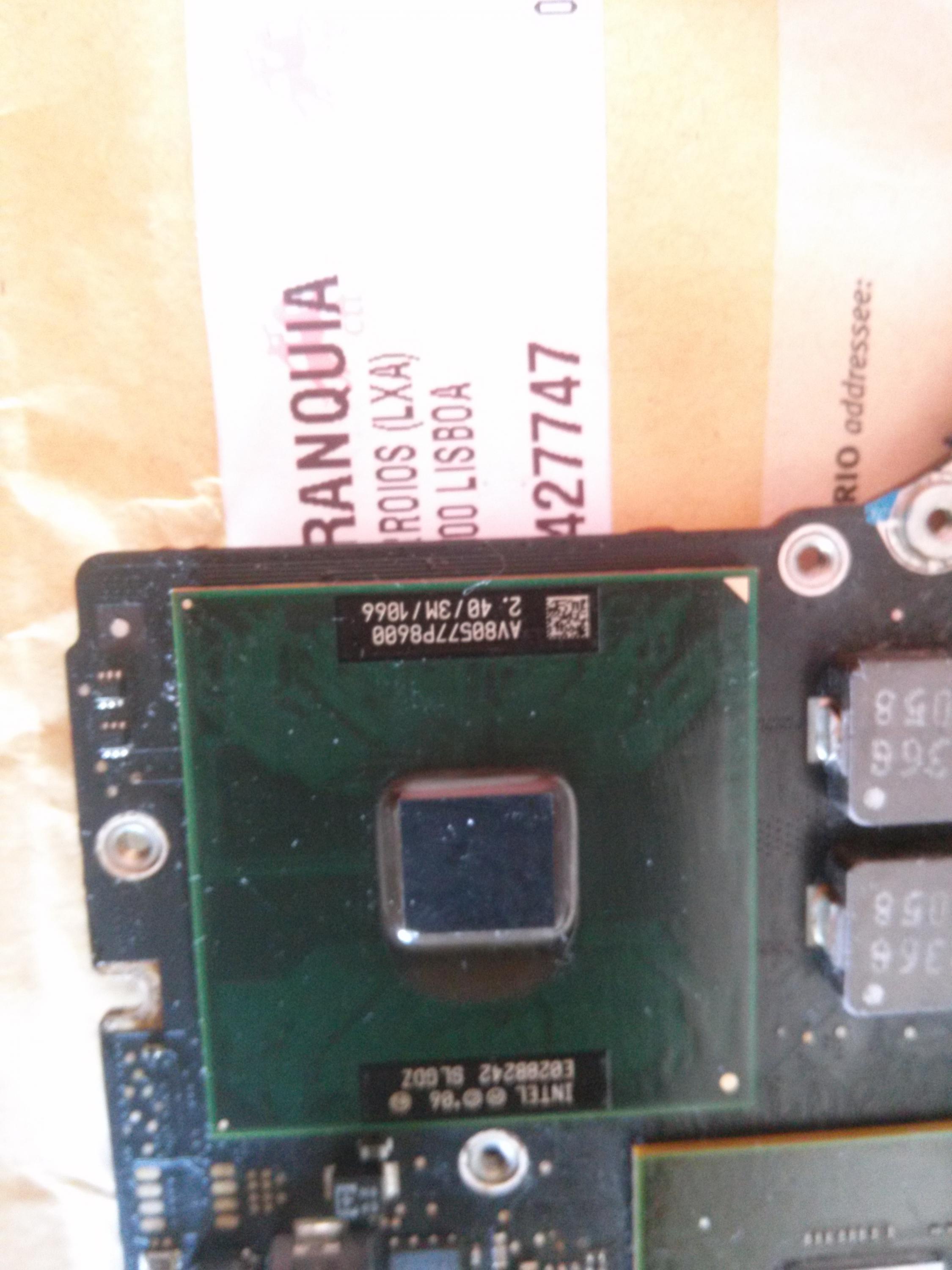

            Removed board again, and gave a reflow on the CPU, I thought that the heat could have caused an issue with CPU solder balls.
            Made the reflow , and when I removed it from the BGA machine, I noticed that the CPU die has a corner slighly broken!
            Starting to be mad with this board!
            How didnt I seen it before? It had to happen between the lifting of old Nvidia chip and the CPU reflow. Still dont know I did it, but I did!
            Now, the thing is that I bought a new BGA, and I still have a non working board, with a different syptom.
            What's the right approach to this mess? New CPU?
            Is him the responsible of this new issue, not turning on, and just have that slight movement of the fan when I press ON?
            Jeez, sorry for the long description, but I had to.
            Thanks all!
            • dellxps15
              • Feb 2014
              • 1591
              • italy
              Re: Mac Pro 13' model A1278
              dont think that little damage to die is the responsible for malfunction.
              have had a mxm card with visible damaged corner and works very well.
