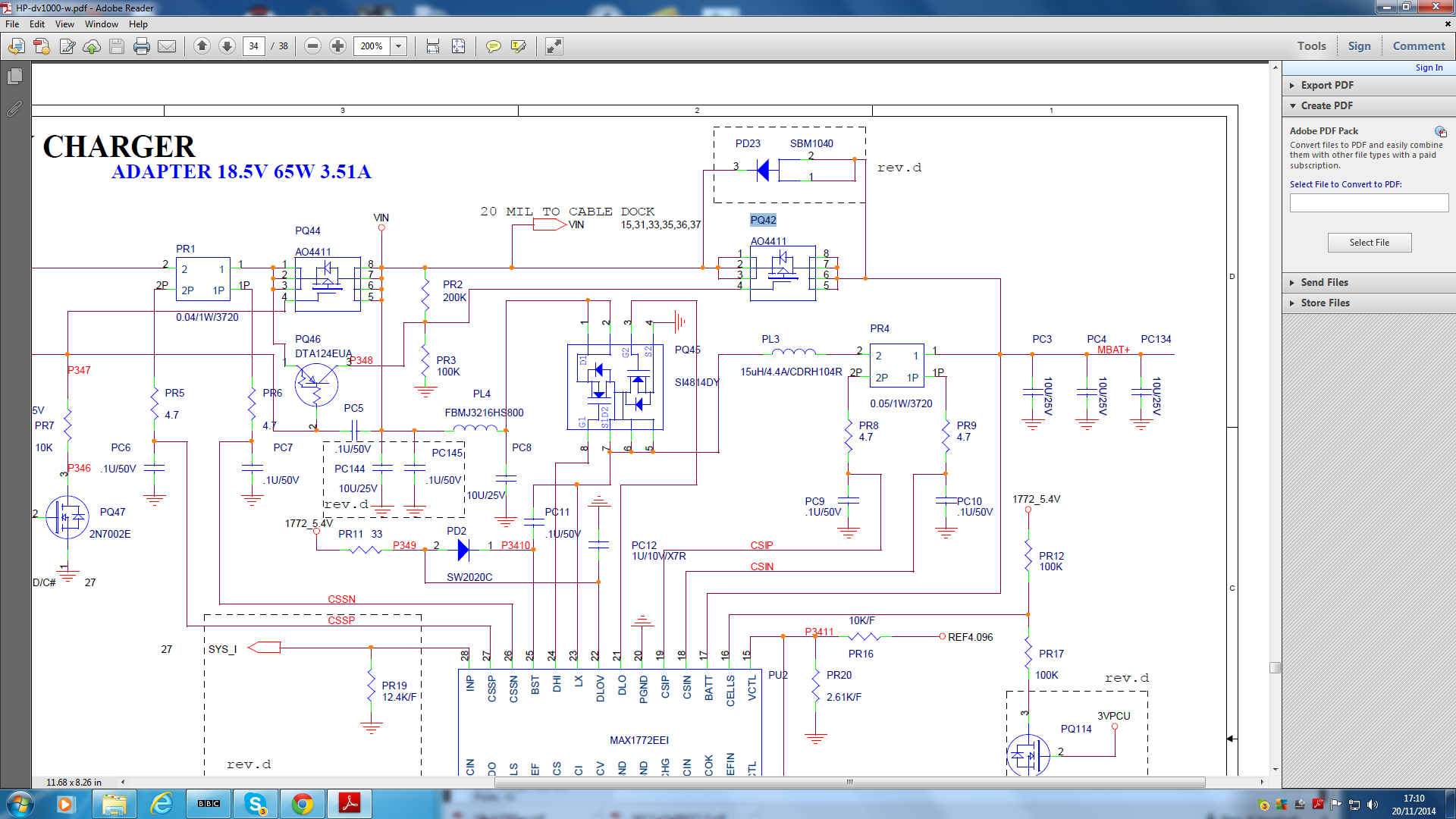

    Hi ! This laptop has 1st charging problem ,plugged in not charging but use to give backup but doesn't start with charged battery .
    I/o chip was heating .so I replaced it .
    now it shows plugged in charging ( & really it is charging).
    I have changed charging chip also
    charging indicator LED is also off .In any condition .
    still doesn't start with fully charged .

    Re: M2000 DA0CT3B6G6 Charging problem
    check of mosfet that switch battery to system
          Have you got the schematics
          • cyberhack
            • Feb 2013
            • 466
            • Uk
            Sorry i found it page 36, PQ42
              no, similar to this I/o chip is different no
                yes charging section is same
