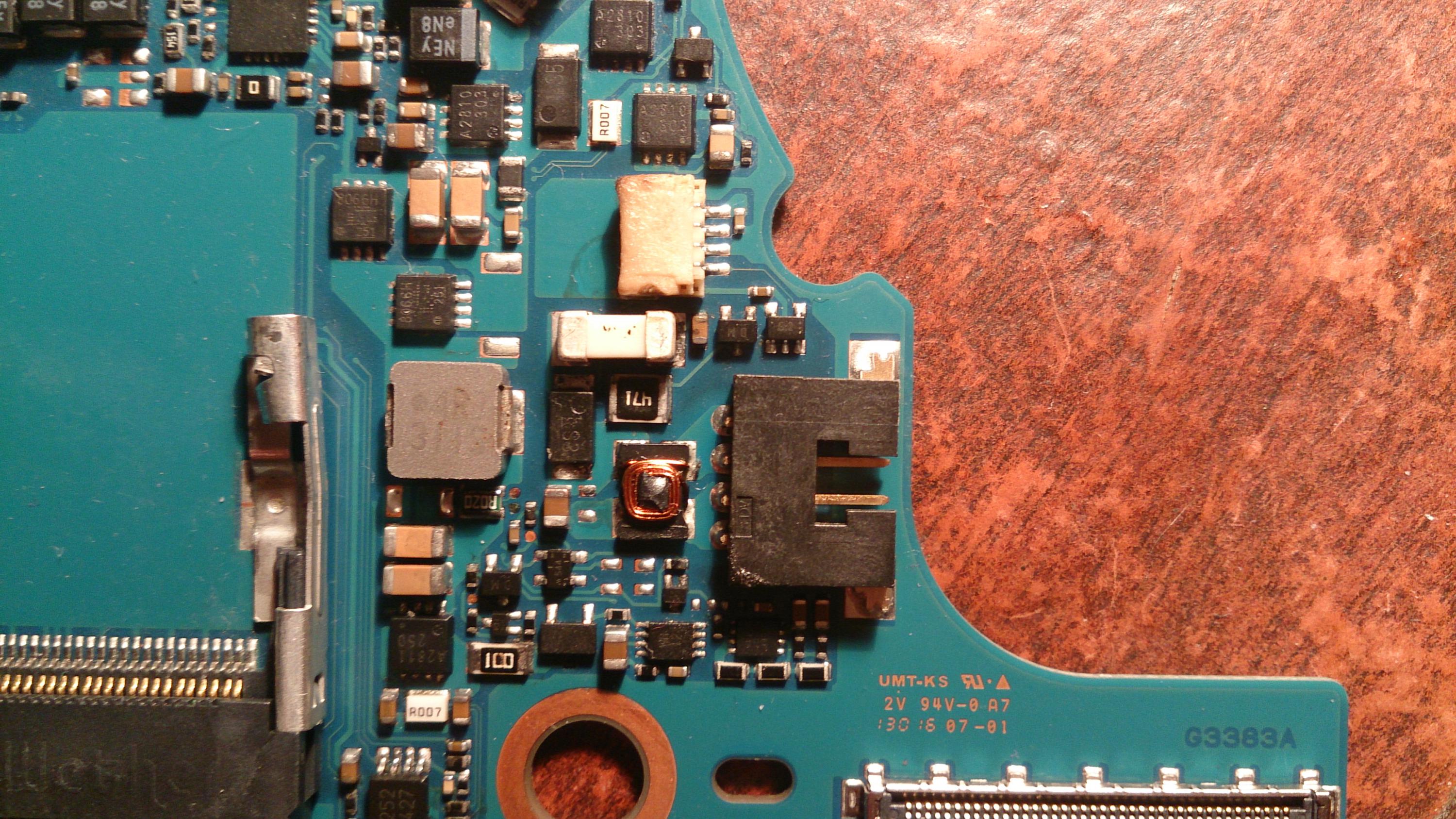

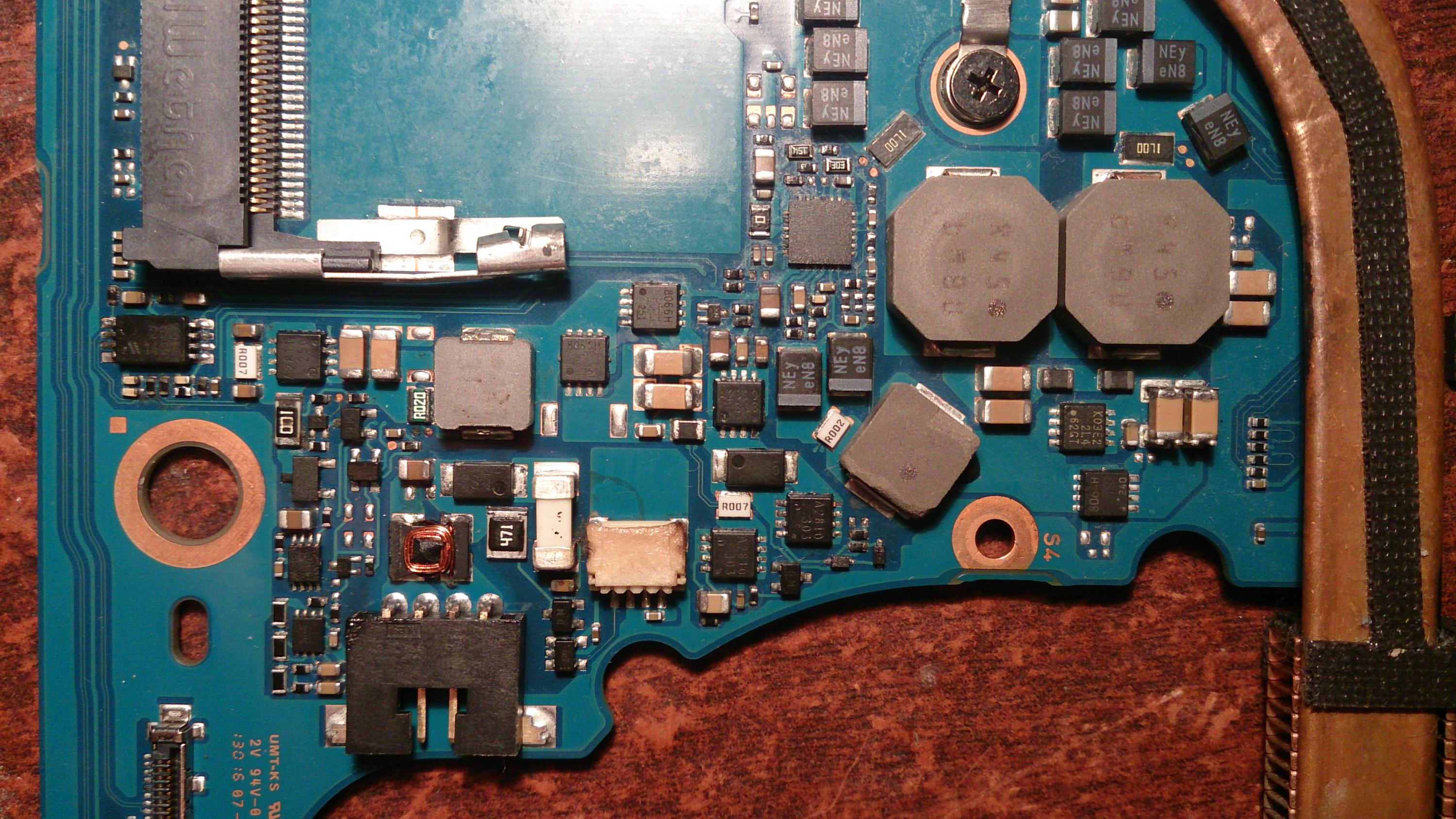

    Hi everyone,
    I have a Toshiba U920T laptop that suffered a lot of water damage and is now dead.
    There was lots of corrosion on the motherboard, specifically around the power input components but generally all over too.
    So I have been playing around with it, I put the motherboard in some boiling water and scrubbed off all the corrosion I could see, then washed with some IPA, then put it in the over at 250C for a few minutes. Didn't work.
    So I have been trying to test how far the power goes with a voltmeter, and straight away noticed it doesn't pass the first component. I have no idea what this component is, never seen one like it, it didn't have any markings on it or the motherboard. It seemed to have a plastic cap on the top that I popped off and saw it was some kind of coil, it has 4 pins, the 0V and 19V go in, and the 0V and 19V come out. I could see the copper wire coming out of the 19V was no longer connected, so I got a tiny bit of wire and connected the 19V in to a component on the other side of this coil.
    To my absolute shock the small LED came on to say it was battery was charing, so I turned the laptop on and it actually fired up, I flipped it over to check the screen and there was a message about the RTC battery being low (as it was not plugged in).
    The laptop was on for about 10 seconds before I unplugged it to put the SSD in and see if I can get it to boot to Windows. I have since not been able to get any life out of the machine, although I am sure i saw one LED flicker very briefly.
    Does anyone know what this small component is that is broken? I assumed it would just be some kind of filter, and therefore bypassing it for a few seconds would not do much harm.
    I have checked a few more voltages on the board, I am picking up a few 2V's, 3V's and 6V's here and there. There is nothing on the 4 p-channel mosfets though.
    Thanks!
    Graham

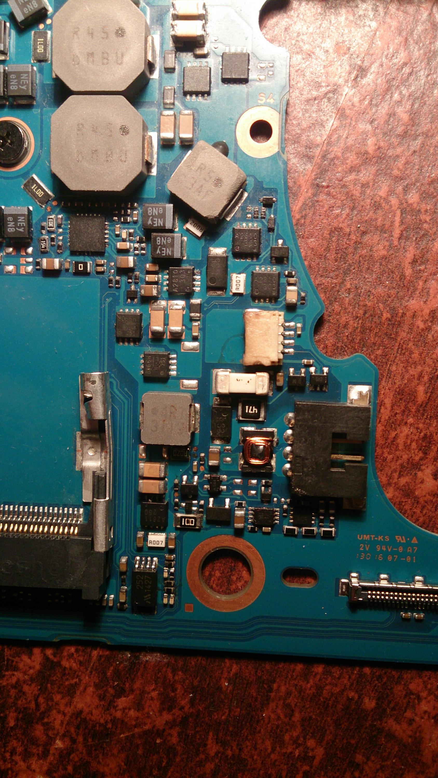

    clean with ipa and please take down that ugly wire. omg my eyes became red!
    do a vertical picture with good light so we can see the trace.
    you got there diode capacitor resistor and if you take the hat from the coil it will NOT work.

      Hi again!
      as requested
      thanks!

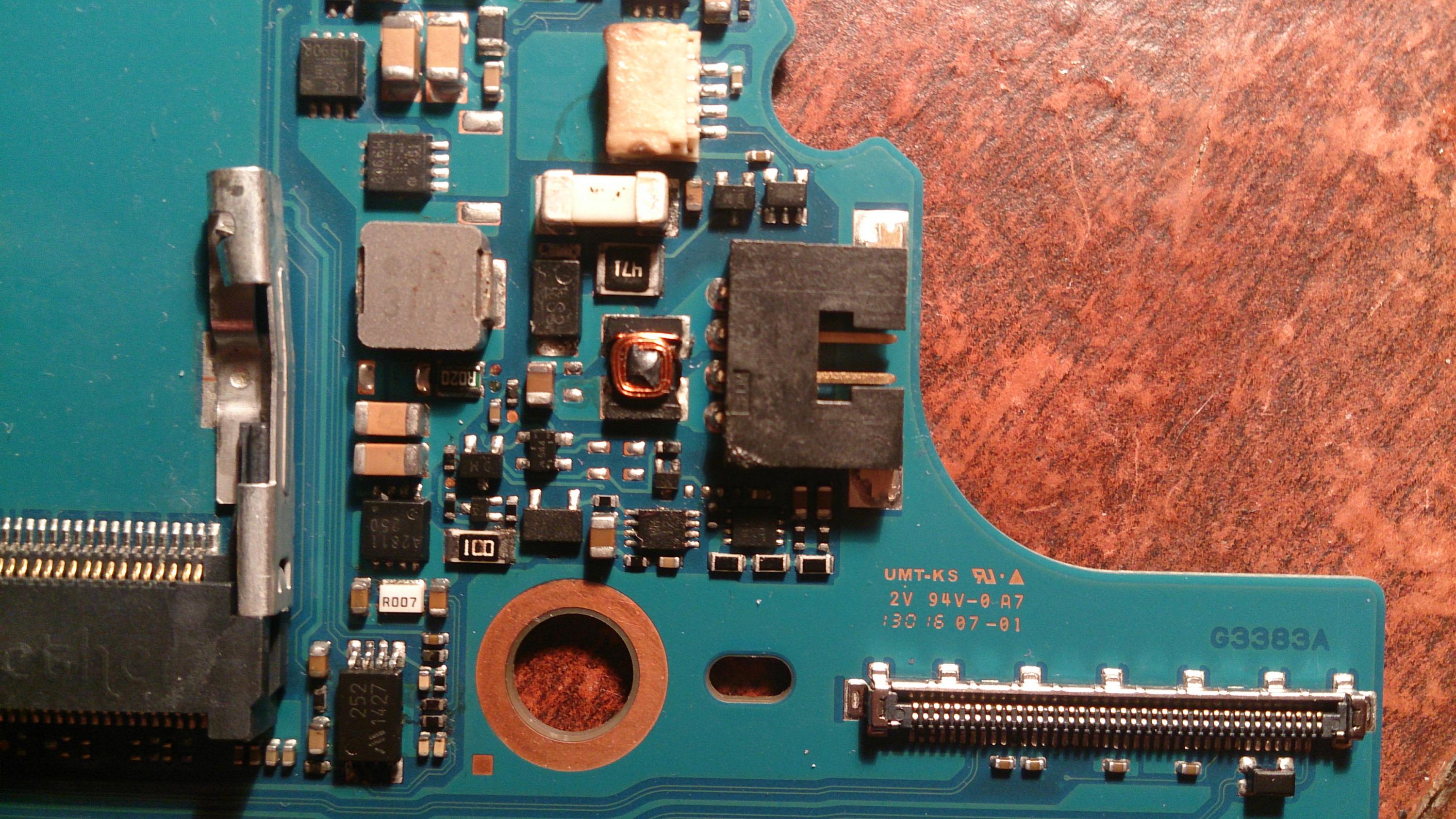

        a few more..

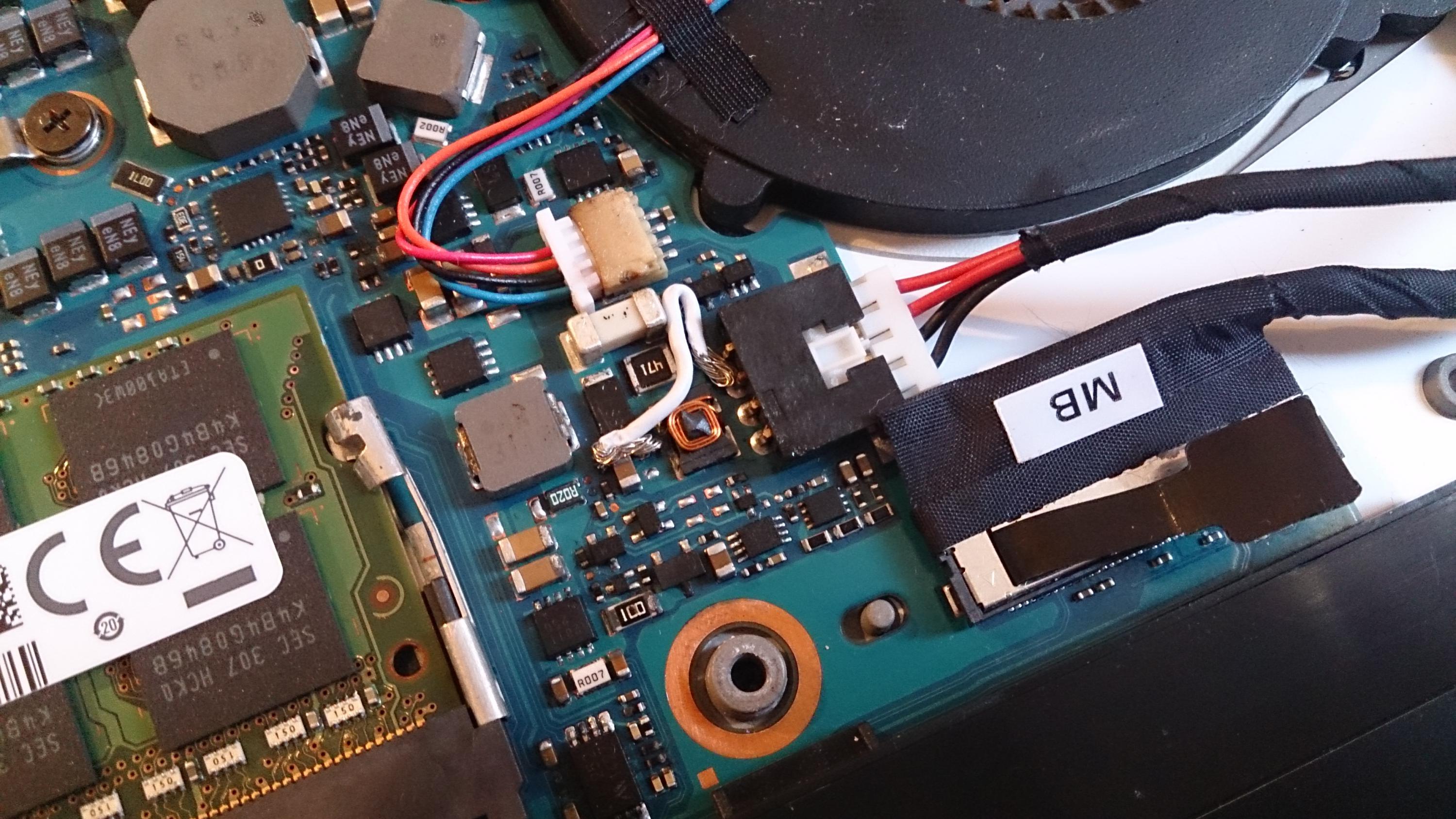

          I cleaned the whole board with IPA again and put that wire back in (sorry). When I plug the AC in the AC LED comes on! I thought it was going to turn on again, but it doesn't. The AC LED stays on but it is not as bright as it should be, also it doesn't go orange to say charging like before.
          Something happened though after washing it with alcohol..
          • grahamw01
            • Jan 2013
            • 256
            Re: Toshiba U920T dead, water damage
            I was just playing plugging the AC adapter in and out and the laptop turned on completely 1 more time! I unplugged it and tried a few more times again, nothing!

                Thanks, if it is just trace damage, what about the coil I am bypassing? I tried to glue the hat back together but superglued it to my desk instead and it shattered when I tried to break it off, I know there are lots of words you can call me!

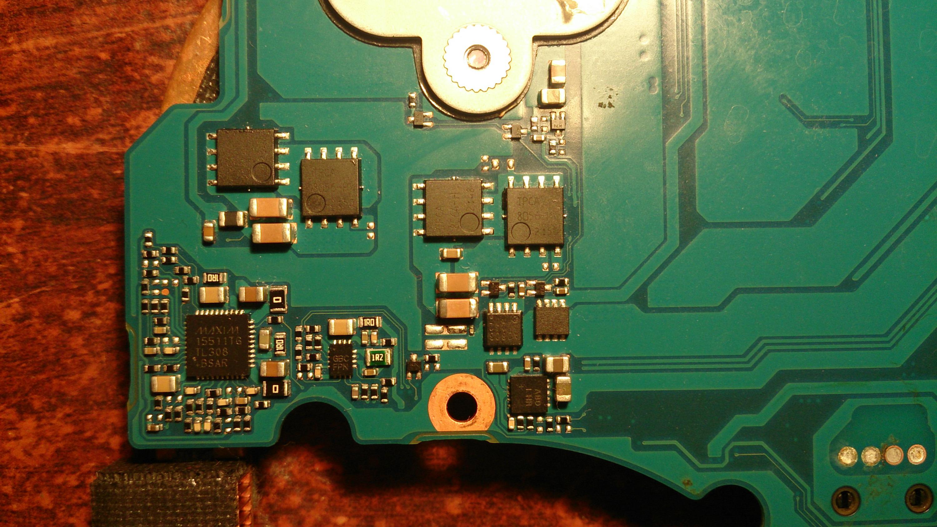

                      there is a QFN with 24 pads, photographed above, that looks like some of the joints are quite corroded. There are no markings on or around the chip so not sure what it is. What would be the best way to fix the joints? I planned to cover it in flux paste and reflow with a heat gun and fine tip, would this work?
                      thanks
                      • Th3_uN1Qu3
                        Believe in
                        • Jul 2010
                        • 6031
                        • Romania
                        Clean it very good first, then apply flux and reflow, then solder the pins.
