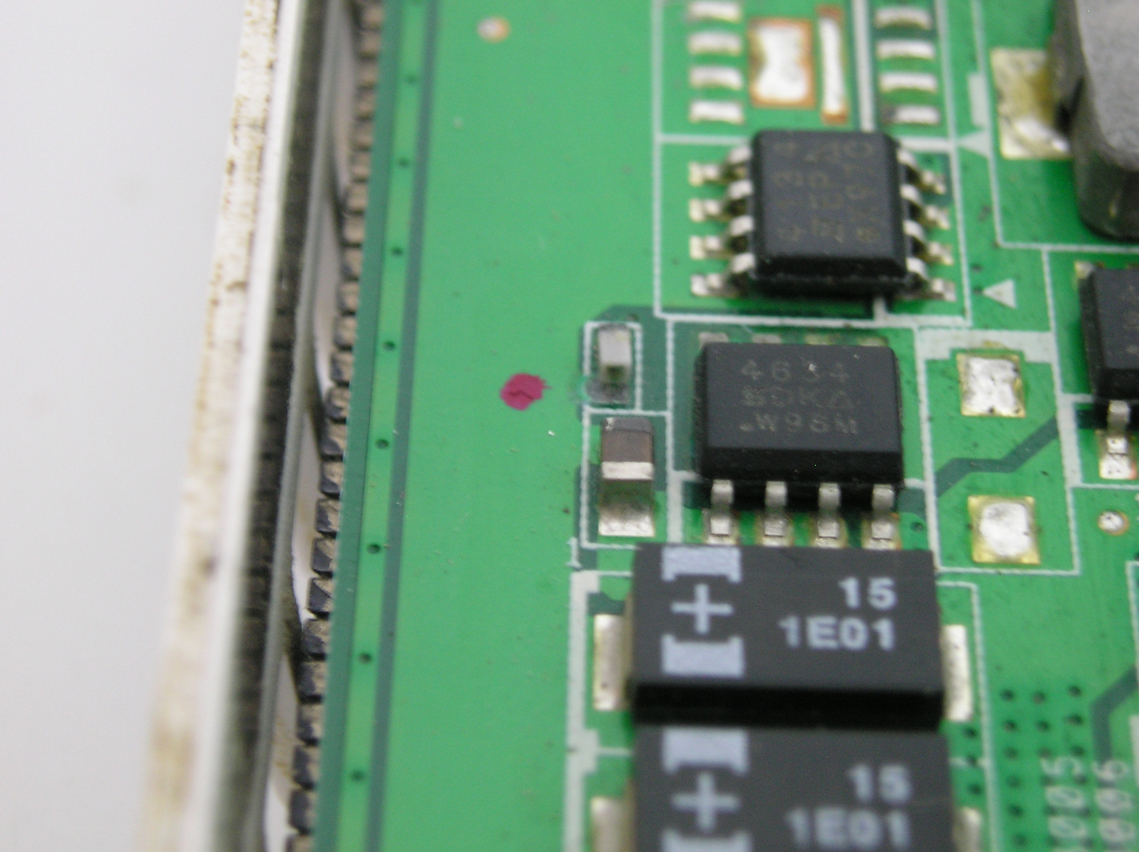

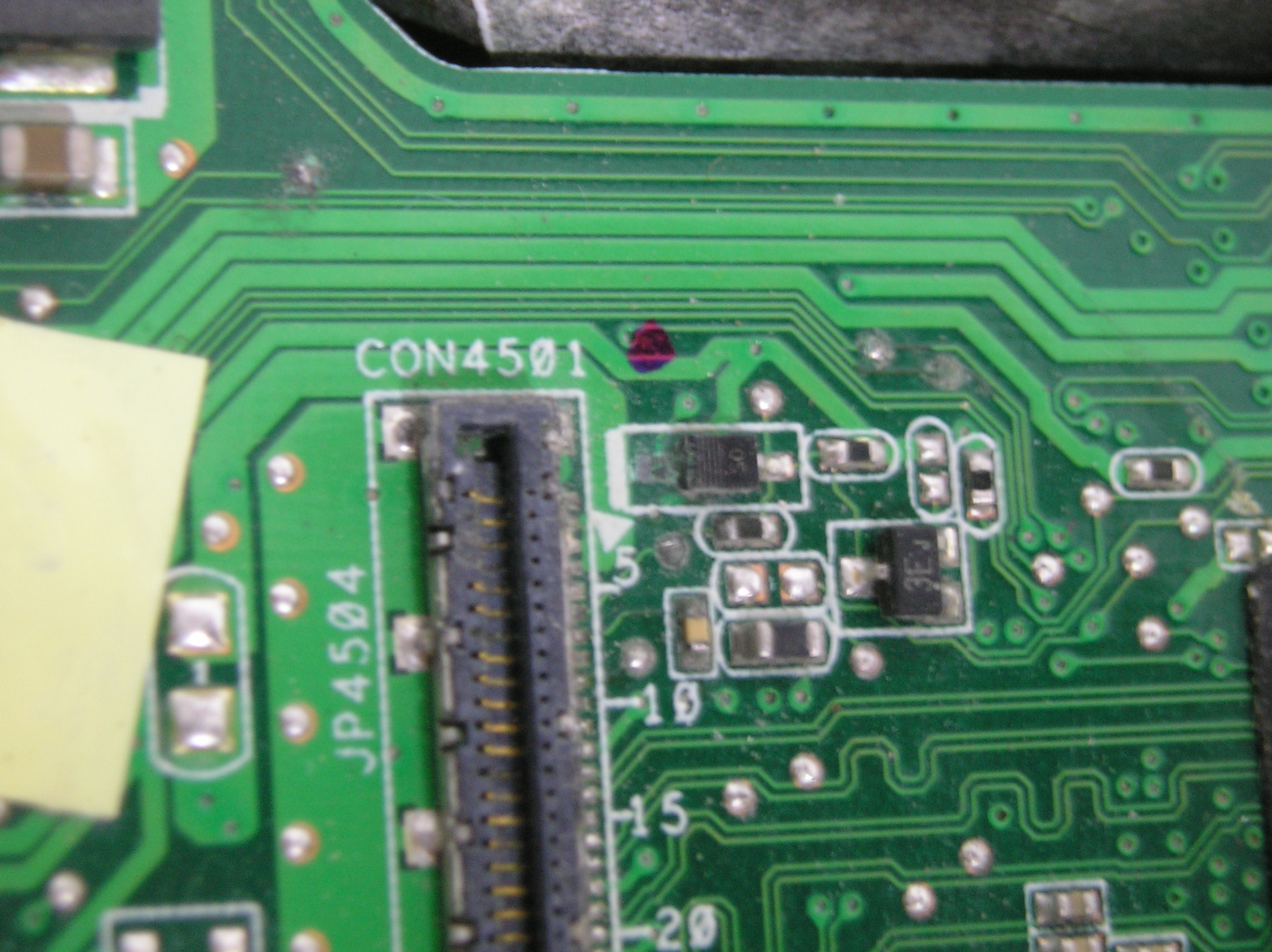

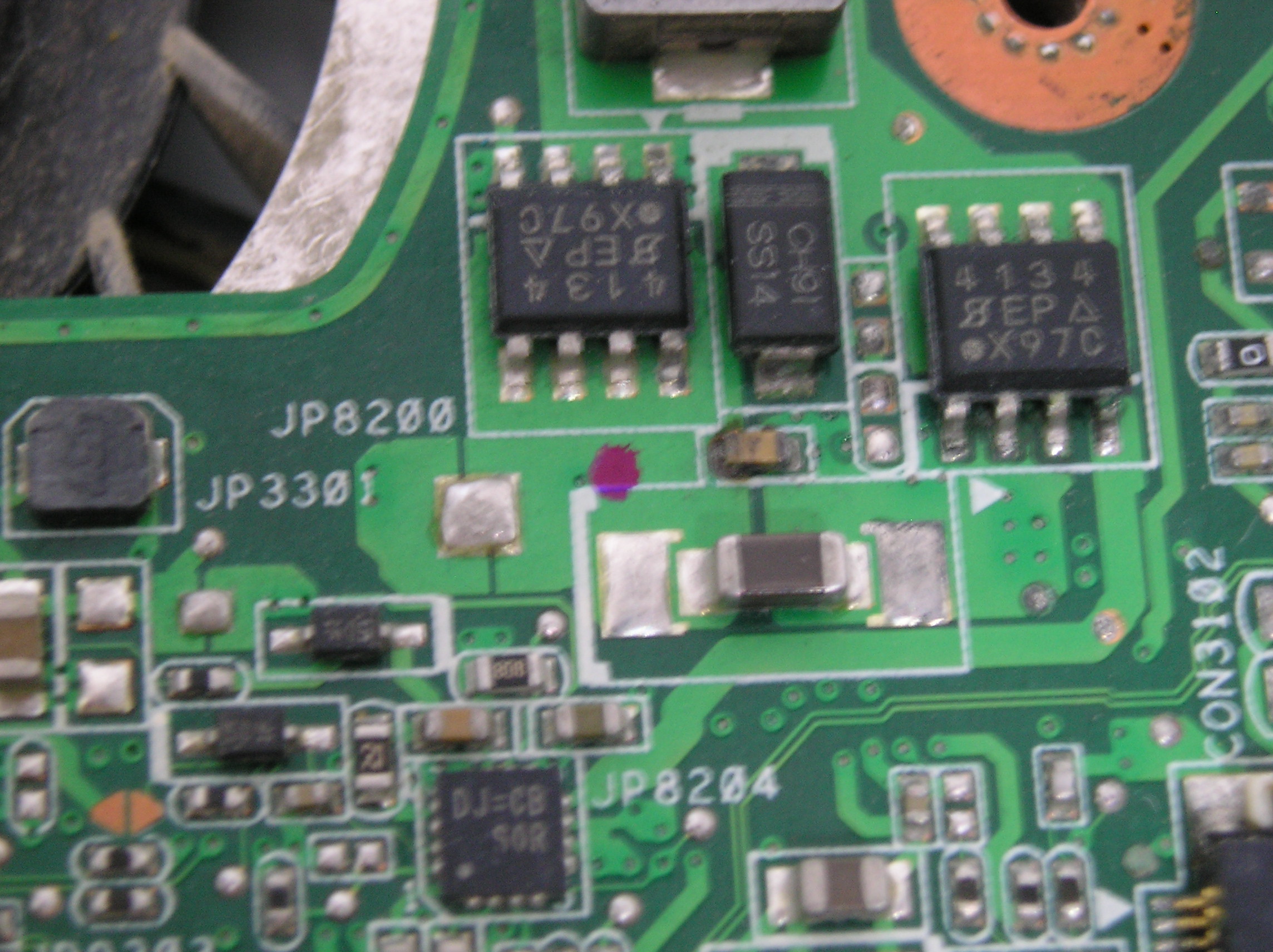

    Hey guys,
    I got this laptop atfer the owner gave up on it..
    I bought it for 50$
    The keyboad and both hinges were replaced just now.
    Battery is dead though...
    This laptop suffered from water damage..
    The problem happens on randomly,
    The charging light appears after a sec after plugging in the charger.
    I have a 3.3v on power switch.
    When i press the power button the laptop tries to power on for a milisec then fails and the charging light apears again.
    sometimes (rare) it powers on just fine.
    I opened it up and cleaned the corrosion on some parts the pad just been eaten.
    Do you think it is possible to fix it or shall i try to find a used board or just sell it for parts.

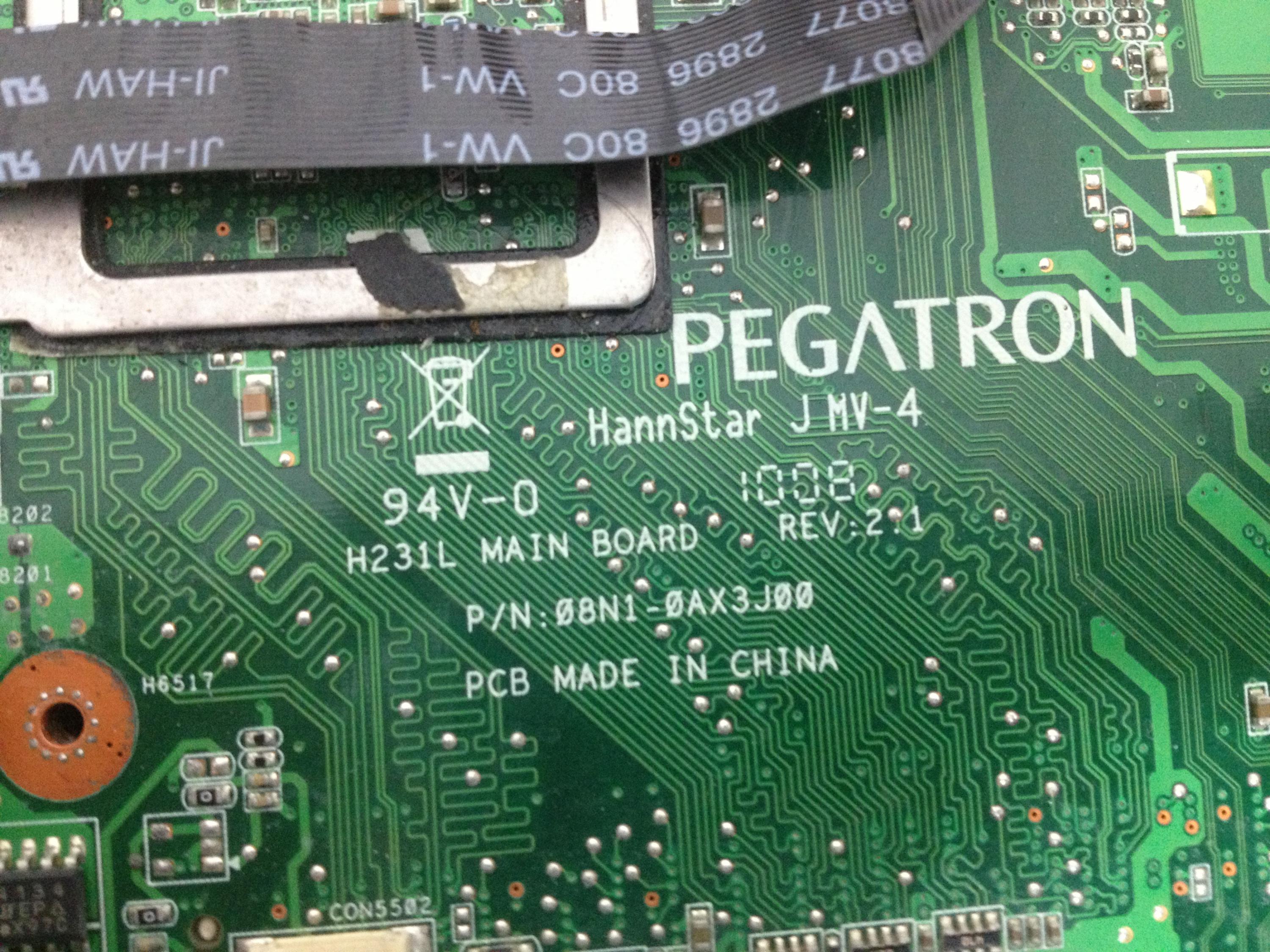

    Does anyone has the schematics for this board..
    i need some troubleshooting ideas on how to approach this kind of fault.

        cyberhack, i already tried my best with alcohol and a toothbrush.
        i think i need to fix those 3 bad components that the pads got eaten..
        i dont know what they are caps/coils? and their ratings.

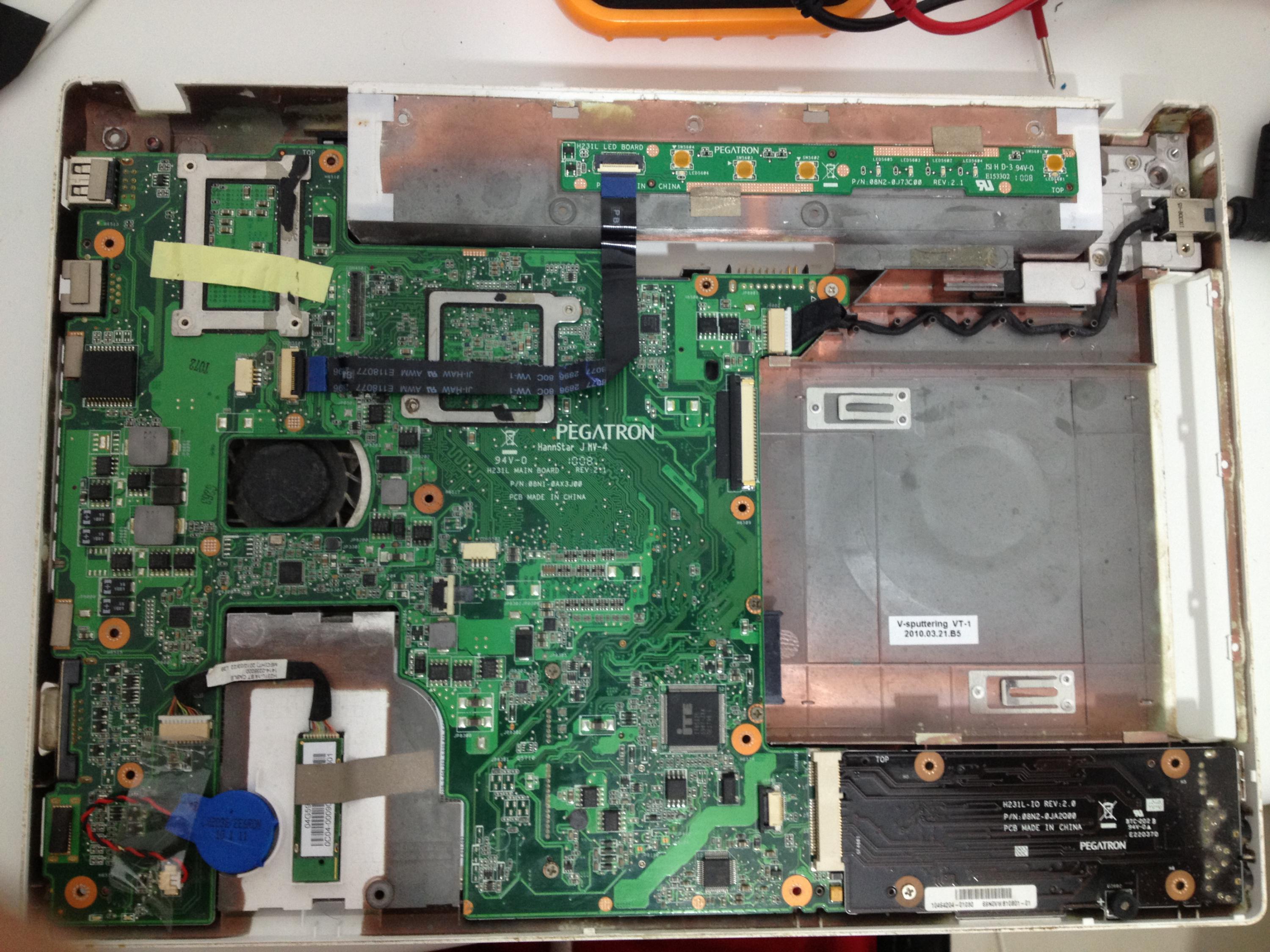

          I gave up on the old mainboard,
          I orderd a used one from ebay,
          The laptop is starting normally again.
          i have one issue, i can't remember the wifi antenas digram...
          i have 4 wires: 2 whites, 2 blacks.
          i have 2 wifi cards, i guess one is a 3G modem or something..
          could you guide me which goes where? does it even matter?

                Re: LG R380 no power randomly EBR63567605 motherboard
                Bad luck with this laptop,
                after a few months that it worked great,
                the mainboard i replaced died too :-)
                i want to try and get 1 board working out of 2 bad ones.
                need some help on no power symptom..
                i already tested the dc jack,
                i got 19vdc on 2 fets..
                anything else you would recommend?
