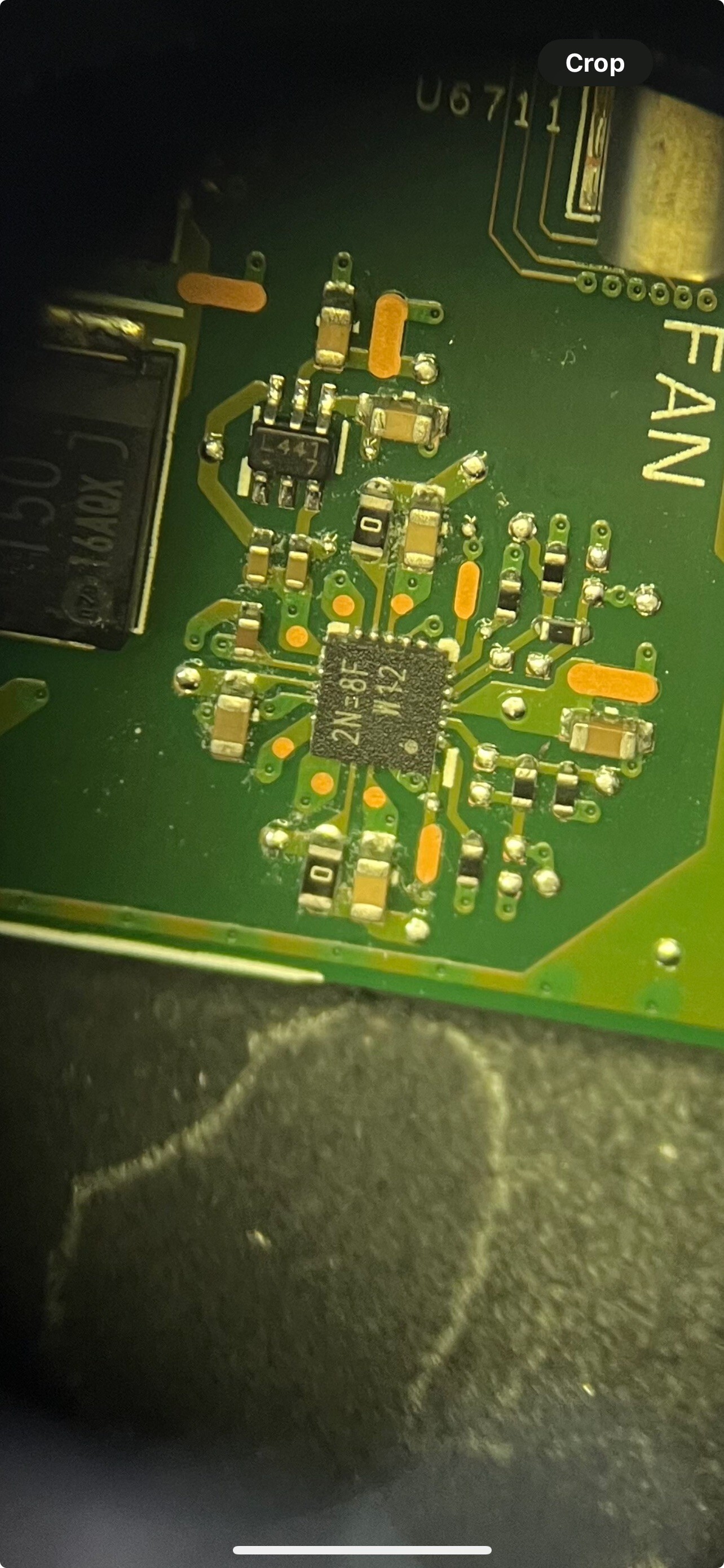

    I’ve got a problem with an ASUS ZenBook UX582L, the laptop isn’t powering on and is stuck at 0.08 A on the bench supply. The component shown in the image is heating up, but I’ve checked around it and there are no shorts on the nearby capacitors.
    Both MOSFETs (1 & 2) have 19.5 V as expected.
    Does anyone know what this component is, and could it be the cause of the issue, or should I keep looking further?

    2N should be a RT8249, but I'm not sure which variant. Undoubtedly someone else will be more informed, but it's a starting point.

      RT8249CGQW ; from the product datasheet
