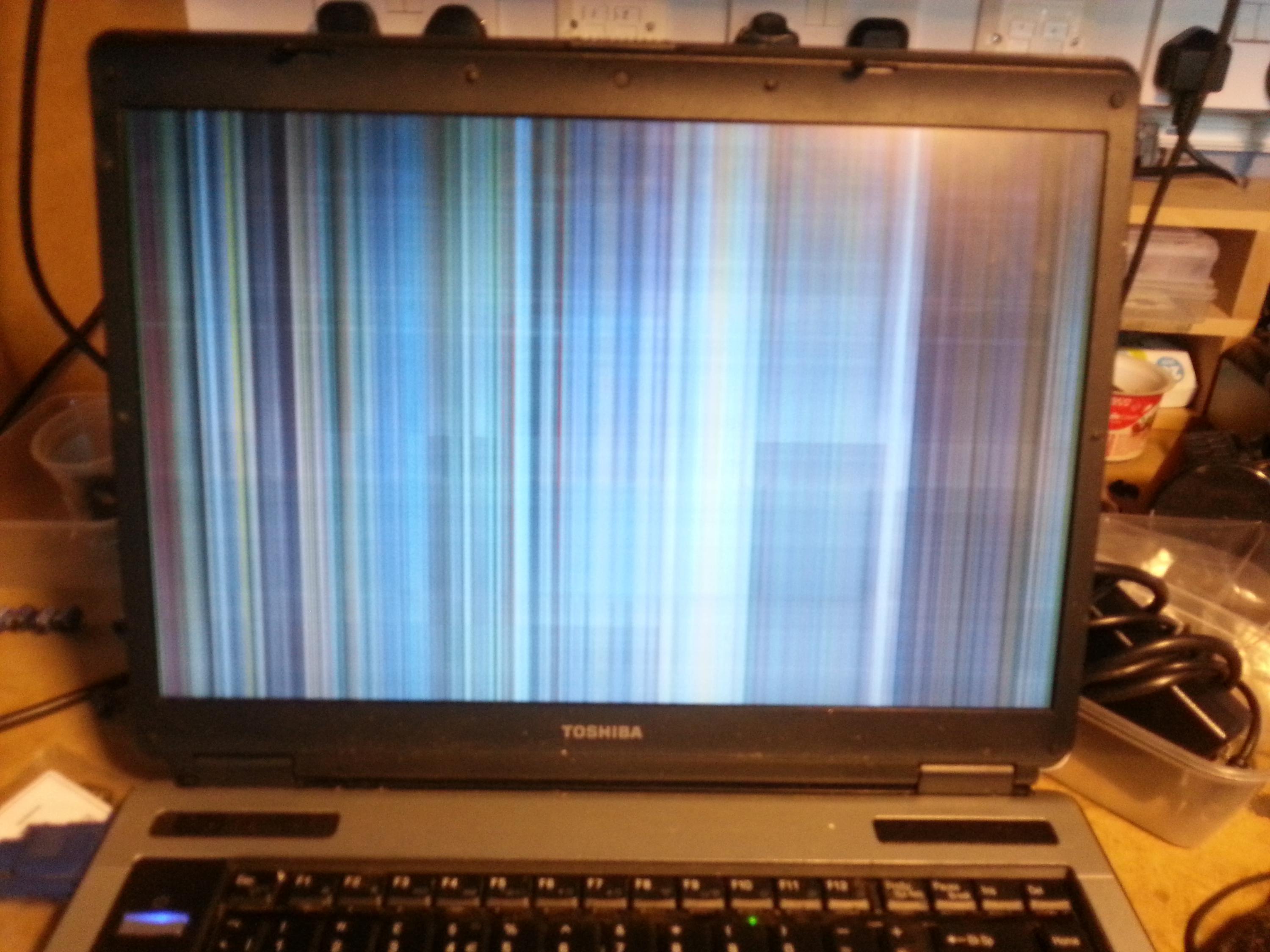

Toshiba A100 garbled picture on screen.
  • diif
    • Feb 2014
    • 6978
    • England

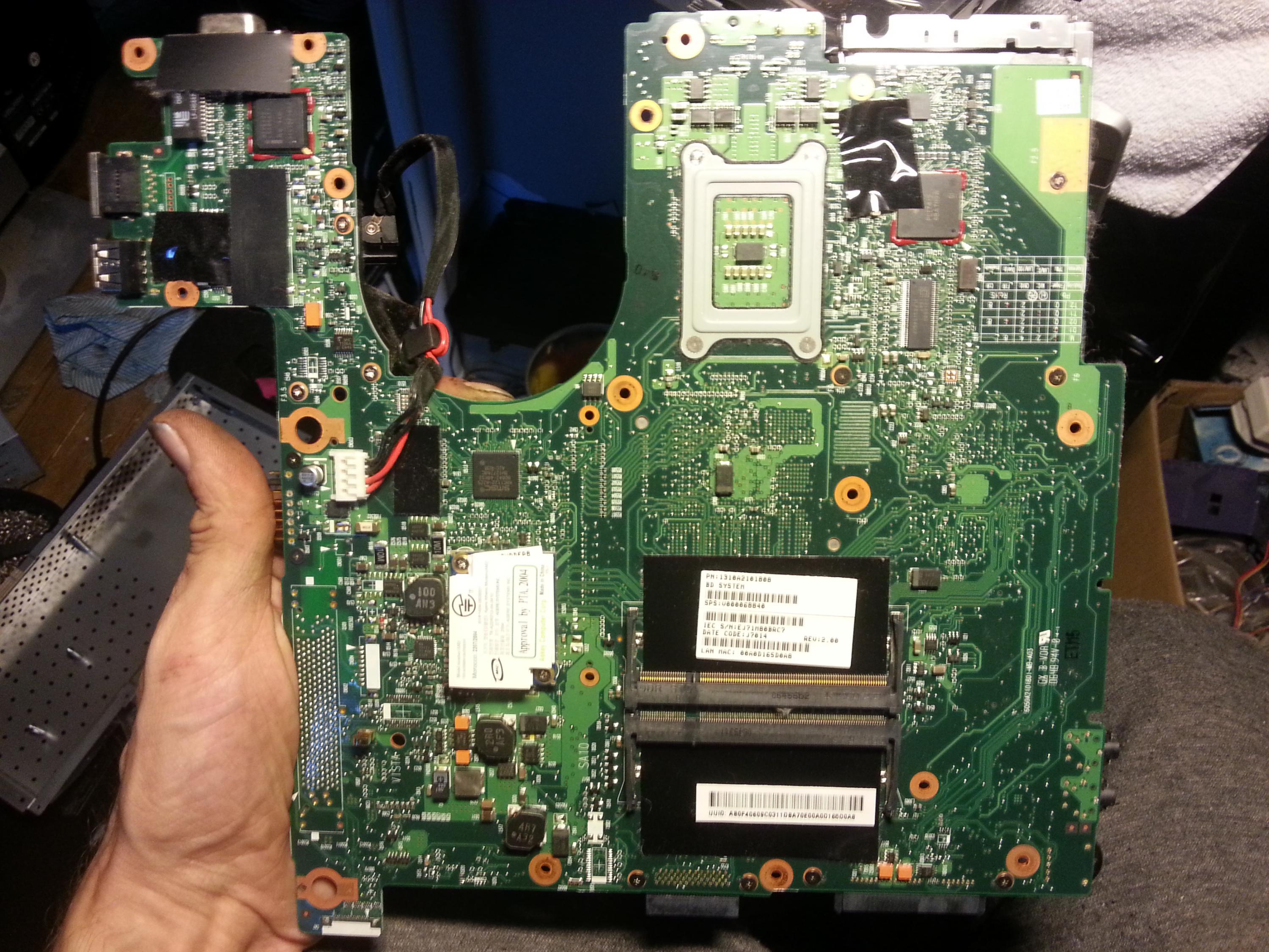

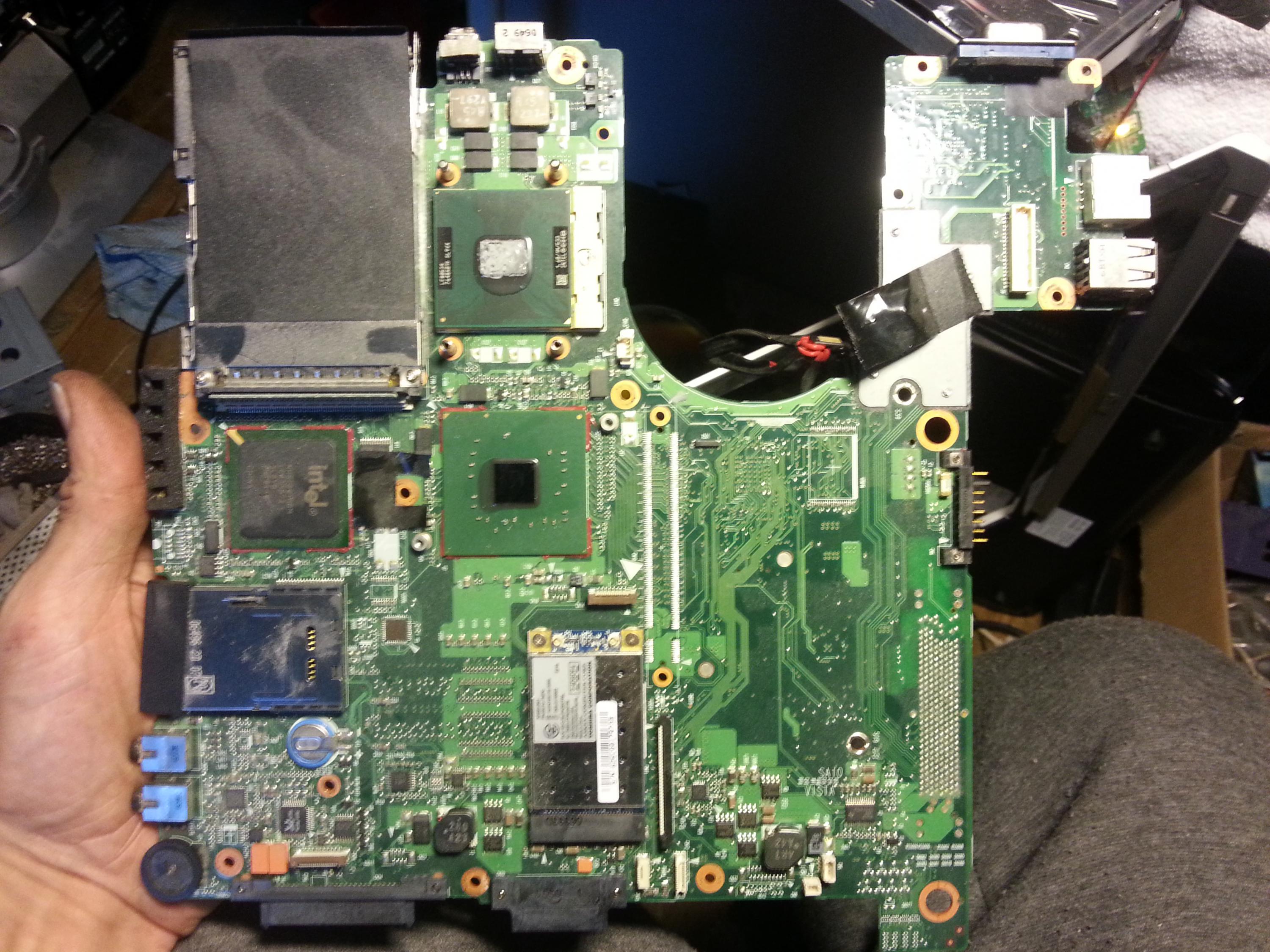

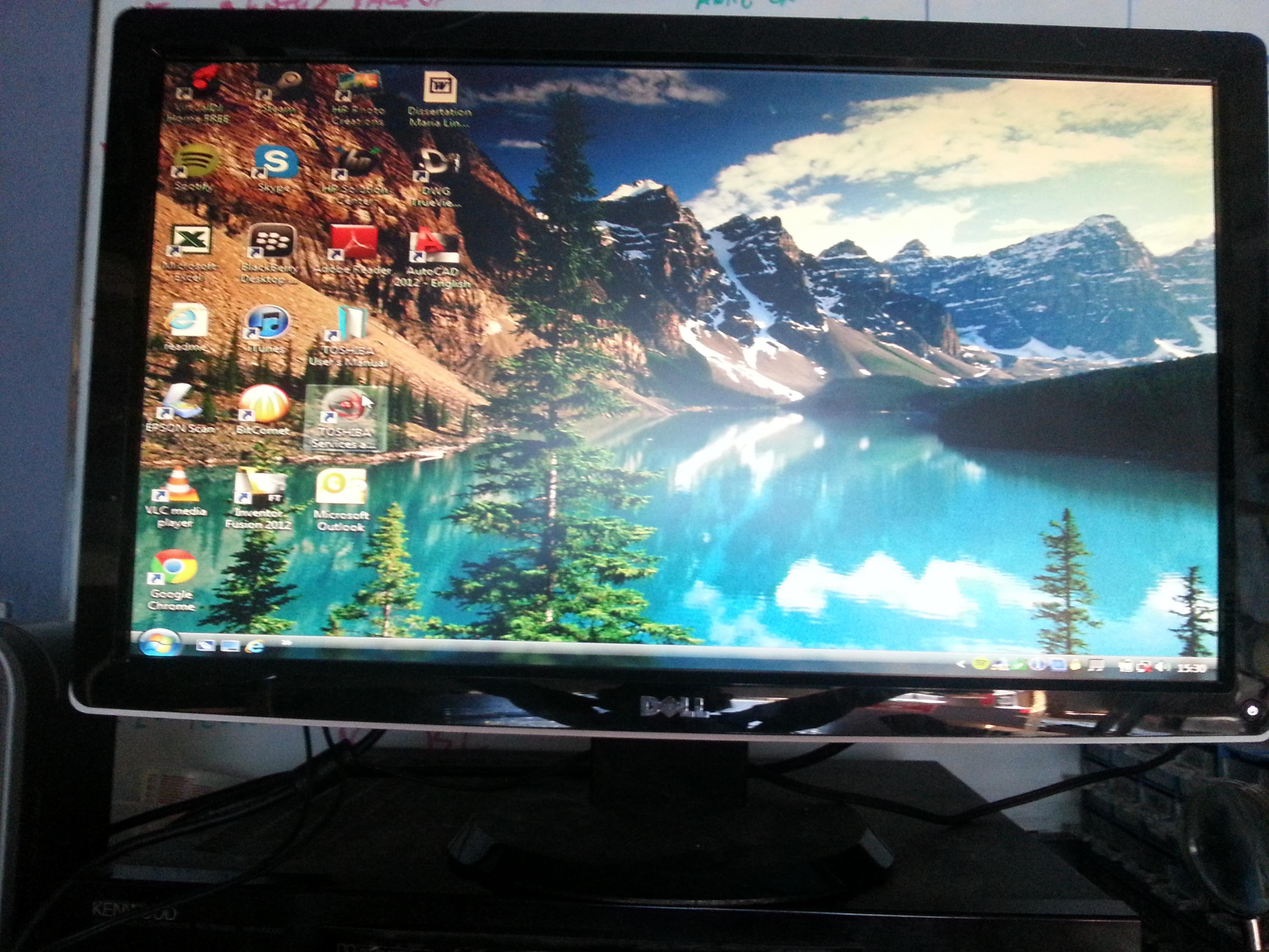

    Hello, I have a Toshiba A100 that boots up with a garbled screen but outputs fine to an external monitor. Does this require a reball ?
    Thanks.
  • dj_ricoh
    • Jan 2013
    • 2073
    • uk
    Re: Toshiba A100 garbled picture on screen.
    did you try another screen?
    • diif
      • Feb 2014
      • 6978
      • England
      Cheers ricoh, i got sidetracked over thinking this issue. It was a faulty screen cable !
