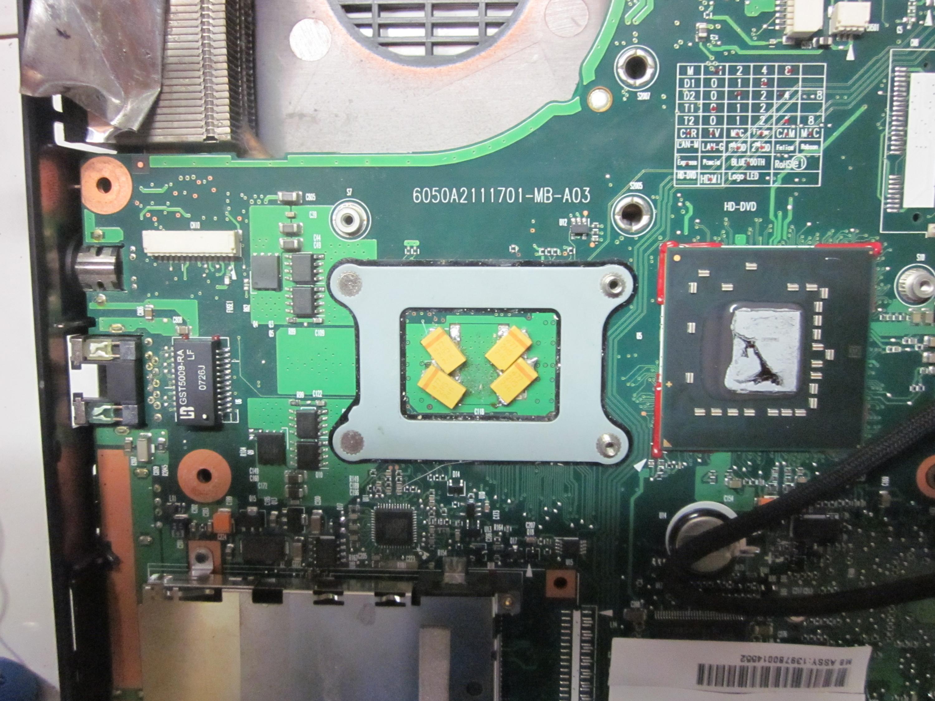

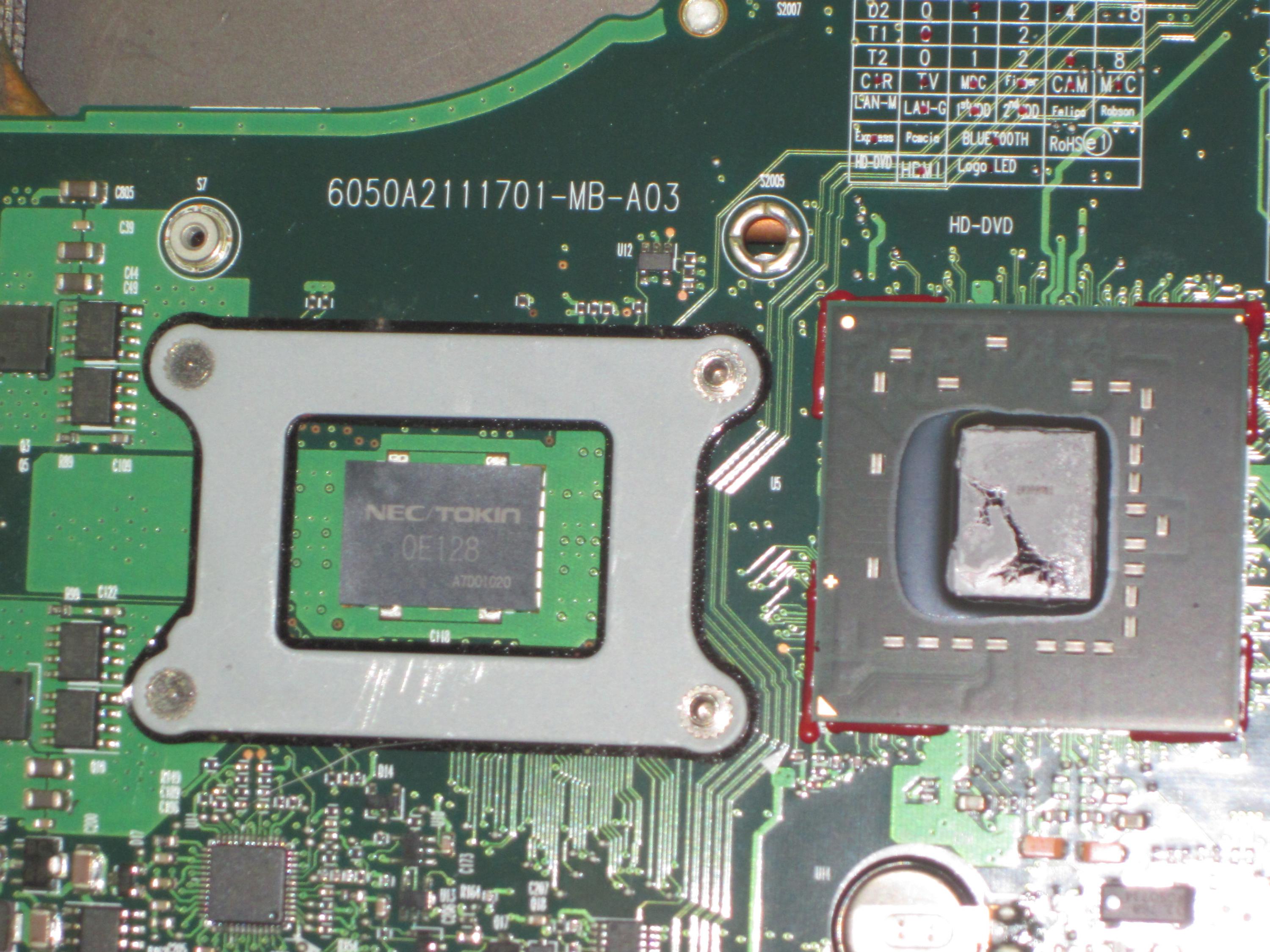

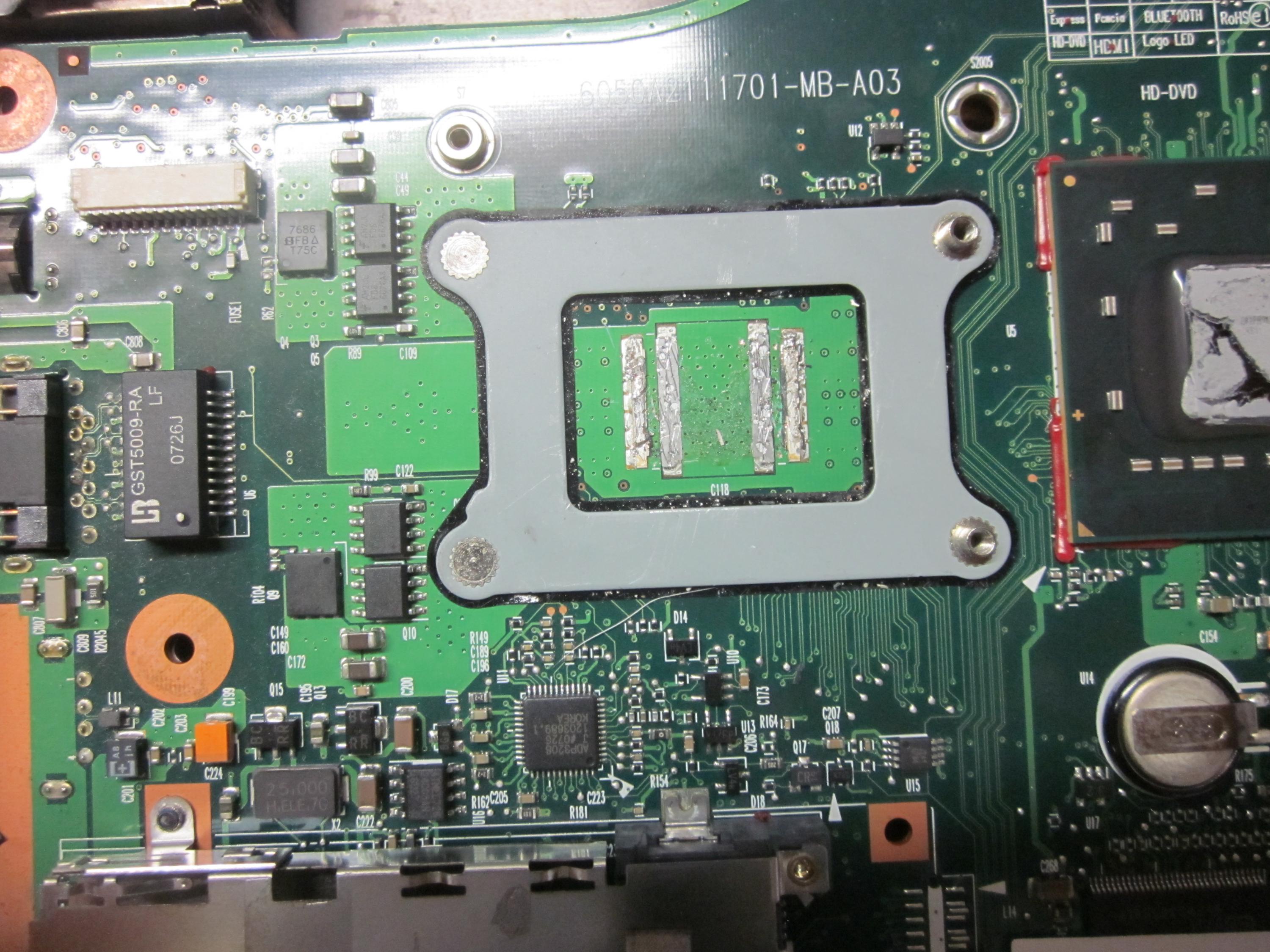

                                    Re: toshiba A200 la3481p
                                    I have fixed about 6 Toshiba a200 laptops. All of them needed the nec/token oem128 replaced. As it dies it causes problems like losing power for no reason, losing power when you are running off the battery then plug the charger in and other variations of that.
                                    Here is a link to a youtube video of the best way I have seen to remove the chip https://www.youtube.com/watch?v=cJRLOw0-NsY
                                    I replaced it with 4 of these
                                    http://au.rs-online.com/web/p/tantal...372D3238333226
                                    I have included some before and after pics. Note the 4 caps don't fit so you can try and angle them like I did or you could try doing it dead bug soldering style.
                                    Other people smarter than me worked this all out and I think a lot of the info I got from Bad Caps.
                                    Hope this helps
                                      That is with Toshiba A300/L300/L300D not A200, and it's a well known issue. Different laptop, different problem here.
