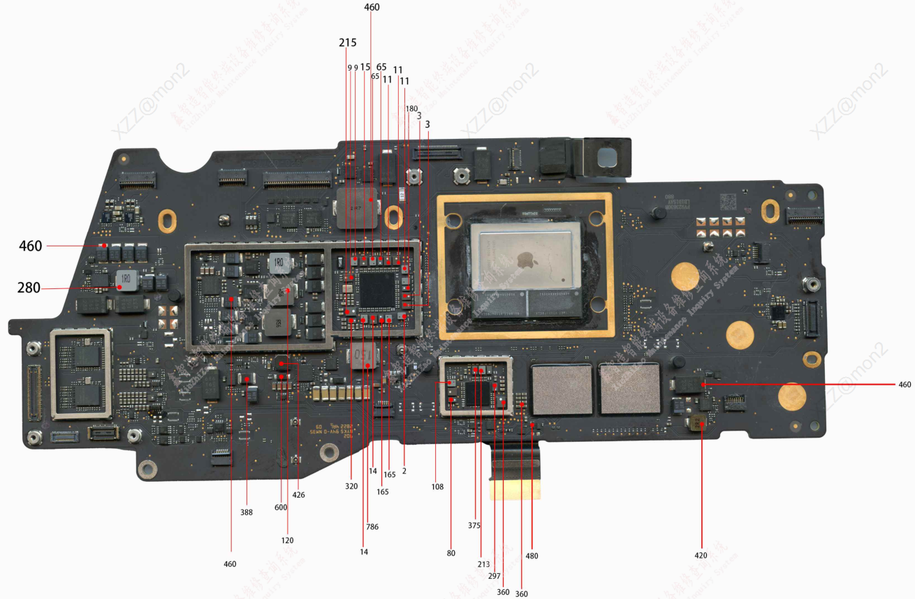

    Hello, can you help me solve this problem: I have a macbook pro A2338 which does not start, motherboard 829-02773-A, no oxidation, the usbc is stuck at 5v it does not trigger the 20v, here are the measurements:
    PPBUS_AON varied 11V70 12V5
    PPVBUS_USBC1 5V
    PP5V_S2_UPC 0V (1mégaohms)
    PP3V3_UPC1_LD0 3V45
    PP1V5_UPCA_LDO_CORE 1V5
    PP3V3_S2 0V
    PP1V8_AON 0V
    PP3V8_AON 0V 1ohm short
    I injected 2v I have 5a but I can't find any heating on the motherboard, I tried in several places of the short but still the same.
    Do you have any idea please? Thank you.

    I isolated L5800 L5820 L5840 and LR502 / l503 I have the short on the pin 2 side of the coils, I put myself on C5892 but I have nothing heating on the motherboard yet I have 5A under 2v

      I removed U5700 I still have the short and even more amperage but no heating

        Check the diode values.
        Remove all power. Red meter probe to ground.
        Black meter probe to the point under test.

          Hello, I just tested and compared, all the measurements in diode mode are exactly identical
          • mon2
            • Dec 2019
            • 14575
            Test with a known good battery. Some units will not boot unless there is a battery with a pre-charge.

              but I really have a short circuit on PP3V8_AON
