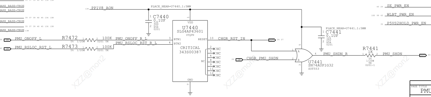

              Test the voltages on U7440 (Silego component).
              Is there PP1V8_AON on U7440, pin #1 ?
              Does PMU_ONOFF_L pulse when the ON/OFF button pads are shorted? Then confirm the same for PMU_ONOFF_R_L.
              The output of CHGR_RST_IN (pin 10 on U7440) should also pulse with this activity. Follow the pulsing to the output of PMU_SHDN signal.
              To me, this is the ON/OFF logic board signal path.

                hi , i already investigate U7440 .
                i have changed the component.
                here measurement:
                PP1V8_AON = 1.8V
                PMU_ONOFF_L : 1.8 v and pulse at power ON/OFF
                PMU_ONOFF_R_L​ : 1.8v and pulse during off
                CHGR_RST_IN = 0V and no pulse.
                PMU_SHDN​ = 0V and no pulse.
                i will resolder u7440
