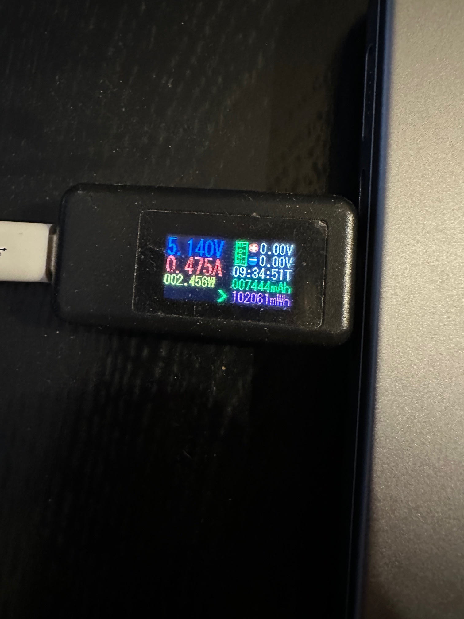

    Hi everyone,
    I have a MacBook Pro M1 14” (board 820-02098) with a broken LCD panel (matrix damaged).
    The board does not power on — when connected to power it draws about 5.1 V / 0.474 A (~2.45 W) and stays at that level, with no fan spin or display activity.
    Using a thermal camera, I noticed that U2020 heats up to over 70 °C shortly after connecting power.

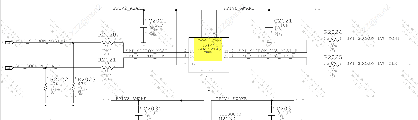

    According to the schematic, U2020 is a SN74AVC2T45RSWR (Texas Instruments) 2-bit bidirectional level shifter.

    U2020 should not be so toasty.
    Measure the voltage to ground for the power rails:
    PP1V2_AWAKE
    PP1V8_AWAKE
    Suggest to flux, remove and replace this part with a fresh one if the power rails are at normal values. Not suspecting the series resistors to be an issue but you can inspect them to be safe.
