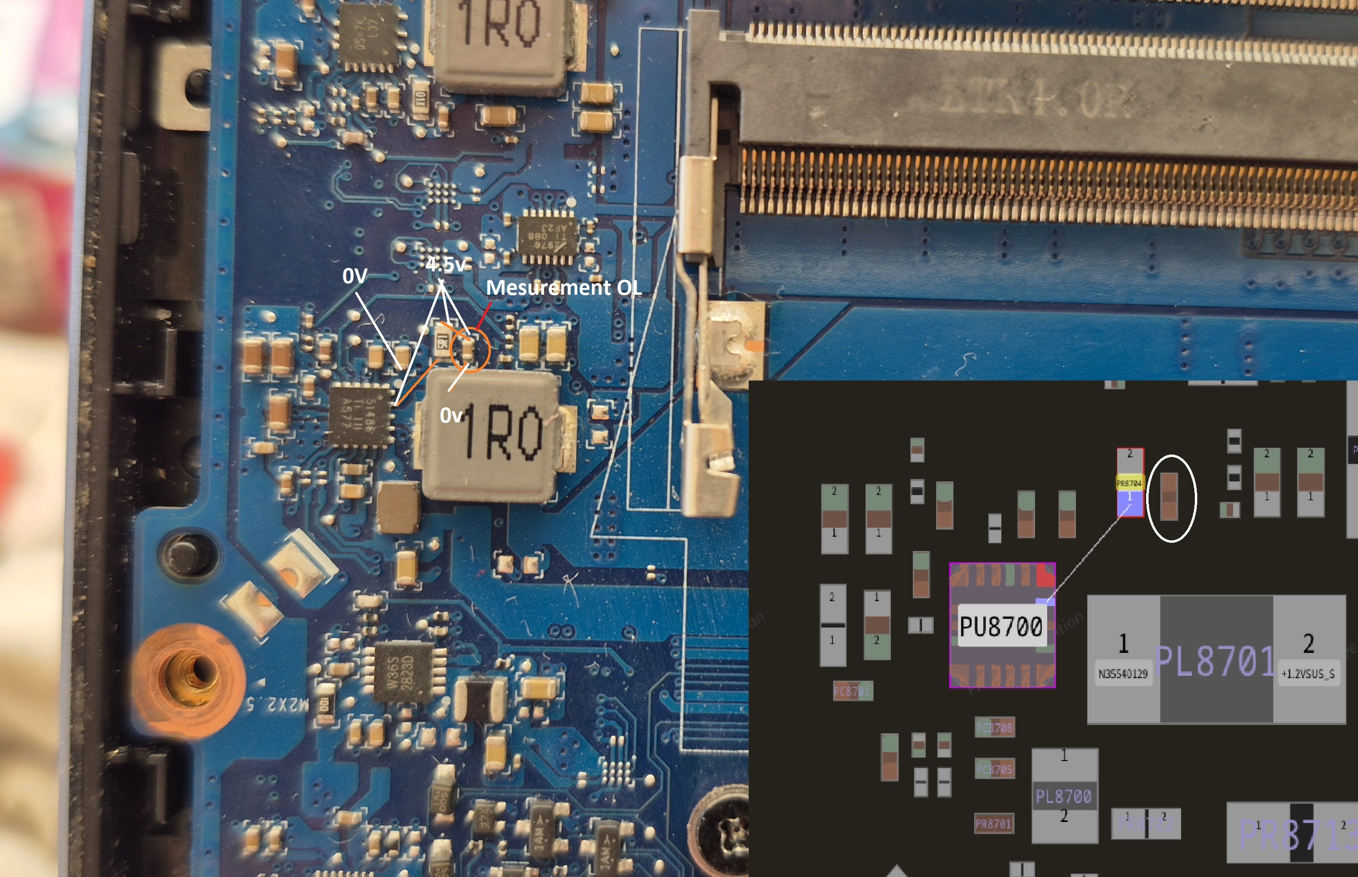

    Hello, I have an HP 15-eh0001nf with a start issue,
    • First it didnt start at all power button blinking blue and no screen, but seems a boot loop*
    • I tried to remove most component - > same issueI see some little corroded component, clean them with isopropyle alcool and resamble all -> it worked during less than one minute and did the same issueI
    • tried to clean it again and worked few second and get same issue...
    • Now dont want to start anymoreI see on thermal cam a component getting a bit hot (qr=7j 13g) and didnt find any information about it (, i tested all rail and no short..µ
      I feel like there is not enought voltage to boot up, how can i check that?
      Did somone have any clue?

    Some test of the motherboard ref dag7hamb8f0 rev f

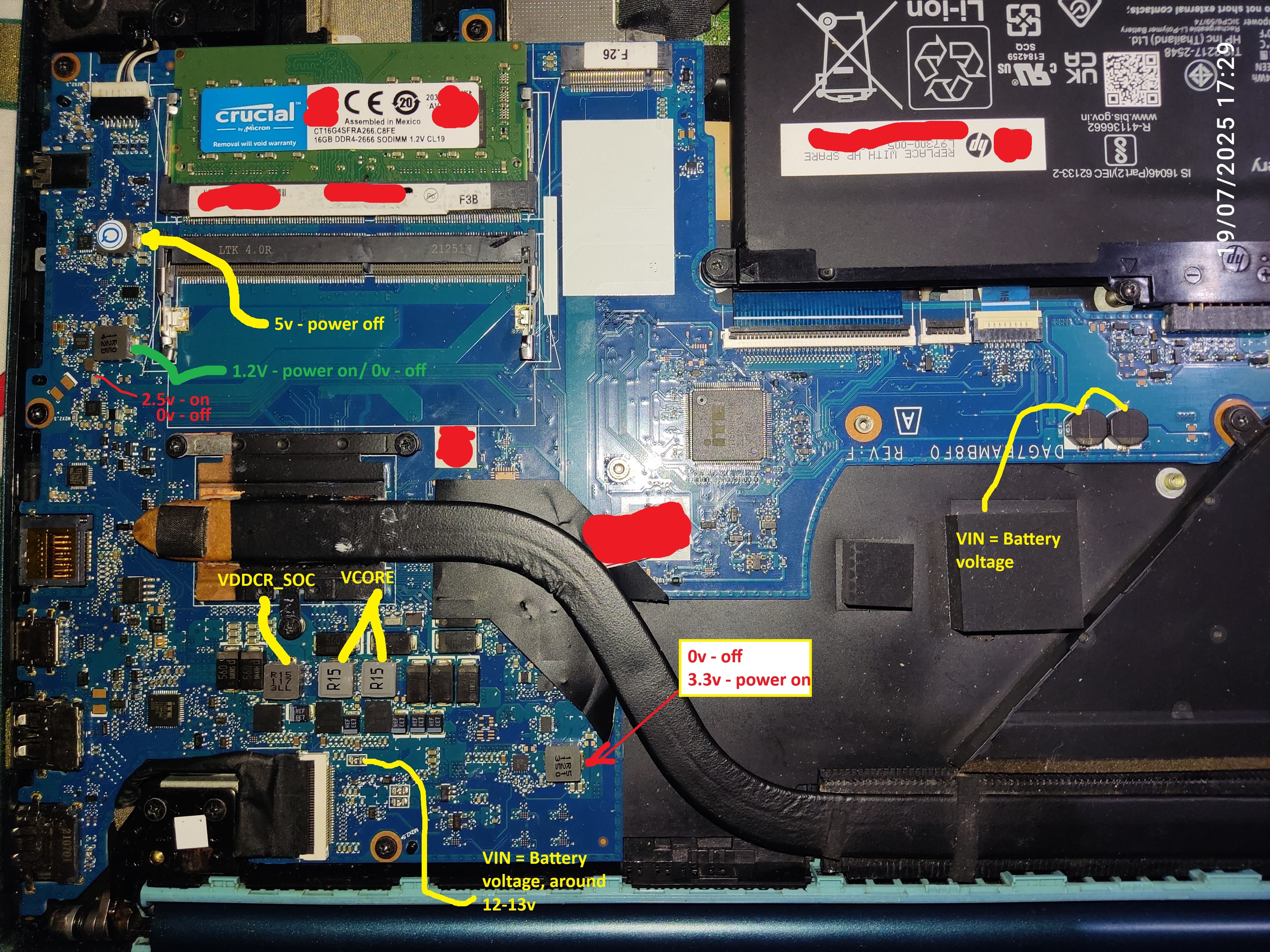

              I made a picture with the voltages i measured in my "mostly working" board, it actually powers on and boots to the OS, has other issues I detailed on another thread
              The boardview will help, use FlexBV Free to open it https://pldaniels.com/flexbv5/
              The IC that heats up in your board is the 3.3V regulator, its an RT6316B, PU8600
              With power removed, measure resistance to GND at PL8600
              And also check resistance to GND at pin 11, or at PC8615

                Beacause my 1.2v rail is missing at the PL8701
                The P8700 is getting out 4.5v from the 18 pin to a resistor and to a capacitor, but i lost the voltage at the pin out of the capacitor,i think its the guilty about the 1.2v rail missing!
                Can you mesure the output of this cap?
                Do you think i'm good?

                  I mesure the P8707 capacitor i think the issue came from but the reading looks fine...
                  Why i lost the voltage at the output of the capacitor ? too low voltage input ?
                  I have 360 Ohm between GND and Pin 1 of PL8701, do you have the same?

                      The 5v rail is always Good
                      The 1.2v and 2.5v are never present even when power is pressed
                      The 3.3v is present when power is pressed
                      I saw the 1.2v and 3.3v are related to the PU8700 (TPS51486RJER), i saw yours getting burnt in another post, perhaps mine is faulty aswell...
                      Can you give the reading you get on the Pin 18 and 17 of the PU8700 ?

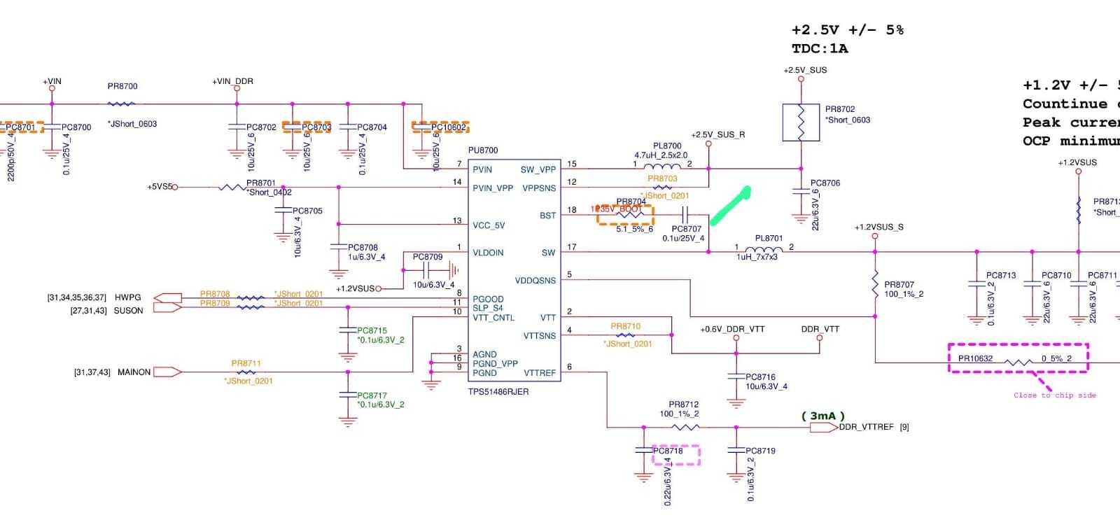

                              I found this datasheet which is close (or remplacement) of the TPS51486RJER https://www.ti.com/lit/ds/symlink/tp...=1752948926070
                              I think i understand something
                              The pin18 (BST) sending Voltage (by resistor and capacitor) to the pin17 (SW) to command it to get on
                              In my case i have the 4.5V getting out the pin18 get stuck on the output of the capacitor PC8707 and didnt go to the pin17
                              This can explain the TPS51486RJER didnt get the 1.2V and 2.4V out

                                Pin 7 is VIN, I get 13.23V, measured elsewhere as my probes aren't fine enough, don't want to short anything
                                It's the voltage from the battery/main power rail, the charge circuit is NVDC in this laptop, you won't find 19v anywhere except the input of the charge circuit,so the 13V on the main rail with only the AC adapter is plugged in is correct
                                13-14 is the same 5V
                                Pin 17 is before the inductor, should be 1.2v when power on (i measured at the output)
                                At PR8704-PC8707 i get 4.7V with power off, may be because PU8700 is a different part
                                My "working" board has a G6020AMC1D (marking 6020A) chip instead​, the dead board had a TPS51486
                                SW is the "switching" output before the inductor, the resistor and cap are used for a bootstrap to drive the internal MOSFETs of the chip
                                BST, 18, High-side MOSFET gate driver bootstrap voltage input for VDDQ buck. Connect a capacitor between the
                                BST pin and the SW pin.​

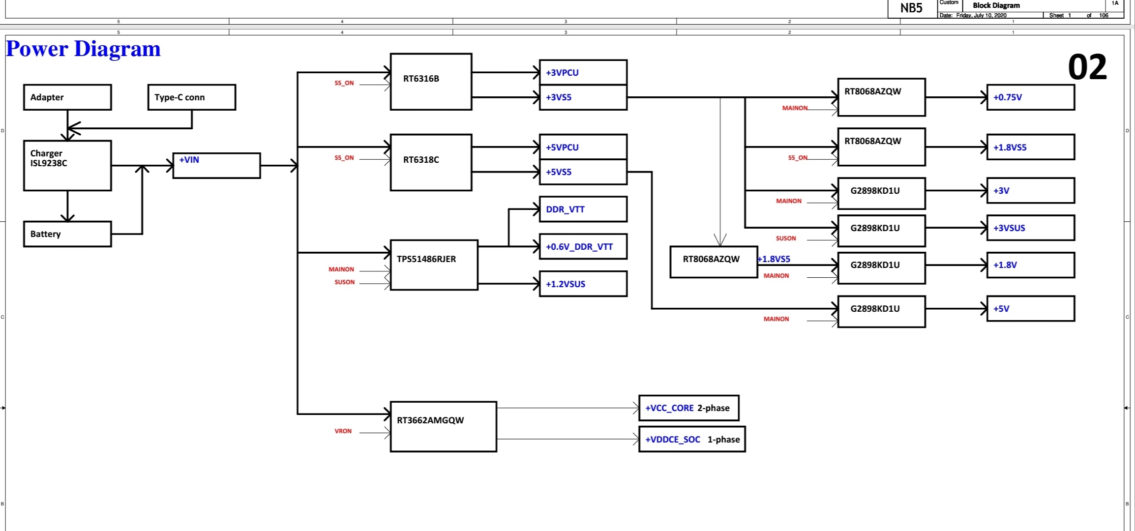

                                The enable signals to turn on the 1.2V, 2.5V and 0.6V are pins 10 and 11, SLP_S4 and VTT_CNTL
                                Check pins 10 and 11
                                Refer to the flow chart at page 2 of the schematics

                                    No, that capacitor is not connected to GND, think of a capacitor as 2 plates separated by a very thin gap
                                    A capacitor is not a wire, an inductor is a wire..., you don't get DC output after a capacitor
                                    At the input of PL8701, it's the same 1.2V (an inductor is a wire...)
                                    A better explanation of how a buck converter works: https://www.digikey.com/en/maker/tut...onverters-work
                                    It's a synchronous buck converter, with 2 MOSFETs, the capacitor has nothing to do with the missing 1.2V output
                                    The BST pin is for internal use of the TPS51486
                                    The readings you got at pin 10 and 11 are wrong, i get 83.7Kohm at pin 10 (measured at pin 1 of PC8717, it's not present on the board but the solder pads are there), and 85.2Kohm at pin 11 (measured at pin 1 of PC8716, also not present on the board), the readings are at alternate points as i couldn't get my probes on the chip itself
                                    PR8709 and PR8711 are just traces on the board
                                    Something is pulling down those lines, maybe the TPS51486 or another chip is shorted
                                    From the schematics SUSON goes to the EC IT5570, PU9600 and PU8700
                                    MAINON goes to the EC, to PU9601 and PU8700
                                    I don't think PU9200 is shorted, as MAINON goes through a 10k resistor to the enable pin
                                    Originally posted by alloverme
                                    Do you have a clue of the issue?
                                    I thinking to order a TPS51486RJER and a 0.1 Ohm resistor (PC8707)...
                                    PC8707 is a capacitor, not a resistor...
                                    • alloverme
                                      • May 2021
                                      • 21
                                      • France
                                      Thanks for your explanation, i'm a bit lost of understanding all of that sorry...
                                      PR8709 and PR8711 are just traces on the board​
                                      I have remade the mesurement at the same point and i have around 91.6 KOhm at pin 10 and 96.9 KOhm at pin 11. I think i've done it previously with the power plug.
                                      So it looks close to your mesurement...
                                      Do you think the TPS51486 is just dead? i will order one but it will be a challenge to change it with my hot air station...

                                        It could also be anything else, also check the HWPG line, it's the "power good" connected to several ICs, the EC receives the HWPG "power good" signal
                                        A missing voltage somewhere can cause a bootloop
                                        Check also 1.8V and 0.75V, there's 2 0.75V supplies, +0.75V and +0.75VS5, PU9200 and PU9201, the schematics says RT8068AZQW but the chip installed in both boards I have is a G2823D, may be pin compatible
                                        On my dead board one of those got shorted too
                                        Attached the power diagram from the schematics, it's slightly wrong as it's missing the second 0.75VS5 supply, and the 3.3V are not enabled on power off
